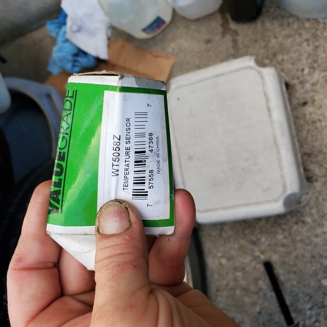

Well I'll send you a picture of the boxing. I don't know if that will help but there's numbers on it too. Since you say that it say It is a head cylinder temperature sensor. Can you send me the info on its location and if this is something requires to have this cooling system drained to replace I want to know so I can think about doing it now, so I'm and don't end up unit later. If I'm having overheating problems do you think it's a good idea for to change this it's same time? Also, I want to say I apologize I read my messages back the voice to text is not worth a darn sometimes I know I understand some of the messages might have been hard to understand. I wanted to apologize.

Read my latest response. It is a cooling fan sensor that sends a signal for the fans. It should be in the radiator somewhere.

Okay, um. What I want to know is a is this a sensor that when replacing does cooling system in to be drained and I have a overheating problems then is it probably good idea that I change it?
Monday, July 20th, 2020 AT 6:40 PM
TAUSHACOOKSEY
  • 22 POSTS
Okay, I just in your last message I did not see that before I sent my last one. I guess that someone for my cooling fans then I guess it's my cooling fans are working then and this can go on him just keep it around if it ever goes out I have one to replace it. Thanks
Monday, July 20th, 2020 AT 6:42 PM
  • 52,797 POSTS
Correct. I would change it now. Check and see if you have this sensor.
TAUSHACOOKSEY
  • 22 POSTS
Let me Try that message again. I guess if my cooling fans are working I can save it for another day.
Monday, July 20th, 2020 AT 6:44 PM
  • 52,797 POSTS
That is correct. Do not fix it if it is not broken.

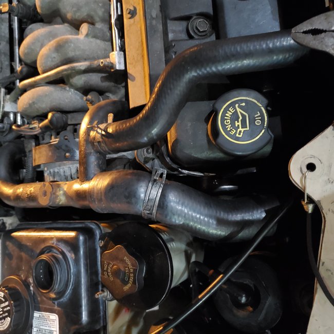

Okay, I think I'm getting a little confused just when I think I understand then I get unsure. So which on is bypass? Because I'm and had go ahead flushed with water before but my coolant back in.
Monday, July 20th, 2020 AT 8:25 PM
  • 52,797 POSTS
What is in the picture that I am looking for?
What are you confused about?

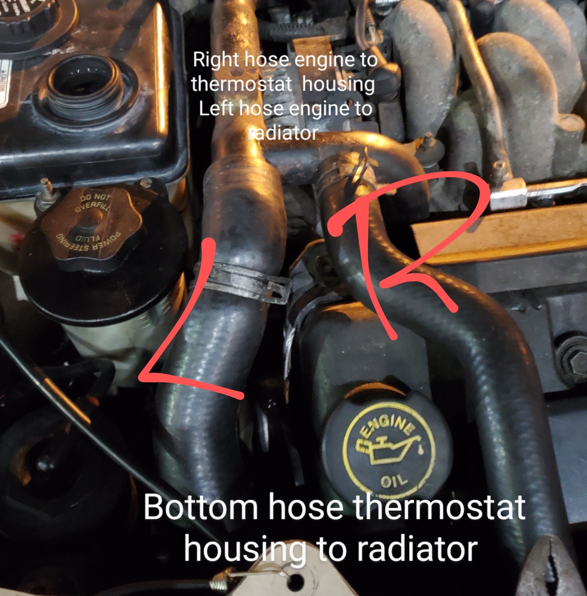

I'm asking which hose is bypass hose to flush and fill entire cooling system?
Tuesday, July 21st, 2020 AT 5:11 AM
  • 52,797 POSTS
Neither hose is the bypass hose.One is the upper hose and one is the lower hose.
What you need to do is drain the system and fill with water. Then add your flushing agent and run the engine until the thermostat opens. Then drain the system while it is hot to get all the water out. You may have to do this several times if the water is rusty to get all the rust out.

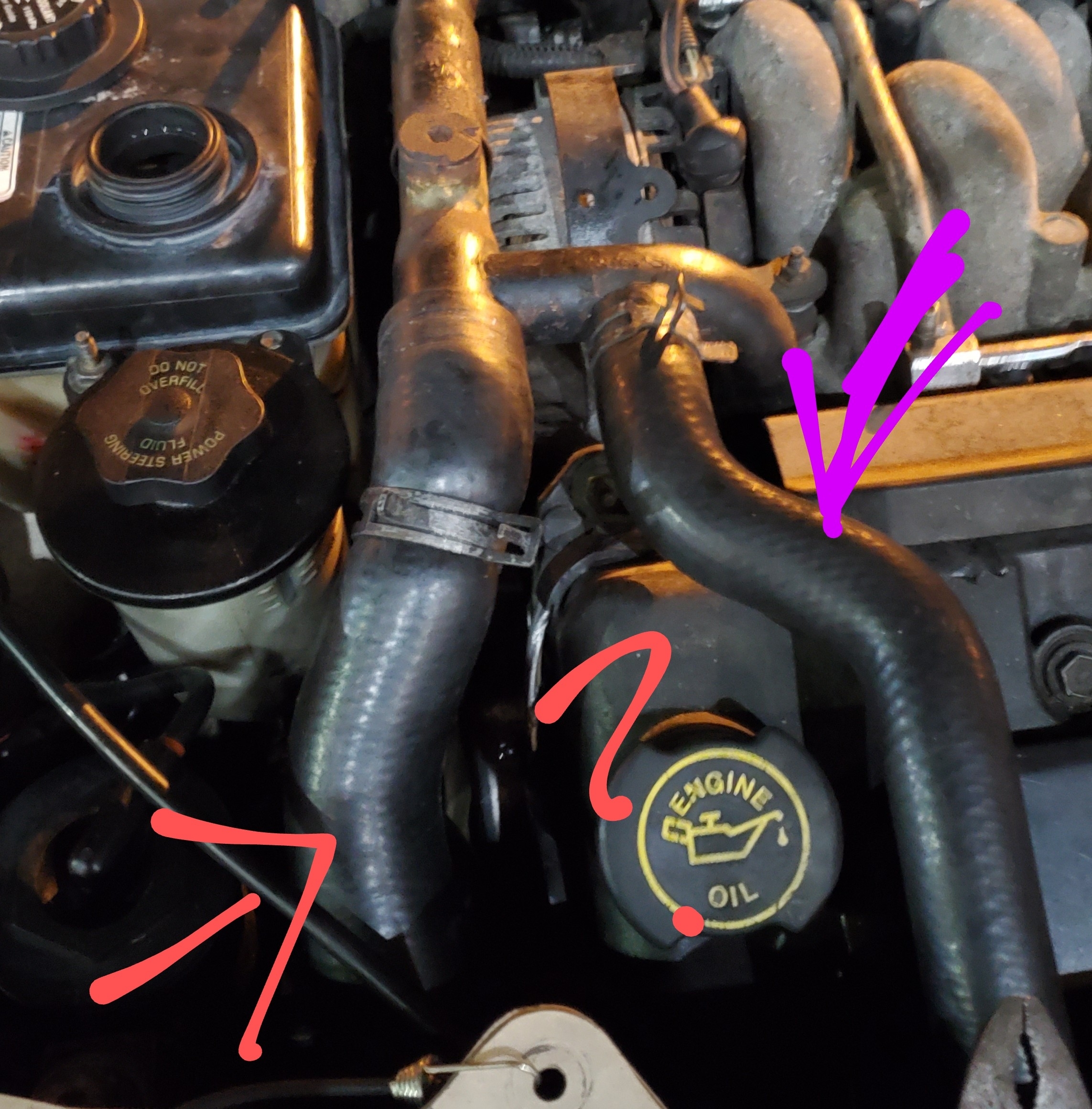

You are incorrect in your answer because I have two upper hoses I have one lower hose. I have 4.6 engines v8 and 1998 Lincoln Continental. My lower radiator hose that go from my radiator to up to the housing of the thermostat housing and there is another hose that Connect to the top of that thermostat housing there to the engine block and then I have another hose to go from the and engine block into the radiator.
Tuesday, July 21st, 2020 AT 6:41 AM
  • 52,797 POSTS
The one on the right is the bypass that goes to the bypass housing.
I stand corrected on that one.
Why do you want to remove it? You do not need to remove it to flush it?
Tuesday, July 21st, 2020 AT 6:52 AM

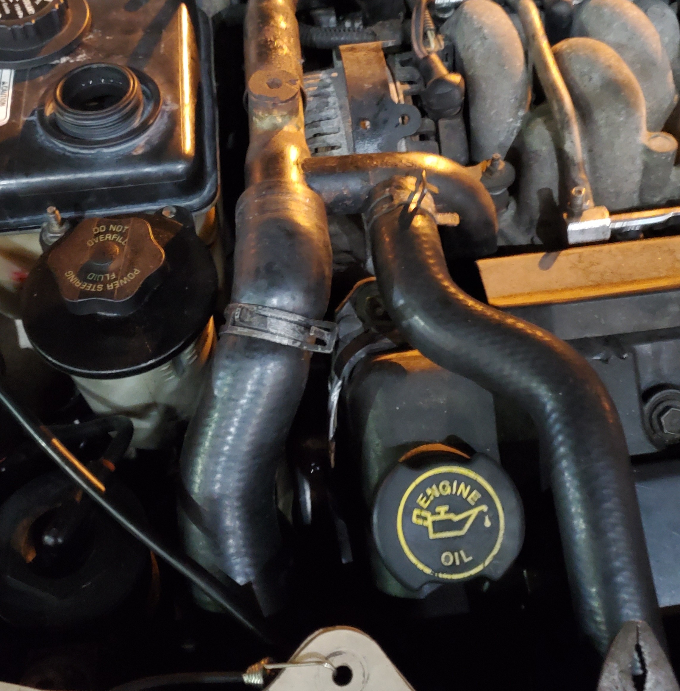

This is my problem: it's overheating because I did not completely fill up the system the 1st time because I only filled it through the overflow container. Now I need it fill it also through the hose to fill. Its a complete system but I need to a flush the system because it's got rusty from all this time I take it to work on it and I need to flush the rust out before a put my coolant back in. So can you instruct me on how to do that?

This guide can help you drain and flush the cooling system. To refill the system you may need to remove one side of the upper radiator hose to fill.
