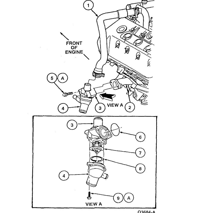

I recently installed a new radiator. However the car is overheating and it seems that the water is not circulating. Maybe the thermostat is sticking, and I need to locate the thermostat. If necessary should I change the thermostat. The car was bought in Canada and may have differences with the US models.
Why else should the car overheat.
I did bleed the system.
Wednesday, April 16th, 2008 AT 4:02 PM
19 Replies
BLACKOP555
  • 10,371 POSTS
The thermostat on this engine is located at the lower hose, not the upper like some vehicles
replace it, cheap part. After that to check the water pump, wait for the engine to be hot and then hold the upper radiator hose, if pressure builds up and you feel and hear water rush past it it is good.
See the diagrams below for location of the thermostat

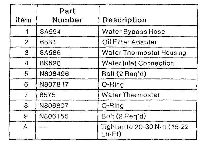

WRENCHTECH
  • 20,761 POSTS
It's inside the housing shown in the picture.
Monday, November 5th, 2018 AT 5:50 PM (Merged)

HARDTIME72
It's not in there it's on the front of the engine behind and slightly above the A/C compressor on the front of the engine where the bottom hose goes to the engine
+1
WRENCHTECH
  • 20,761 POSTS
And that's exactly what the original picture is showing.

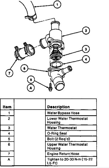

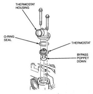

KNOWYOURAUTO
  • 113 POSTS
I found this prior posting from 2carpros master tech rasmataz:
"Near the alternator up front of the engine it really always help to look at the new part before you install helps to locate it. From the driver's side at the bottom of the radiator the hose runs across to the passenger side of the car. it turns up into a housing with a secondary smaller hose coming out the side of the housing. If you remove the 2 bolts holding this housing together you will find the thermostat inside with an O ring seal that has to be replaced in the right position when you reinstall the new thermostat."
And I am also adding this picture:
https://www.2carpros.com/forum/automotive_pictures/435113_Thermostat461997Lincoln_1.jpg

  • 75,992 POSTS
Try checking below
near the alternator up front of the engine it really always help to look at the new part before you install helps to locate it.
From the driver's side at the bottom of the radiator the hose runs across to the passenger side of the car. It turns up into a housing with a secondary smaller hose coming out the side of the housing. If you remove the 2 bolts holding this housing together you will find the thermostat inside with an O ring seal that has to be replaced in the right position when you reinstall the new thermostat.

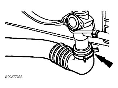

BLUELIGHTNIN6
  • 16,542 POSTS
When you stand in front of your car you see the radiator, on the right hand side you see that big black hose that is connected to the radiator and then goes to the engine and the end has that hose clamp, take of the 2 bolts and your thermostat is there, just be sure to drain you antifreeze first and take off the hose clamp.

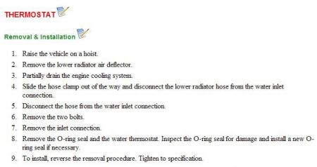

BMRFIXIT
  • 19,053 POSTS
Removal & Installation
1.Raise the vehicle on a hoist.
2.Remove the lower radiator air deflector.
3.Partially drain the engine cooling system.
4.Slide the hose clamp out of the way and disconnect the lower radiator hose from the water inlet connection.
5.Disconnect the hose from the water inlet connection.
6.Remove the two bolts.
7.Remove the inlet connection.
8.Remove the O-ring seal and the water thermostat. Inspect the O-ring seal for damage and install a new O-ring seal if necessary.
9.To install, reverse the removal procedure. Tighten to specification
good luck
need manual CHECK IT @
https://www.2carpros.com/kpages/auto_repair_manuals.htm

BDCHHOLZ
  • 1998 LINCOLN CONTINENTAL
  • V8
  • FWD
  • 165,000 MILES
Diagram and instructions for replacement of thermostat
Monday, November 5th, 2018 AT 5:51 PM (Merged)
BLUELIGHTNIN6
  • 16,542 POSTS
https://www.2carpros.com/forum/automotive_pictures/261618_Noname_585.jpg
https://www.2carpros.com/forum/automotive_pictures/261618_Graphic_52.jpg
