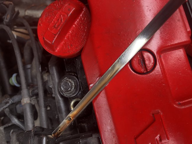

Well, unfortunately I think the inevitable happened out of nowhere. You might’ve called the head gasket from the beginning. This morning I decided to check my coolant and it was slightly filmy. Check my oil and there was a line of milk going down (try to see in the picture). Still no smoke from exhaust or anything, I’m assuming we just caught it very early.
Monday, April 18th, 2022 AT 1:51 PM
  • 109,885 POSTS
It's a bit difficult to tell from the pic, but if there is coolant mixing with the oil, in most cases it is a head gasket.
I don't know when you are due for an oil change, but when you drain it, pay attention to see if there is more evidence.
Let me know what I can do to help.
