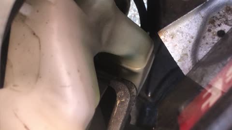

Hi, the thermostat is about a year old, as well as tb/wp. Recently my coolant reservoir has been overflowing and bubbling slightly. Any ideas? thanks

No, there is no overheating happening at all, which concerns me. I even did a leak test with that liquid two times and it was fine. I noticed the bubbles when I turned off the car, but only in the reservoir, not the radiator. Then when I had the car idling, I pressed the gas and saw it bubble again.

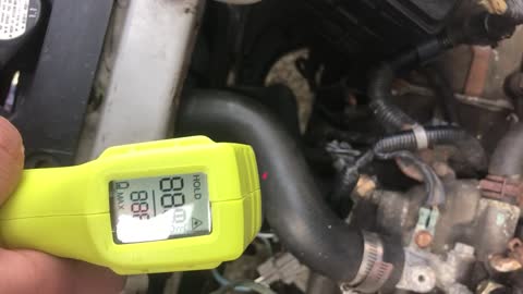

What I would do is get your hands on an infrared thermometer and see what the temperature is in the overflow. Do the same at the radiator. I'm questioning if the vehicle may be overheating, and the gauge may be inaccurate.

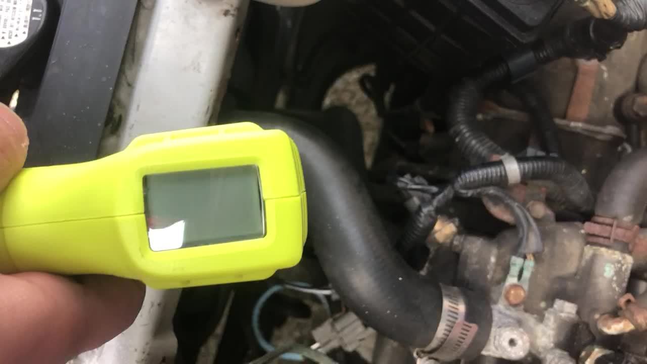

update: I see it starting to rise again. when i checked hoses, they read in the 160-170s (i bought the thermometer). Clog in the system? Thank you for everything.

Most vehicles come with a thermostat that fully opens at 195 F. Your readings, which should be cooler when coolant returns to the engine, should be cooler, so what you indicated seems normal. If you check the radiator tanks themselves, what is the temperature? Also, how high did the gauge go again?

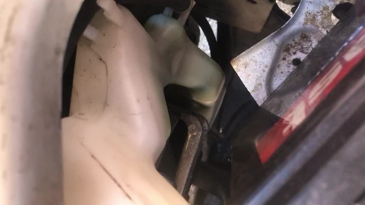

As you can see temperatures are normal, I caught the overflow rising back up again and a slightly bubbly when I pulled the throttle.

The temperature at the top hose is perfect. The thermostat fully opens at 195F. I can't see what the temperature is on the bottom hose. Can you let me know what it is?

No, the temperatures for everything was fine. I meant to say the coolant in the reservoir was higher again. I don’t know if you saw it in the video well.

I'm sorry but I couldn't really tell what it was doing in the video. When you say the coolant in the reservoir was higher, how high was it?

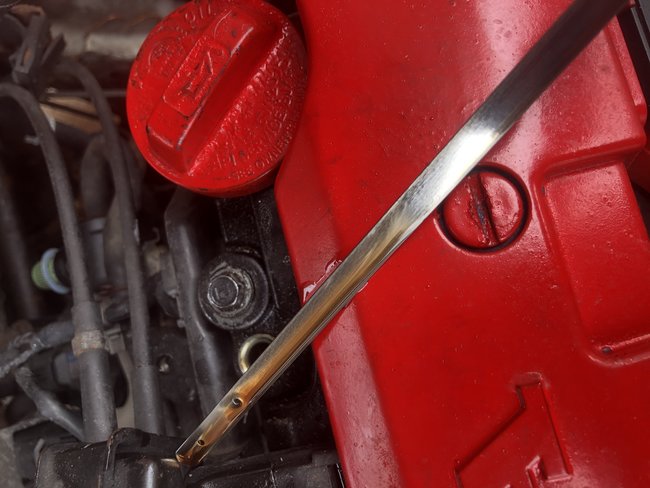

Well, unfortunately I think the inevitable happened out of nowhere. You might’ve called the head gasket from the beginning. This morning I decided to check my coolant and it was slightly filmy. Check my oil and there was a line of milk going down (try to see in the picture). Still no smoke from exhaust or anything, I’m assuming we just caught it very early.

It's a bit difficult to tell from the pic, but if there is coolant mixing with the oil, in most cases it is a head gasket.
I don't know when you are due for an oil change, but when you drain it, pay attention to see if there is more evidence.
Let me know what I can do to help.
