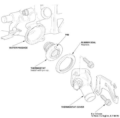

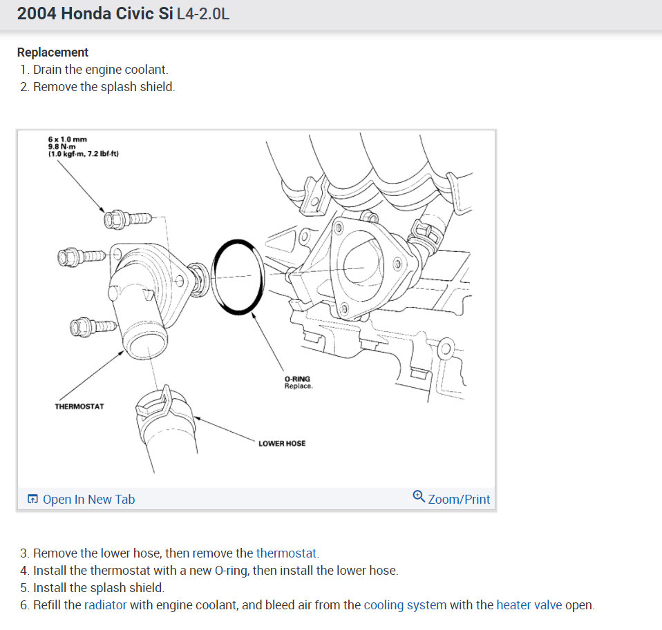

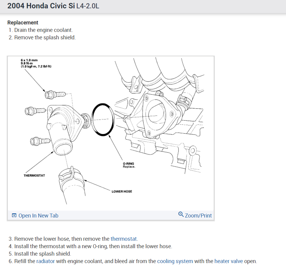

We have a 2004 Honda Civic SI and we would like to know the location of the thermostat, as well as removal and installation process, as well we need to know what type of coolant and how much to put back in. How do we bleed the air out of the line after or when were we're done.

Here is a guide to help you step by step with instructions in the diagrams below to show you how on your car.

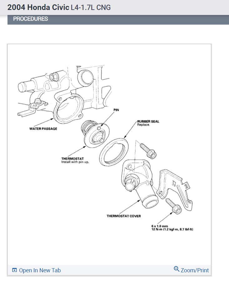

I’m having a issue still with it overheating. Had a new radiator put in and hoses. Had belts changed, fans work, no leaks anywhere, no issues with water pump. Haven’t check the thermostat not sure if this could be issue. Any ideas?
Friday, December 25th, 2020 AT 9:22 AM (Merged)
MASTERWRENCH
  • 258 POSTS
The thermostat is definitely a good next step. Stuck thermostats are not uncommon. Attached is a diagram to use for reference when replacing. Check out the diagrams (Below). Please let us know if you need anything else to get the problem fixed.

Can I replaced the Thermostat from the bottom or do I need to take the Intake off to get to it?
F4I_GUY
  • 3,302 POSTS
The thermostat is at the front of the vehicle. You access it from the top.
+2
KANELEATHERS
I completed the job already and I did go from the bottom. Its hidden behind the intake manifold.

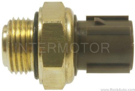

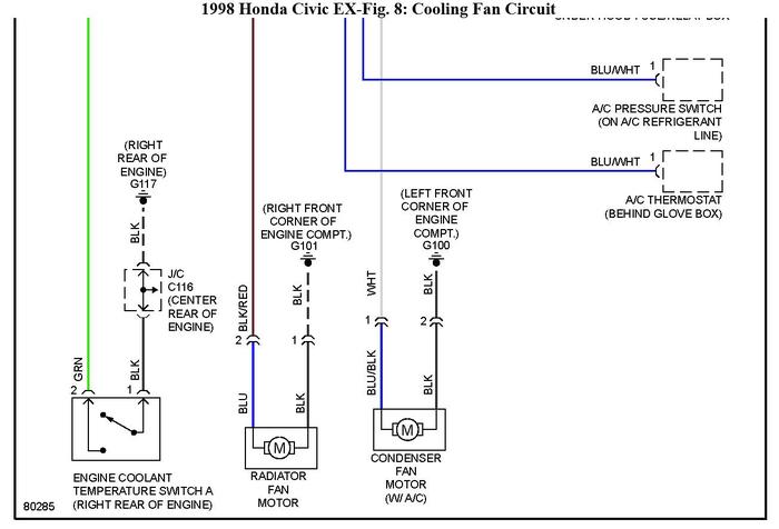

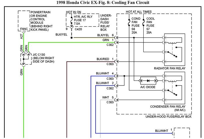

Ive been having an on going problem with the temp guage on this car. Im just driving in the city and the problem has been getting worse the last few months. Today the guage was going up at a light then when I take off go down a little and when I parked the radiator fan wasnt even on. Today when I got home the guage was like around 3 quarters high and the radiator fan was on and stayed on and the guage stayed the same. Coolant is full and new radiator. No leaks, funny smells or smoke. My neibor said its a fan switch. What do you think
That's my problem, should I just change the thermostat the one thats in there now is a stant 195 which some people tell me is too high. Should I get a 172. Im in florida if that helps. I was gonna get a napa thermostat thats made by altrom.

The first things is to connect a scanner that displays live data so you can see what the Engine Computer sees. If coolant temperature is going beyond 212 degrees it should be turning the fan on which it sounds like it is doing. If coolant temperature is staying below 212 degrees but the gauge is rising, replace the temperature gauge sending unit.
Going to a lower thermostat is going to cause all kinds of other problems. The computer will never switch to "closed loop". Fuel mileage and emissions will suffer. That is not fixing the problem; that is fixing the symptom.

Yesterday the temperature guage was up like 3 quarters and the fan was on and wasnt going down it stayed the same.

But there was another time it was around 3 quarters high and the fan didnt come on. Its weird

Regardless where and what you find for a scanner, the first thing you need to do is see what the Engine Computer is seeing for coolant temperature when the gauge reads too high. If the temperature is normal, (220 degrees or below), the gauge is reading incorrectly, and based on the fact it's not pegged at full-scale, it's not likely to be a wiring problem. It's going to be a sensor. You have to be aware there should be two coolant temperature sensors. A single-wire sensor feeds the dash gauge, and a two-wire sensor is for the Engine Computer.
A quick test on most cars to see if the radiator fan is working is to unplug the two-wire coolant temperature sensor while the engine is running. That should cause the computer to "panic" and turn the fan on just in case the engine is overheating and it doesn't know it. It will set a fault code and turn on the Check Engine light, but that will go off later.
You can also get an idea if the engine really is running hot by feeling the air from the heater duct when the gauge is reading too hot. If it feels normal, (uncomfortably hot), suspect a gauge problem. If it feels rather cool(see note below), suspect a circulation problem. The really hot coolant isn't circulating to the radiator and heater core. That could be due to a thermostat not opening fully. I don't mean to sound the alarm bells, but in that case you might have a test done for combustion gases in the cooling system. Their presence is a sign of a leaking head gasket. If air gets into the cooling system it can prevent the thermostat from opening. They open in response to hot liquid, not hot air.
Note: Feeling the air temperature is somewhat subjective. What feels hot in summer in Florida can really be too cool. Up here is Wisconsin, I have a minivan that feels nice and hot in the summer but when you blow cold winter air through the heater it comes out cold. A better way to get an idea of coolant temperature is to hold onto a small heater hose when the engine is warmed up. At normal temperature it should be uncomfortable to hold onto for very long, but you should be able to. If you can't hold onto it for a good ten seconds, it's too hot.
If the air from the heater is really hot and burns your hand, suspect the gauge is right and the fan should be running. If the scanner shows a normal temperature, the fan won't be turned on although it should be. That is not a real common problem but it is possible to have a defective two-wire coolant temperature sensor. That's somewhat common on older Ford products but they usually caused the temperature to read too high intermittently, and the fan would turn on when it wasn't needed.

Im going to try a fan switch tomorrow. My neibor wa a mechanic at honda for 30 years he said thats the problem. So ill give it a try. He said go to honda to get one but its 60 bucks. Napa has a mileage plus for 20, an altrom for 37 and echlin for 41. Whats the difference of those 3 brands. Are these napa brands good. Im planning on keeping the car maybe till the end of the year im saving my money now. Also im debatting if I should get a manual. My friend is gonna teach me to drive manual.
