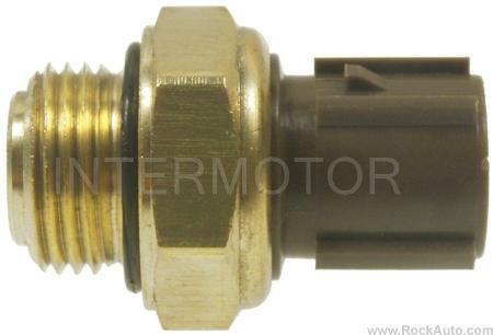

Ok. How hard is to change this? What tools will I need?
Friday, December 25th, 2020 AT 9:23 AM (Merged)
CARADIODOC
  • 33,879 POSTS
Wrench.
Here's a photo from rockauto. Com.
PMP
  • 177 POSTS
Ok I got the part today its not on yet. This is what I did. I unplugged the fan switch connector and no check engine light then I plugged it back in and the fan went on when I plugged it in. Does this mean the switch is bad? Also when the condensor fan is on the radioator fan isnt going on with it.
CARADIODOC
  • 33,879 POSTS
If that's just an on-off switch, chances are it's not monitored by the Engine Computer so it won't turn on the Check Engine light. It depends on whether the switch turns on the fan motor, or the switch signals the computer to turn on a relay to turn on the fan. Common sense vs. The way things are typically done with over-engineering.
If the part is a temperature sensor, it is going to provide a voltage signal to the computer. The computer will turn on the fan relay when a certain voltage is reached. That type of sensor is monitored, and when you unplug it, the computer won't know engine temperature so it will turn on the fan just in case the engine is overheating.
You didn't fix anything inside the sensor by unplugging it. The fact the fan turned on when you played with the plug suggests it wasn't making good contact, either due to corrosion on the terminals or a terminal is stretched. I'd look closer at that plug.

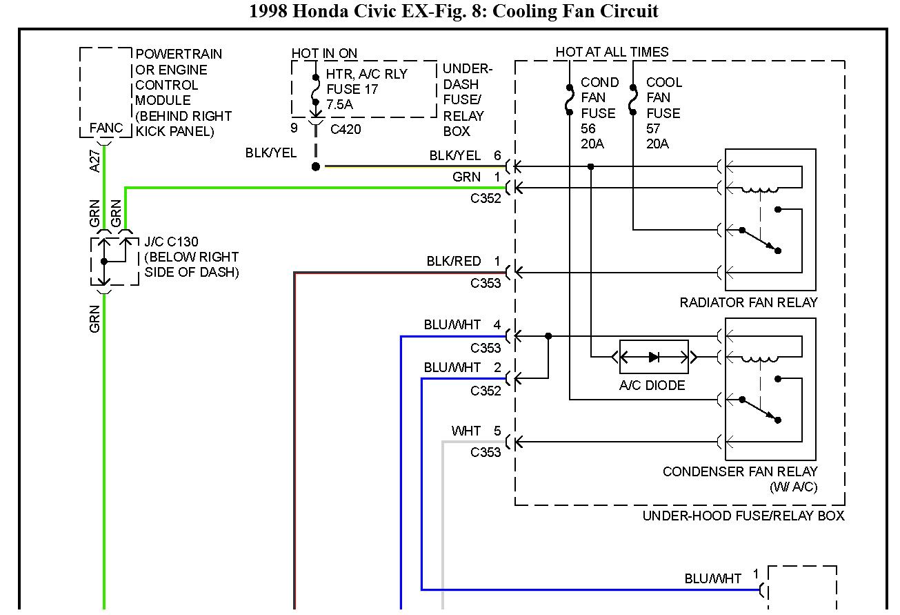

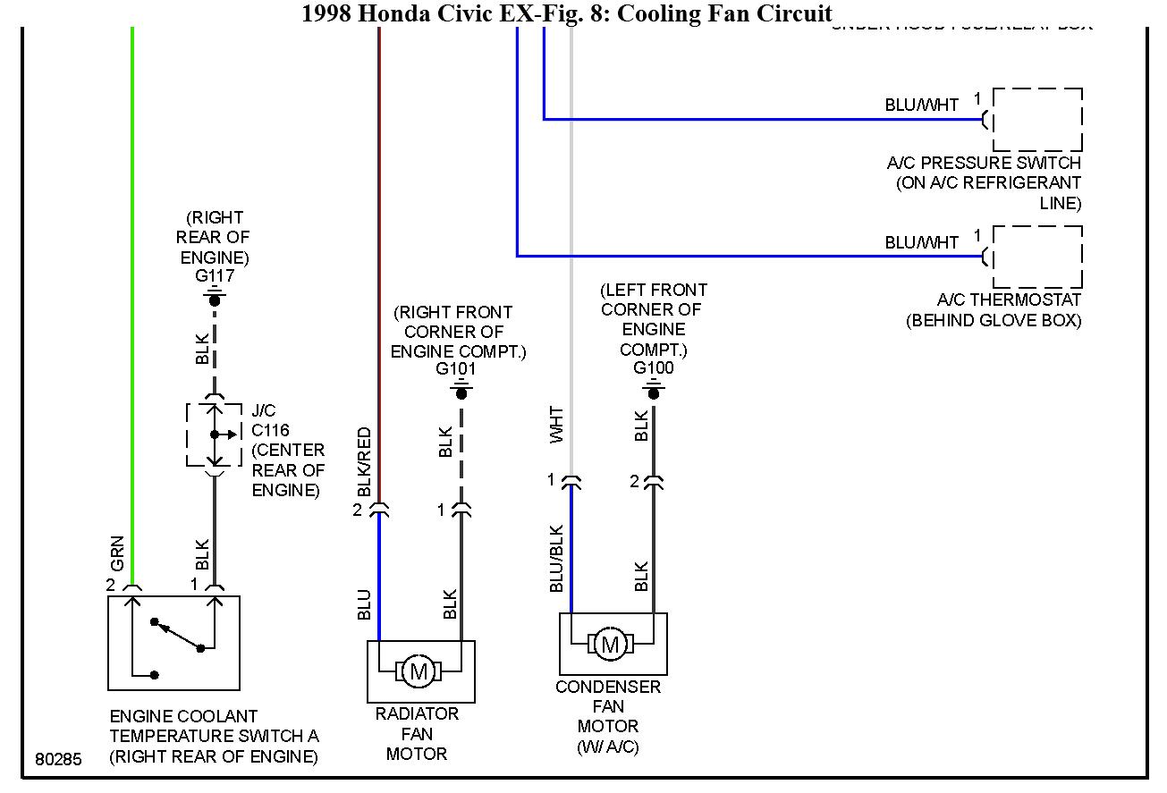

KHLOW2008
  • 41,814 POSTS
Here are the cooling fan schematics.
Unplug the fan switch connector and use a jumper across the terminals, does the radiator fan come on?
