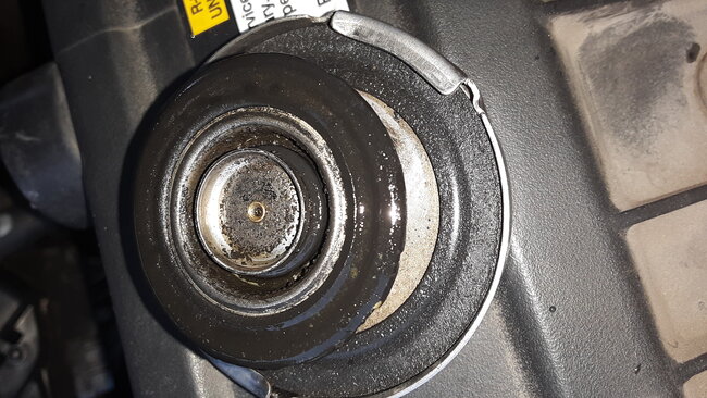

ALPHAA10
  • 234 POSTS
Ken, as of tomorrow, my replacement radiator cap (OEM) will be on its way to me. The photo attached shows a deteriorating rubber seal, and the filler neck is fairly dirty, so a brisk cleaning of the filler neck area and installation of the new radiator cap should indicate whether deeper problems await me.

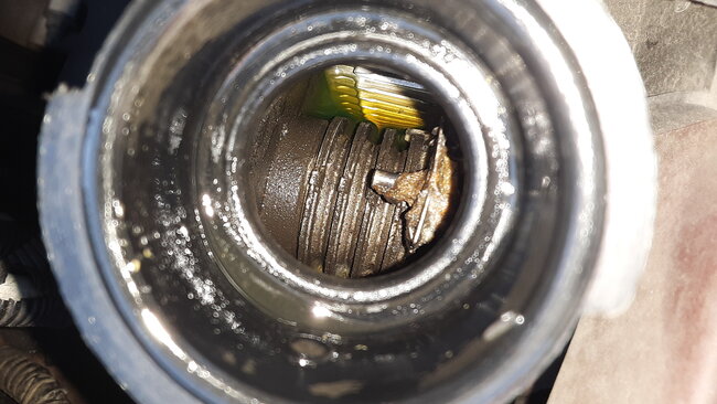

ALPHAA10
  • 234 POSTS
Yesterday, the 2CarPros server was having problems with my two photos. They were uploaded and displayed as attachments, but they had disappeared when I checked your latest response. My own (local) computer is RAM-challenged, so that surely was involved.
In any case, I have ordered a Gates safety radiator cap for this Buick 1998 LeSabre 3.8L, since the safety cap spares me the prospect of developing multiple new leaks while I wait for a hot system to cool down and de-pressurize.
Should all radiator coolant added to a running system be poured into the coolant reservoir, rather than directly through the radiator filler neck? I am not sure, but I always have poured new fluid directly into the radiator filler neck.
See attachments below.
May 13, 2024 at 2:19 PM
  • 55,433 POSTS
Thanks for the images. The radiator and cap look okay but I would do the cap anyway. Also, ways coolant directly to the radiator when the engine is running and then top off the coolant reservoir.
