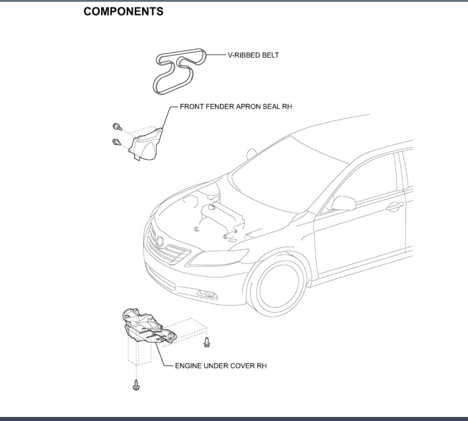

DRIVE BELT
COMPONENTS
REMOVAL
1. REMOVE FRONT WHEEL RH
2. REMOVE ENGINE UNDER COVER RH
3. REMOVE FRONT FENDER APRON SEAL RH

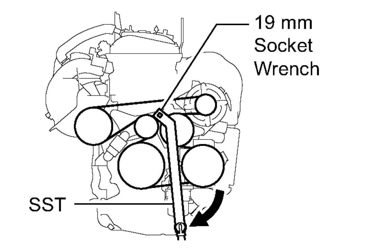

4. REMOVE V-RIBBED BELT
(a) Using SST and 19 mm socket wrench, loosen the V-ribbed belt tensioner arm clockwise, then remove the V-ribbed belt.
SST 09216-42010
NOTICE:
Be sure to connect SST and the tools so that they are in line during use.
When retracting the tensioner, turn it clockwise slowly for 3 seconds or more. Do not apply force rapidly.
After the tensioner is fully retracted, do not apply force any more than necessary.

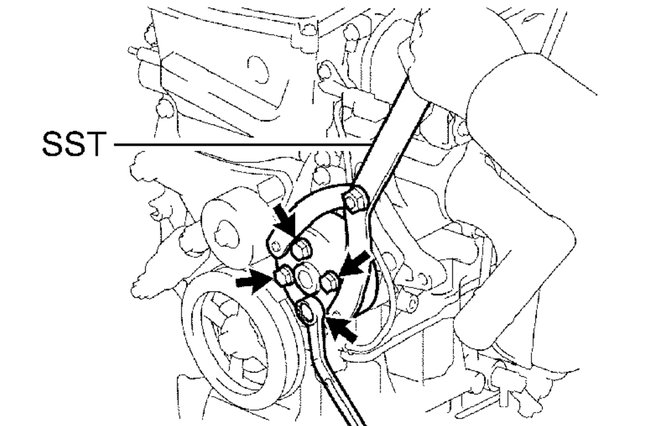

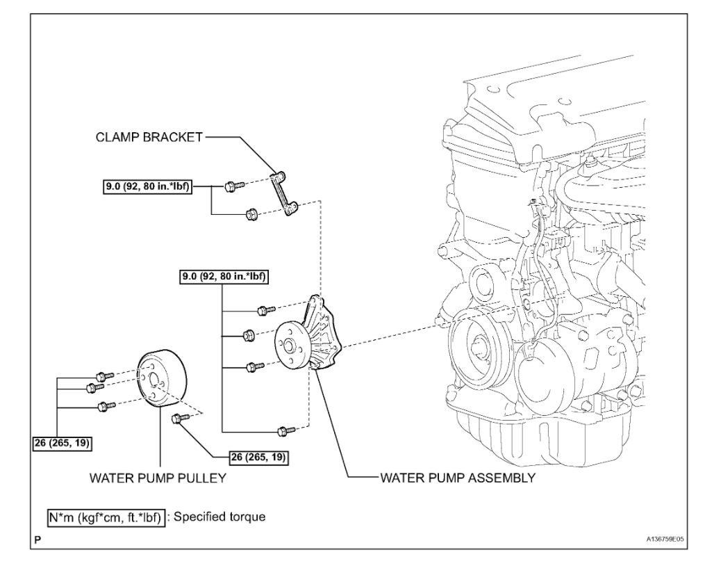

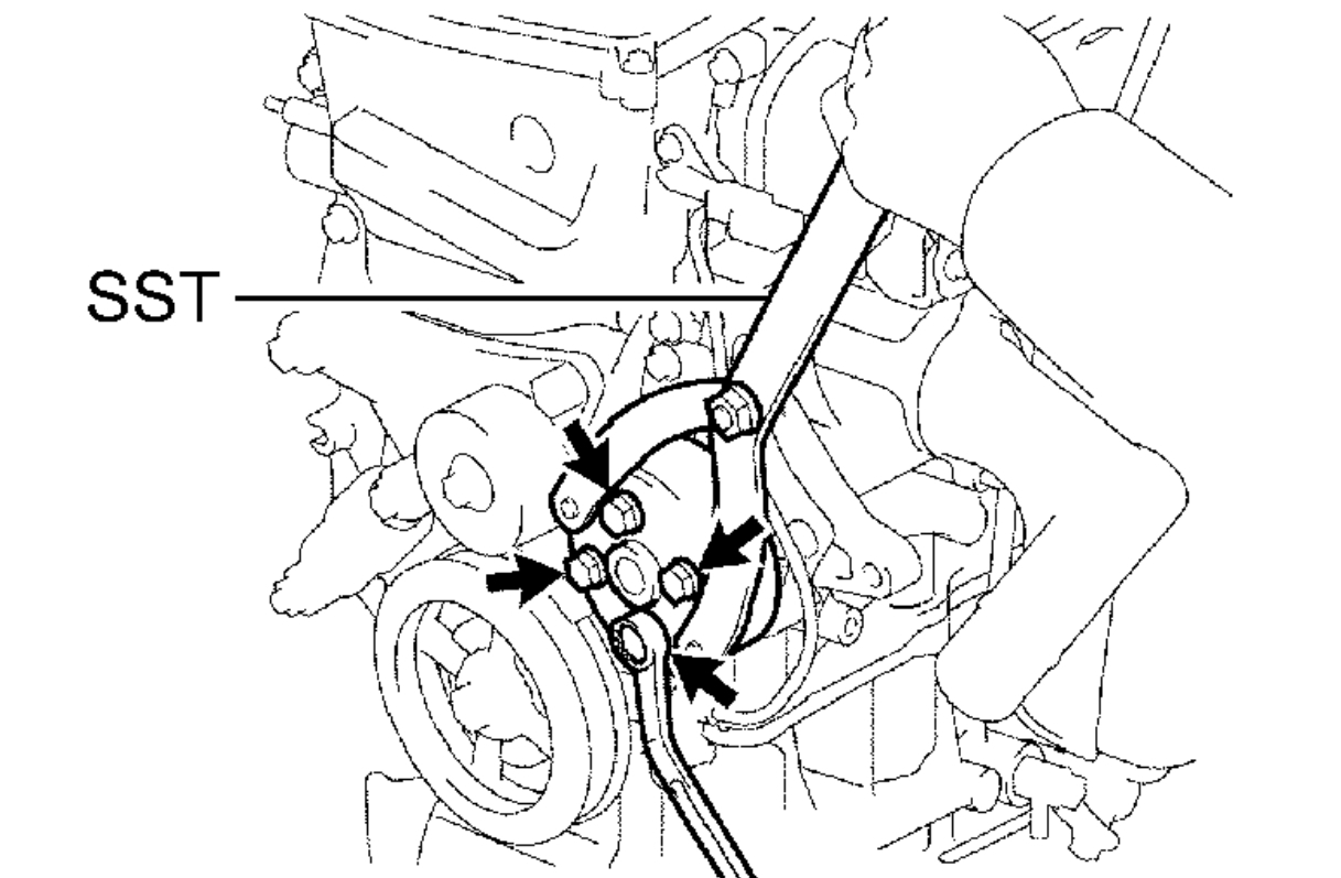

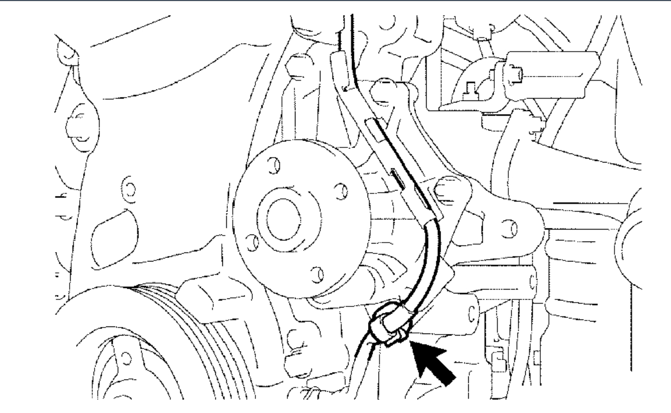

13. REMOVE WATER PUMP PULLEY
(a) Using SST, remove the 4 bolts and water pump pulley.
SST 09960-10010 (09962-01000, 09963-00700)

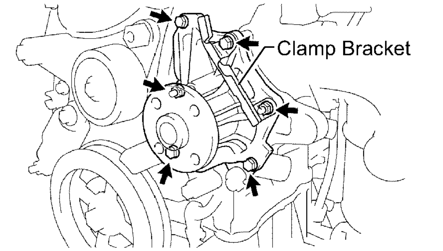

14. REMOVE WATER PUMP ASSEMBLY

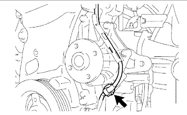

(a) Remove the clamp of the crankshaft position sensor from the water pump.
(b) Disconnect the wire of the crankshaft position sensor from the clamp bracket.
(c) Remove the 4 bolts, 2 nuts and clamp bracket.

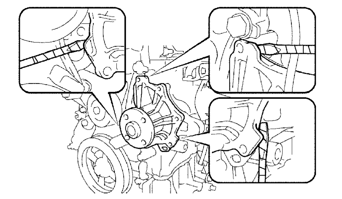

(d) Using a screwdriver, pry between the water pump and cylinder block, and then remove the water pump.
HINT: Tape the screwdriver tip before use.
NOTICE: Be careful not to damage the contact surfaces of the water pump and cylinder block.
INSPECTION
1. INSPECT WATER PUMP ASSEMBLY
(a) Visually check the drain hole and air hole for coolant leakage.
If leakage is found, replace the water pump assembly.
(b) Turn the pulley, and then check that the water pump bearing moves smoothly without making a "click" sound.
If it does not move smoothly, replace the water pump assembly.

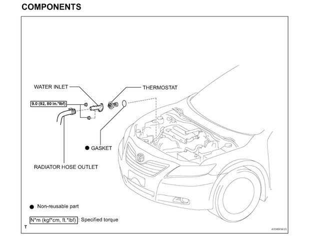

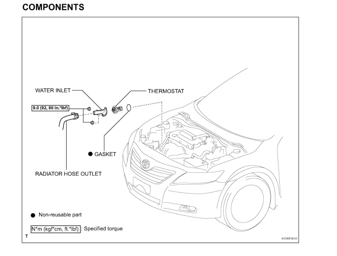

Yes, to all but I would also replace the thermostat and flush the system.
https://www.2carpros.com/articles/coolant-flush-and-refill-all-cars

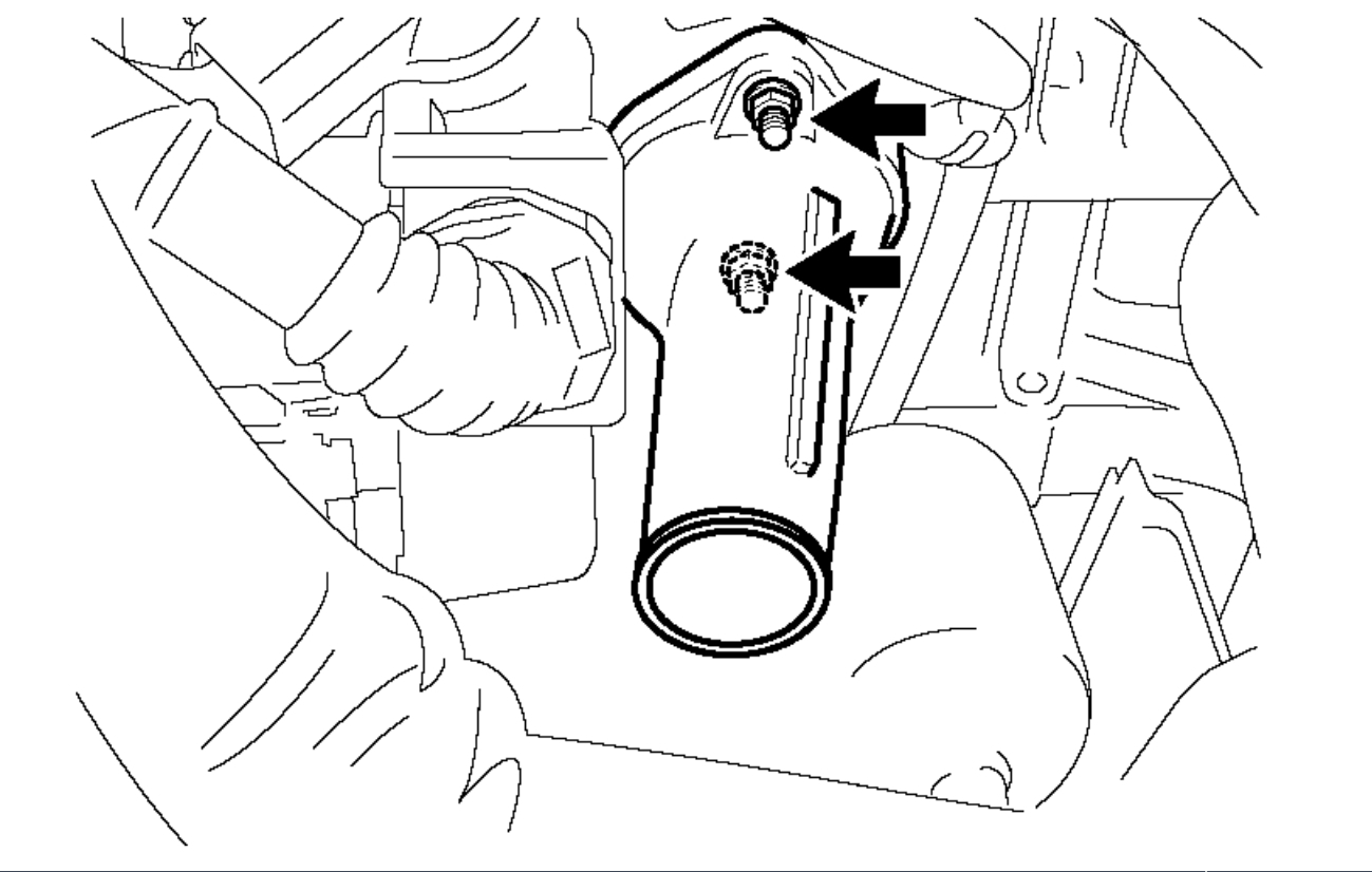

THERMOSTAT
COMPONENTS
Removal
1. Remove front wheel opening extension pad lh
2. Remove front wheel opening extension pad rh
3. Remove engine under cover lh
4. Remove engine under cover rh
5. Drain engine coolant
6. Disconnect radiator hose outlet

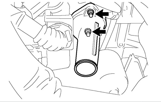

7. REMOVE WATER INLET
(a) Remove the 2 nuts and disconnect the water inlet from the cylinder block.
8. REMOVE THERMOSTAT
(a) Remove the gasket from the thermostat.
INSPECTION

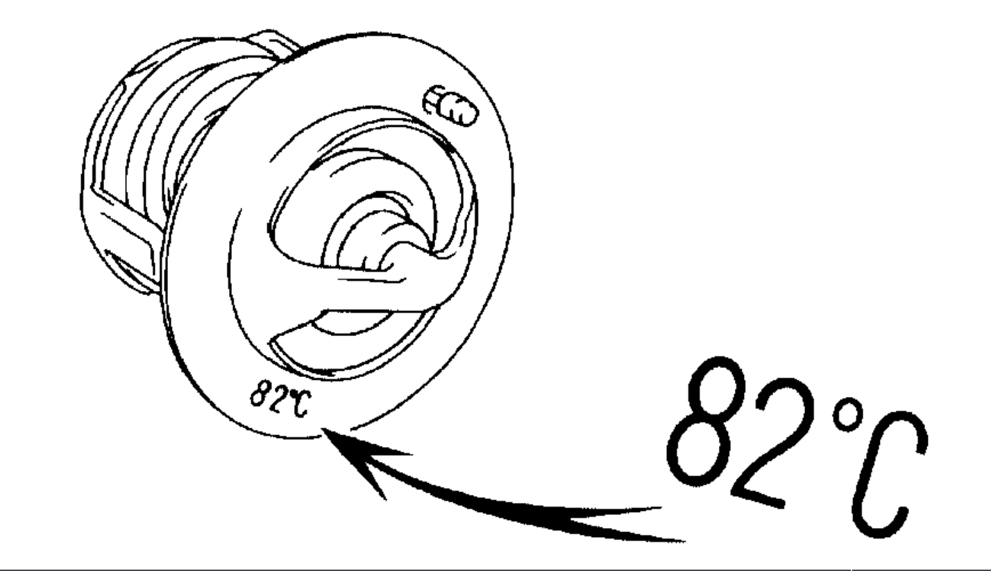

1. INSPECT THERMOSTAT
(a) The valve opening temperature is inscribed on the thermostat.
(b) Immerse the thermostat in water, and then gradually heat the water.
(c) Check the valve opening temperature of the thermostat.
Standard valve opening temperature: 80 to 84°C (176 to 183°F)
If the valve opening temperature is not as specified, replace the thermostat.
(d) Check the valve lift.
Standard valve lift: 10 mm (0.39 inch) or more at 95°C (203°F)
If the valve lift is not as specified, replace the thermostat.
(e) Check that the valve is fully closed when the thermostat is at low temperatures (below 77°C (171°F)).
If it is not fully closed, replace the thermostat.
