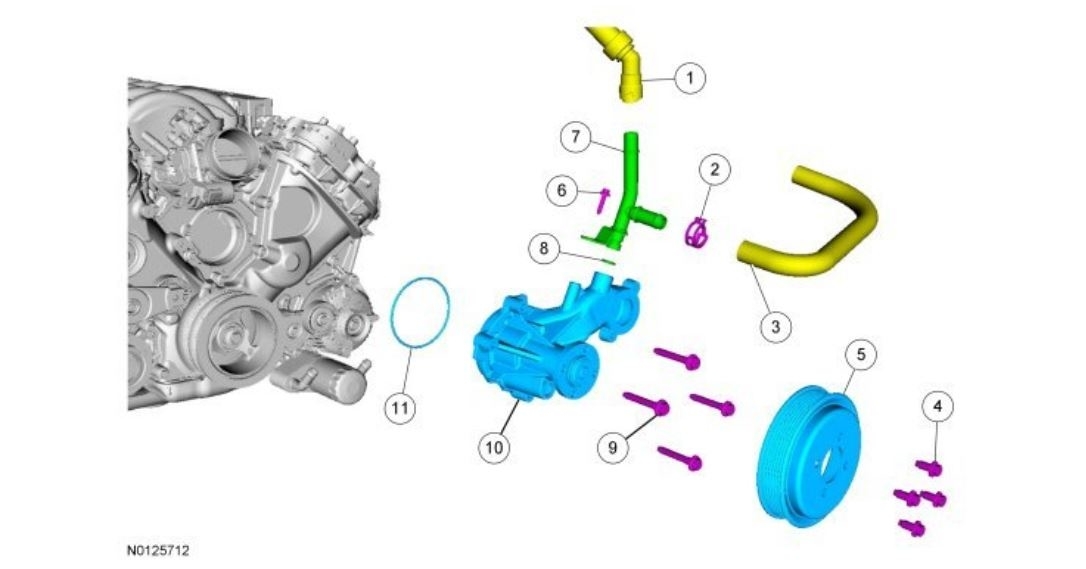

I have a coolant leak that appears to be coming from the water pump. Not sure if it is the o-ring or not.

If the water pump is leaking, most likely it is leaking from the weep hole, not the gasket.
You need to pressure test the system to verify.

Procedure
Removal

11. Remove the 4 bolts and the coolant pump.
12. If a new coolant pump is being installed, remove the bolt and the heater outlet tube.
- Remove and discard the O-ring seal.

1. If a new coolant pump is being installed, install a new O-ring seal on the heater outlet tube and lubricate it with clean engine coolant.
2. Install the heater outlet tube and the bolt.
- Tighten to 10 Nm (89 lb-in).
3. Inspect the sealing surfaces and clean with metal surface prep. Follow the directions on the packaging.
4. NOTICE: Align the bolt holes with the bosses prior to insertion of the coolant pump and insert the pump straight into the coolant pump cavity. Do not rotate the coolant pump once installed in the coolant pump cavity or the O-ring seal can be damaged, causing the coolant pump to leak.
NOTE: Install a new O-ring seal and lubricate it with clean engine coolant.
Install the coolant pump and the bolts
- Tighten the coolant pump bolts in 2 stages.
- Stage 1: Tighten to 20 Nm (177 lb-in).
- Stage 2: Tighten an additional 60 degrees.

I second the weep hole statement! The bearing also go out on these between 60-80k miles on average.

Thanks for the quick replies guys! It’s not coming out of the week hole, it’s coming straight out the front of the water pump housing. Either way it obviously has to be replaced. Any tips on which company to buy from? And should I replace the thermostat or anything else while I’m down there?
May 1, 2019 at 11:27 AM
I would check with rockauto. They have the best prices for these parts.
I would also replace the thermostat while you are doing this and of course, new coolant.

So do i just need to change the thermostat, or the thermostat housing as well? And do I need a new water pump gasket as well as the water pump?
Thanks for all of your help! This is my first major fix on this truck
May 2, 2019 at 1:14 AM
The gasket comes with the pump.
Yes to the housing as well.
