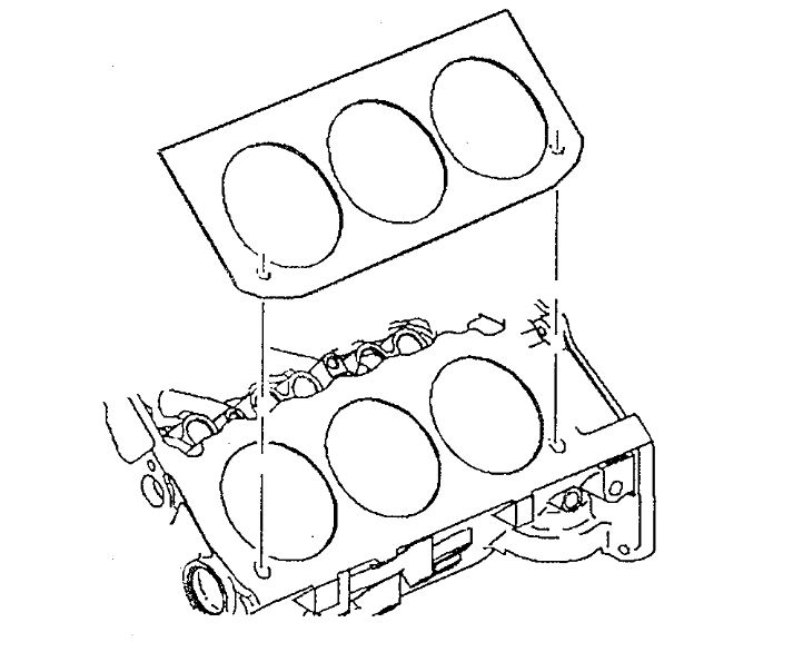

You have a failed head gasket. It is allowing coolant into the oil.
Have the system leak tested to be sure but this is very common with the 3.4.
I would address this as soon as you can. Coolant in the oil damages the main and rod bearing and will result in engine failure if left alone.
