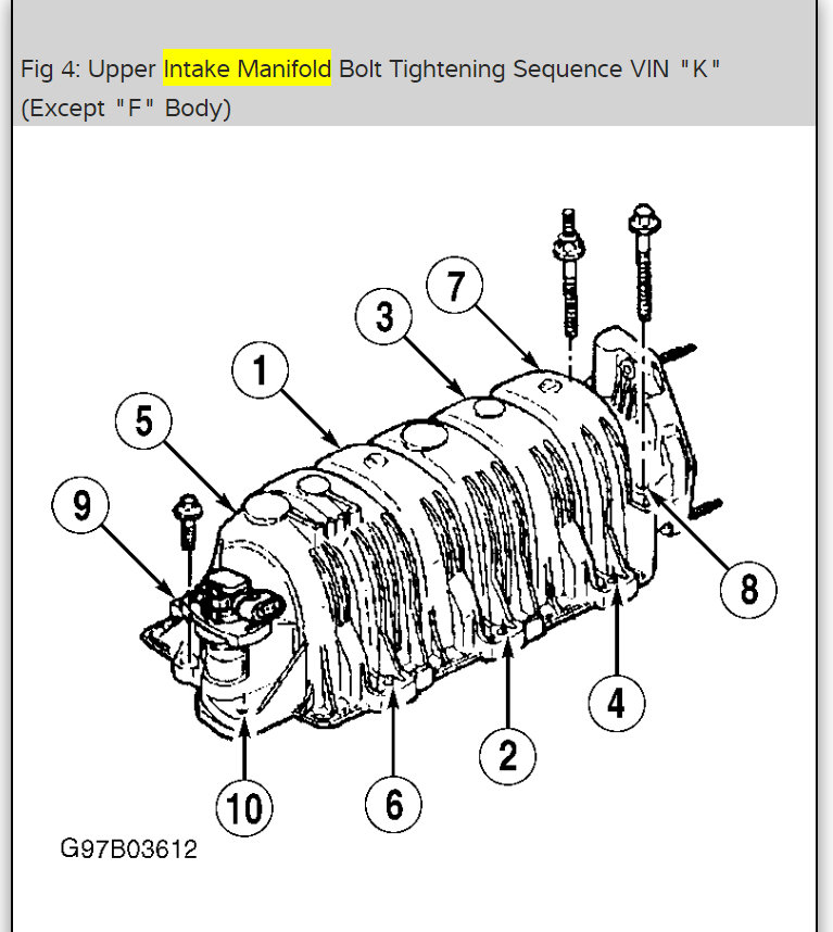

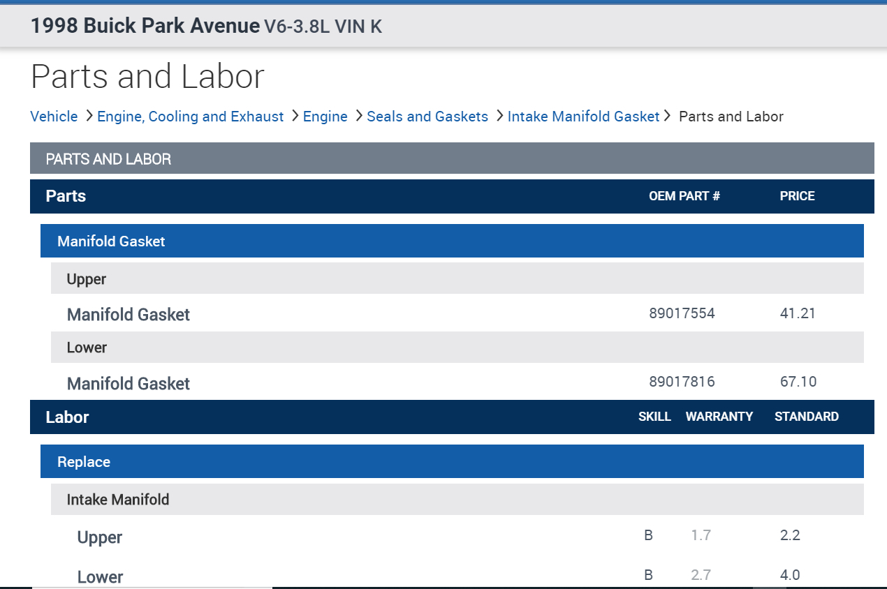

i have coolant around upper plenum. I've posted about this car a lot. Car was given to me. i am not rich. I'm on Social Security and I'm not sure if fixing this anymore is a good idea. i was told by a cheap mechanic $500.00 to replace the upper plenum gasket. is there any other option? it's running and driving fine. Stressed. Don.
Mar 15, 2019 at 2:37 PM
SCGRANTURISMO
  • 4,897 POSTS

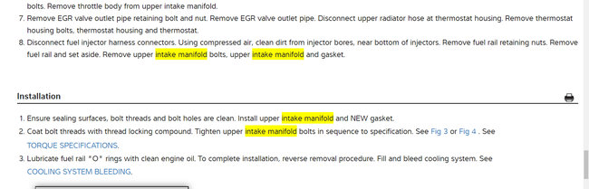

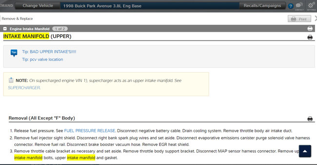

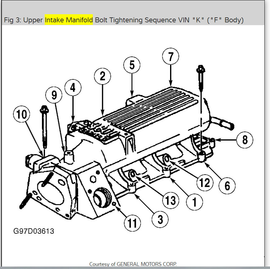

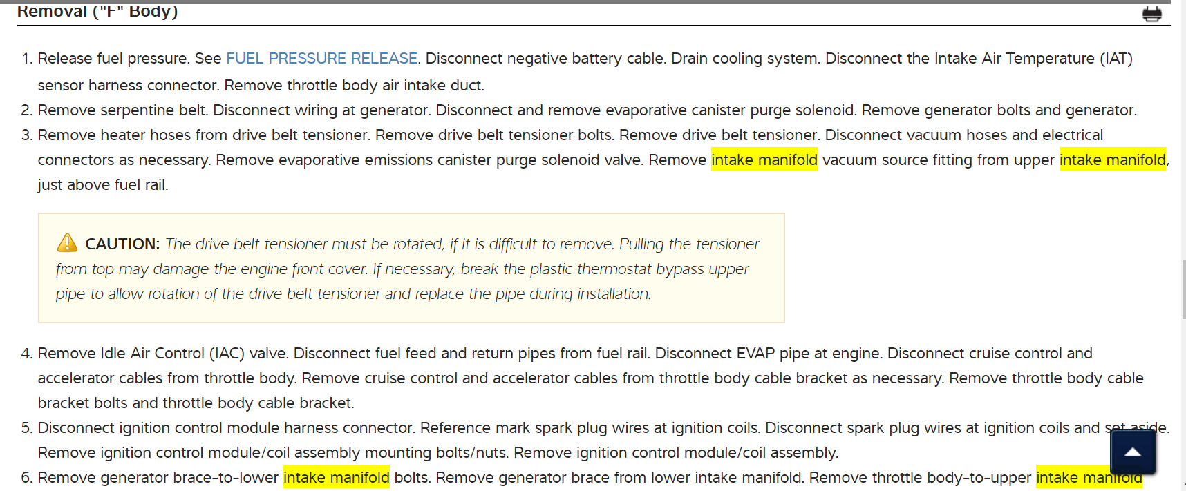

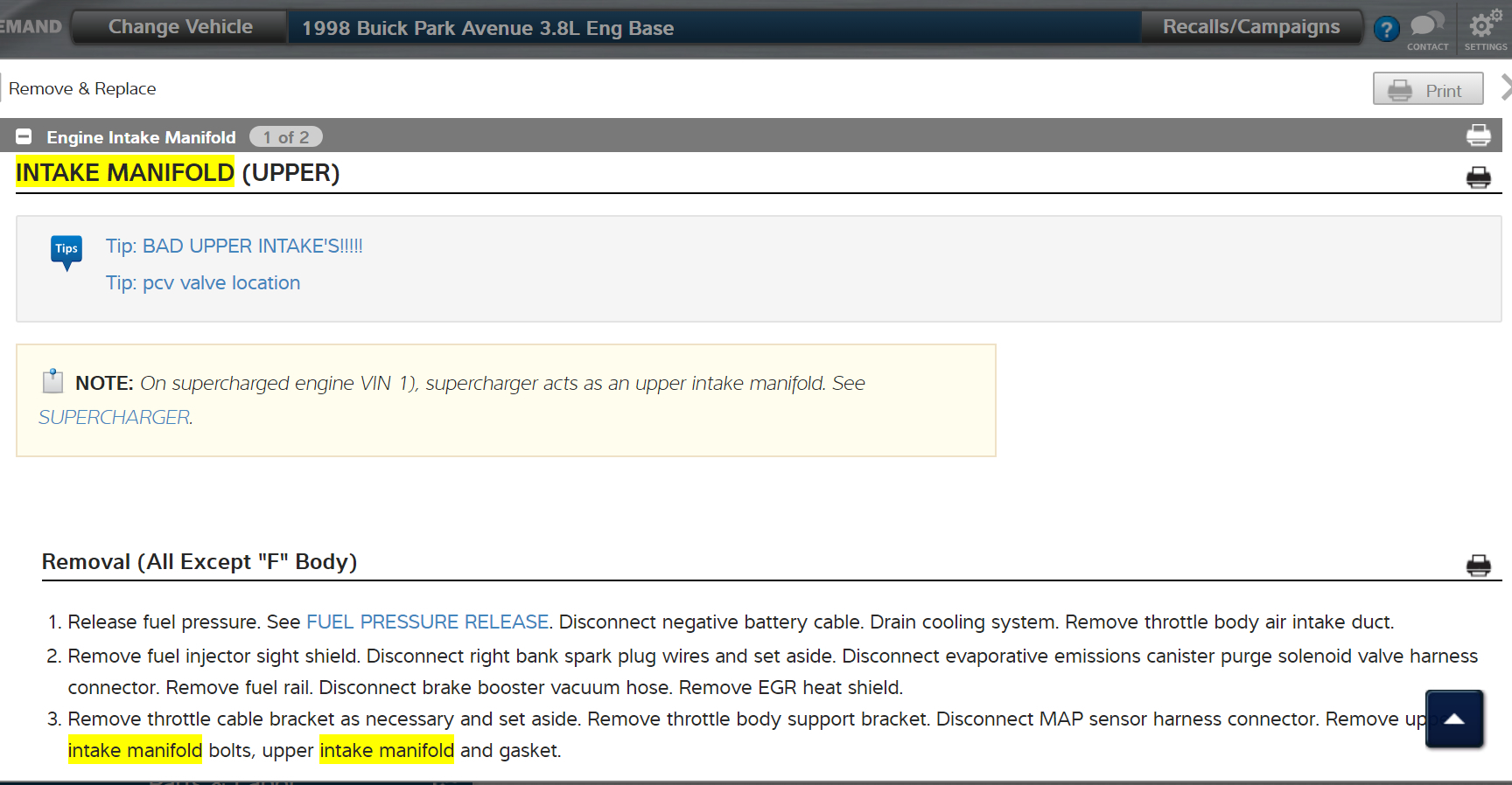

If the coolant isn't getting in the spark plug holes, or messing with any sensors or such, I guess it would be okay to drive like that as long as you kept I real good eye on your coolant level and Kept it filled up. Eventually the gasket will degrade enough that it will require replacement. In the diagrams below I have included step by step directions on how to replace it yourself if you wanted to. I also have sent along parts price and labor estimate for you if you decide to shop around to have a shop replace it for you. Either way, please get back to us with what's going on.
Thanks,
Alex

After using bars copper last night. (i followed the directions to the letter) and it seemed to help. i took it out on the highway today to get it nice and hot. i looked in the area it was leaking and it was dry when i got home. FYI, i had sludge in the oil cap but not the dipstick. no water today. i don't think it is the head but a slow pinhole in the upper gasket. this car sat for a year or two before i got it. i wonder if the gasket had shrunk. i dunno we'll see how long this lasts.
