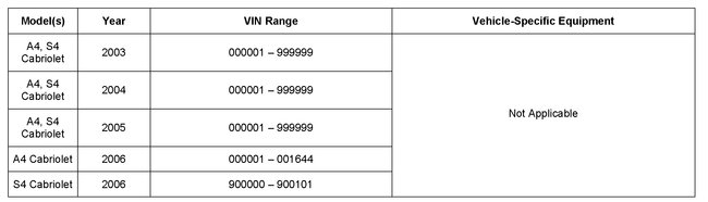

BODY - CONVERTIBLE TOP IS INOPERATIVE/DTC 2000
61 08 05
2010940/5
December 1, 2008. Supersedes Technical Service Bulletin Group 61 number 07-10 dated October 9, 2007 for reasons listed below.
61 Convertible top inoperative

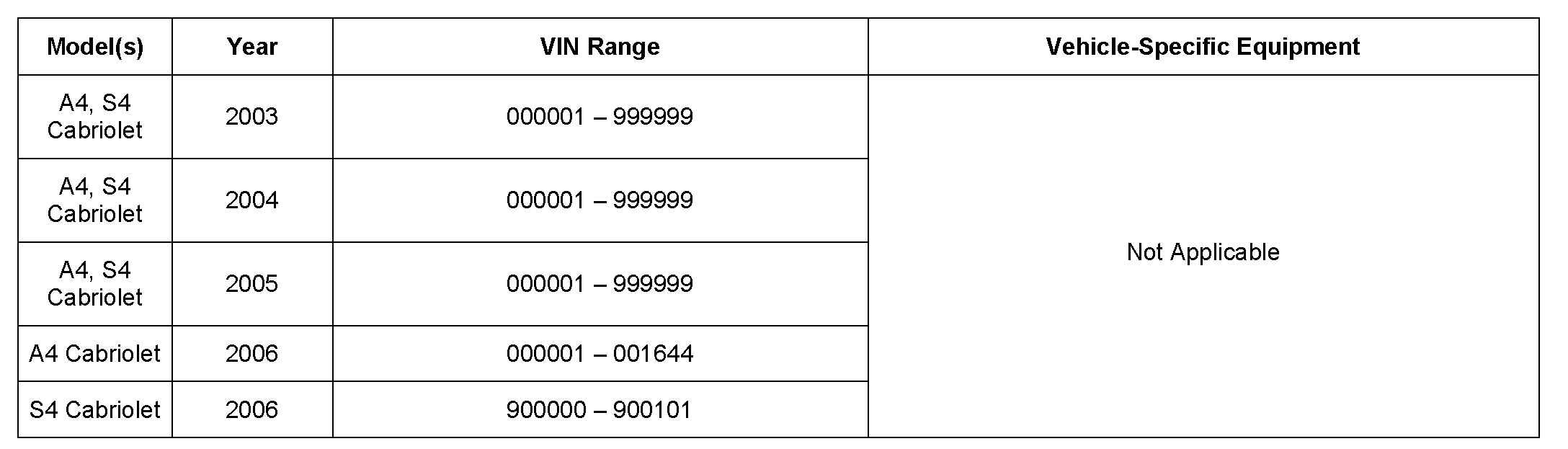

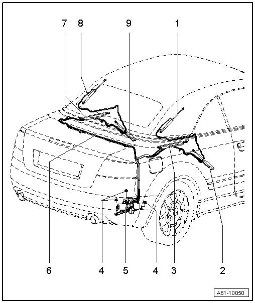

pic 1
Condition
pic 2
During opening sequence, tension bow has fallen out of range and top operation ceases. DTC 2000 (Switch position incorrect signal) will be stored in the Convertible Top Control Unit. This condition is more common when the vehicle is on an incline with the front of the vehicle elevated, such as when parked in a sloped driveway.
DTC 2000 will be the only fault present for this bulletin to apply. If there are any other faults in the convertible top control unit, these malfunctions must be corrected first. Only after these are corrected and the above condition is still present, accompanied by DTC 2000, should you continue.
Only technicians who have successfully completed Self Study Program 991203 - The Audi A4 Cabriolet and course number 991202 - Audi A4 Cabriolet Introduction are permitted to service the A4 Cabriolet. If you have not completed these prerequisites, do not continue with this bulletin. Have the case dispatched to a qualified A4 Cabriolet technician.

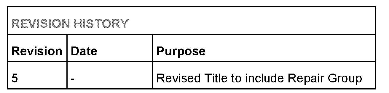

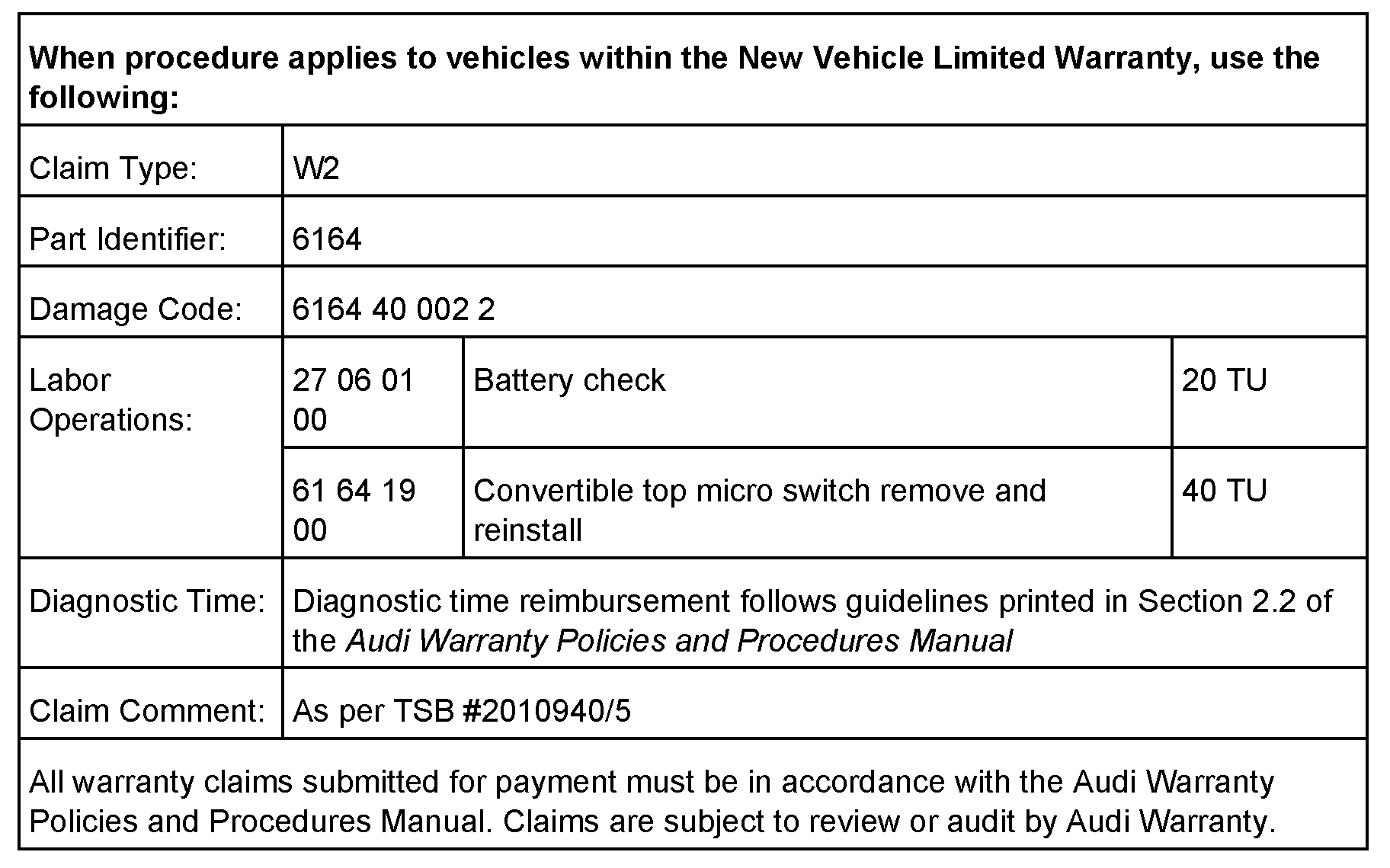

Warranty
Replaced Convertible Top Frame Position Sensors requested by the Warranty Test Center must have a copy of the Guided Fault Finding diagnosis protocol attached. Requested sensors that have Guided Fault Finding diagnosis protocol that does not support this symptom as described in this Technical Service Bulletin or is not attached to the requested sensor will be denied.

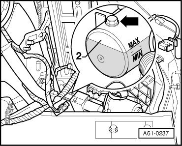

pic 3
Required Parts and Tools
Description Part No:
Convertible Top Frame Position Sensor8H0 959 613
All part and service references provided in this TSB are subject to change and/or removal. Always check with your Parts Dept. and service manuals for the latest information.

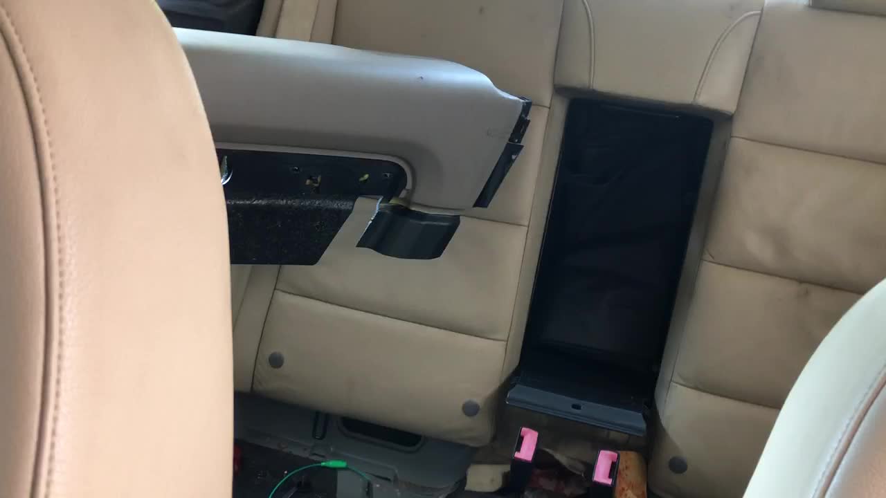

Wow, that is going to be some insane testing, hoping i can find all these numbers in the scanner. What about fuses and the such that isn't possible? The top motor?
Sep 14, 2020 at 6:16 PM
  • 110,194 POSTS

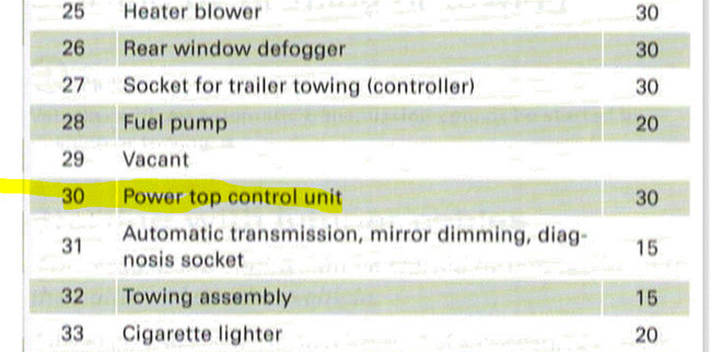

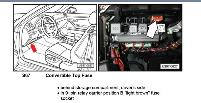

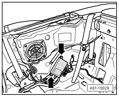

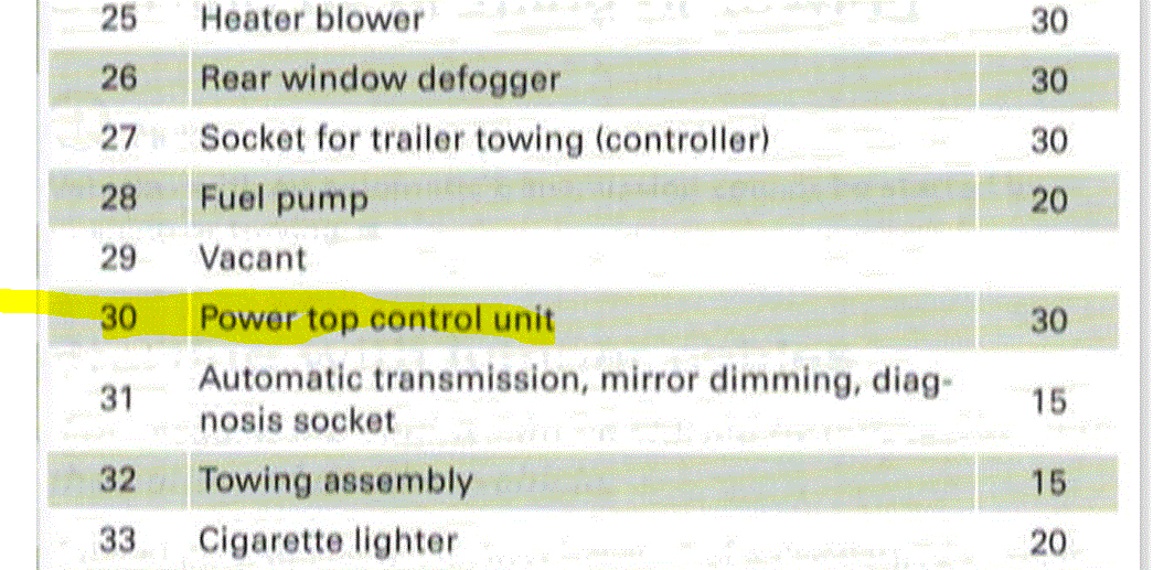

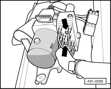

Naser, I didn't even realize it was you when I answered. I have the same car and had the same problem. Before you go crazy testing, remove the passenger side rear panel and confirm the part number on the control module. Interestingly, mine was a combination. Someone had installed a remote control for the roof and when I disconnected the wiring from it and plugged it in directly to the module, it worked. However, the module eventually failed.
I attached three pics below for you related to fuses.
Let me know if I can help.
Sep 14, 2020 at 7:04 PM
NASER NASER
  • 836 POSTS
Thanks. you mean the plastic panel on rear right of the seat?
Sep 14, 2020 at 7:06 PM
  • 110,194 POSTS
Yep, that's it.

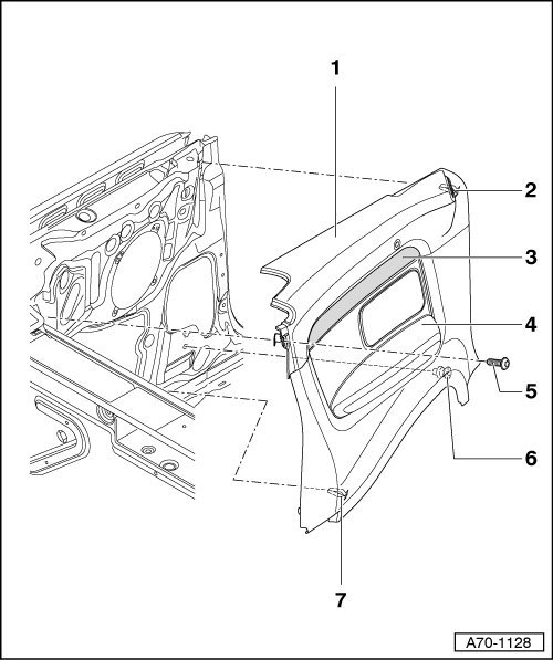

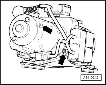

2006 Audi A4 Cabriolet (8H7) L4-1.8L Turbo (AMB)
Convertible Top Control Module
Vehicle Body and Frame Relays and Modules - Body and Frame Convertible Top Control Module Service and Repair Removal and Replacement Convertible Top Control Module
CONVERTIBLE TOP CONTROL MODULE
- Remove rear side trim.
- Disconnect electrical connectors.
- Remove control module nuts - arrows -.
pic 1
Installation is reverse of removal.
Tightening torque => [ Convertible Top Compartment Cover Latch Assembly Overview ] See: Convertible Top Deck Lid Latch > Removal and Replacement > Convertible Top Compartment Cover Latch Assembly Overview.
_________________

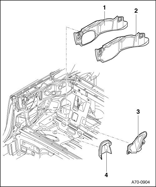

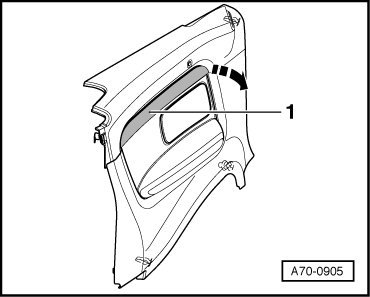

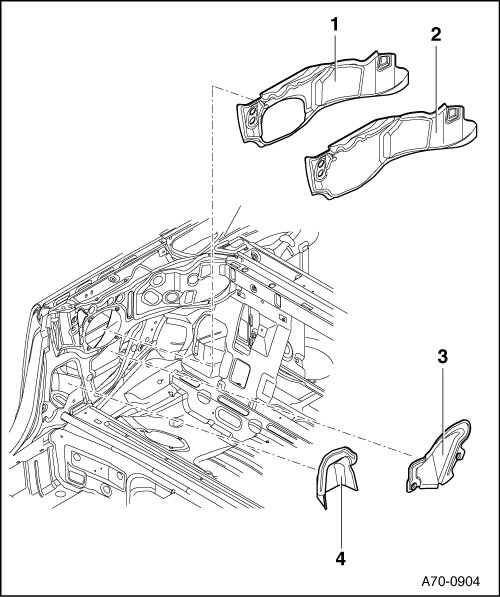

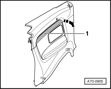

Here are the directions for the removal of the panel.
Rear Side Trim
Vehicle Body and Frame Interior Moulding / Trim Trim Panel Service and Repair Removal and Replacement Rear Side Trim
REAR SIDE TRIM
Rear Side Trim
Rear Side Trim
pic 2
1 - Side Trim
Removing
- Remove the rear bench seat. Refer to => [ Rear Bench Seat ] See: Seats > Removal and Replacement > Rear Seats.
- Remove rear seat backrest. Refer to => [ Rear Seat Backrest ] See: Seats > Removal and Replacement > Rear Seats.
- Remove trim pane. Refer to l => [ Trim Molding ] See: Front Door Panel > Removal and Replacement.
- Remove the center part - 4 -.
- Remove screw - 5 -.
- Reach into the side trim - 1 - and release the side trim - 1 - at the clips - 2 -, - 7 - and - 6 -.
- Remove the side trim - 1 -.
To replace the side trim - 1 -:
- Remove anchorage point for outer floor assembly. Refer to => [ Outer Front Floor Assembly Anchorage Point ] See: Seat Belt Systems > Removal and Replacement > Seat Belts Overview.
Installing
After installing, make sure the seal is correctly pulled over the side trim.
- Pull back on the clip - 6 - to release the tension on it - 6 -.
- Install the side trim - 1 - in reverse order of removal.
2 - Clip
3 - Trim Panel
4 - Center Section
5 - Bolt
6 - Clip
7 - Clip
Trim Molding
- Carefully pry off the trim - 1 - at the rear end in direction of - arrow -.
pic 3
- Unclip decorative panel - 1 -.
Insulation
pic 4
1 - Insulation with the Speaker Installed
2 - Insulation with the Speaker Not Installed
3 - Insulation
4 - Belt Roller Insulation
Removing
- Remove side trim. Refer to => [ Rear Side Trim ] See: Trim Panel > Removal and Replacement > Rear Side Trim
- Belt roller insulation: remove the front safety belt roller. Refer to => [ Front Three-Point Seat Belt with Belt Tensioner ] See: Seat Belt > Removal and Replacement.
- All insulation: Be careful not damage the insulation when removing.
- Remove the insulation.
Installing
- Press the insulation securely to the body.
- Belt roller insulation: install the belt roller. Refer to => [ Front Three-Point Seat Belt with Belt Tensioner ] See: Seat Belt > Removal and Replacement.
_________________________
Let me know if I can help. Also, the fuses I indicated above should be checked as well. I suspect you already have done that.

Fuses are good. Unfortunately module has the right numbers so this one does not apply to it. I am thinking the latch motor or the hydraulic pump, not sure which to start with, say if the too latch by windshield isn't working should the hydraulic pump still makes a noise when i try the switch? Or maybe the switch itself since nothing happens when i reset it or try to take it down with the switch.

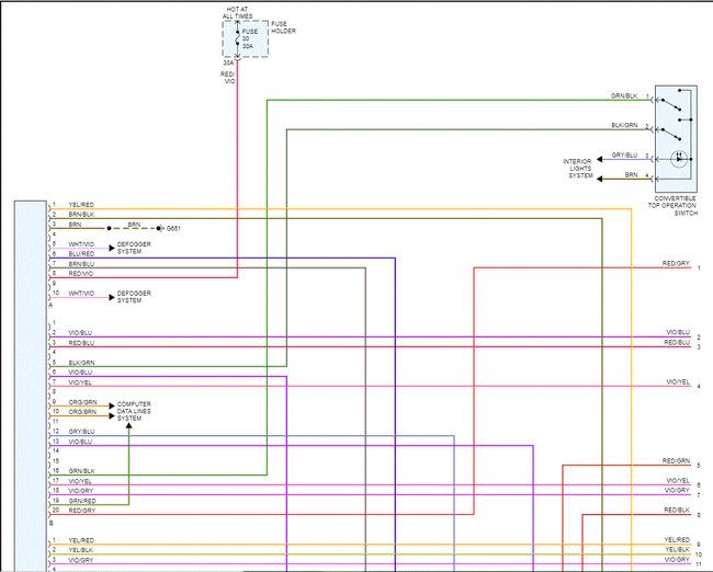

NASER NASER
  • 836 POSTS

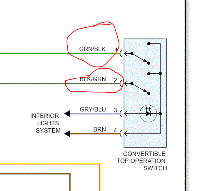

Turning ignition on foot on brake pedal no power to any of the wires in the switch.
Sep 16, 2020 at 8:03 AM
NASER NASER
  • 836 POSTS
also read somewhere that the power will come back after the reset, which I have tried twice, I will try it one more time and see what happens ugh...I say this because when you roll the windows up and down all and work, but when you hit the switch the windows are supposed to roll down a bit, even if the top hydraulic and motor aren't working, am I right here? Relay maybe?
Sep 16, 2020 at 8:22 AM
NASER NASER
  • 836 POSTS

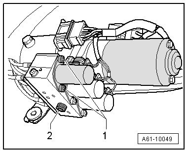

also checked on rear hydraulic pump on back right and no water damage there, fluid is full. only thing I hear is if you hit the power switch for the top the module on the right side of passenger seat makes a sound once, until you turn ignition off and on then it does it again once.. there is power not going to something somewhere, my main thing is getting power to the windows when I hit the switch.
Sep 16, 2020 at 1:50 PM
  • 110,194 POSTS
Naser,
The power to the switch comes from the convertible top module. I attached a pic below showing it.
Have you tried scanning the can system to see if it shows a fault? As far as the windows, mine drop about eight inches before the top moves.
As far as power to the switch, I can't find specifics in the manual. If you can wait until tomorrow night, I can pull my switch and check to see if one is hot when the key is on. To be honest, it only would make sense. I attached a close up of the switch and one on the module where the wiring comes from. See if one of them has power at the module. Also, confirm continuity at the switch when it's disconnected. You should have it either way (up or down).
If you have the module exposed, see if there is power.
Sep 16, 2020 at 5:59 PM
NASER NASER

NASER NASER
  • 836 POSTS
Even with the panel off it is pain to test the wires, the harness is so short, but on the first group of thick wires there is power on the reddish wire, the second middle set is the largest with 20 pins, can't find but one green/black no black green, there maybe a black, but no black/green. Same at the switch only green/black, no power at the switch at any of the wires, no power on the module green/black wire, whether attached or removed, ignition on or running, only power at the first wire...
Sep 17, 2020 at 8:24 AM
NASER NASER
  • 836 POSTS
Only makes this sound when turning ignition on.
Sep 17, 2020 at 8:39 AM
NASER NASER
  • 836 POSTS
No black/green.
Sep 17, 2020 at 8:41 AM
NASER NASER
  • 836 POSTS
Checked the black as it's the only other color I can think of on both sides and there is continuity, same for the green/black. so they are the one. no power whether connected or disconnected at the module, only the red wire has power.Delete the 2000 code about the switch and it comes back, but how does the computer know that? there is no power to it but am still hearing some click similar to the relay under the right side of dash.. no power to it and still being picked up by the scanner, weird.
Sep 17, 2020 at 9:10 AM
  • 110,194 POSTS
Hay buddy,
If you have power at the red, that is the supply to the module. If there is no power out at the green/black wire, it sounds like the module is bad.
When you said you no power at the green/black, did you check it at the switch or right at the module? There should be something from the module to the switch.
Sep 17, 2020 at 6:45 PM
NASER NASER
  • 836 POSTS
Hi, no power from the green/black at switch or out of the module, that is what I was thinking. bad module, ground is good going to module.. but isn't there like a relay? if. relay was bad would I still have power at the green? weird that only one wire, the first one, red or red with something that has power out.
Sep 17, 2020 at 7:21 PM
NASER NASER
  • 836 POSTS

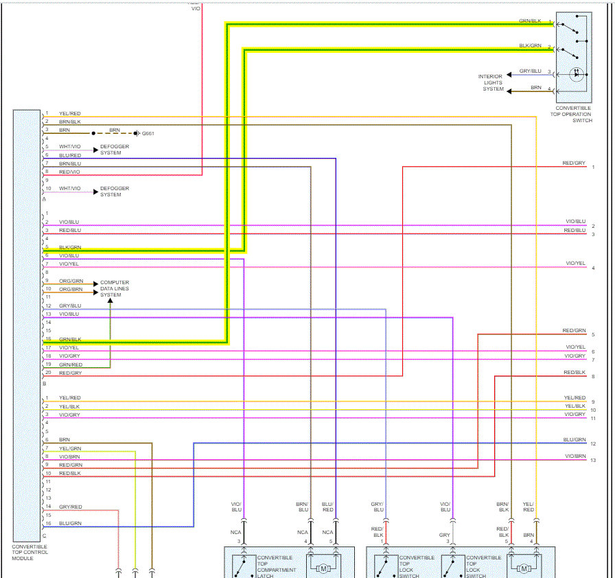

so is it possible that windows to roll down and up like they do now are controlled by one module and the drop they get when I hit the convertible top (which does not happen) is controlled by the convertible top module?
Sep 17, 2020 at 7:33 PM

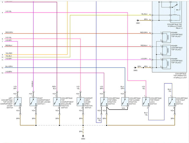

  • 110,194 POSTS

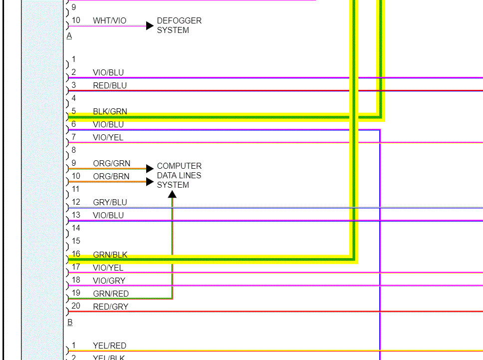

Naser, the module triggers the windows to partially open while the top is being operated. As far as a relay, the only one I know of is on the hydraulic pump.

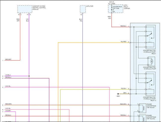

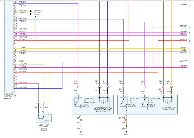

I attached the entire wiring schematic for the system. I had to break it down to make it readable, but I overlapped it so you can follow it.
Let me know if it helps.
Sep 18, 2020 at 8:44 PM
NASER NASER
  • 836 POSTS
Thanks. Based on what am looking at and where it is even if the relay is bad there should be window triggering at least or some unlatching by windshield. So doubt the relay is the issue here. I thought it would be in line with the module. So i think the module is bad as well. What do you think?
Sep 18, 2020 at 8:59 PM
  • 110,194 POSTS
Sorry to say, I think that's it and be wrong. However, that is where I am thinking the problem stems from. As far as the relay, like you, I believe you would hear something trigger. If I had to guess, I believe the module is the problem. Please understand not being there puts me at a disadvantage, but if there is power to it and nothing out, that seems like the likely issue.

Here is an overview of the system. Take a look through it.
_____________________________________________
Convertible Top Hydraulic System Assembly Overview
Vehicle Body and Frame Roof and Associated Components Convertible Top Service and Repair Removal and Replacement Convertible Top Hydraulic System Assembly Overview
CONVERTIBLE TOP HYDRAULIC SYSTEM ASSEMBLY OVERVIEW
pic 1
1 Right bracket drive motor cylinder
Removing => [ Convertible Top Hydraulic Cylinder ] See: Convertible Top Hydraulic Cylinder > Removal and Replacement > Convertible Top Hydraulic Cylinder.
2 Right main drive motor cylinder
3 Right convertible top compartment cover drive motor cylinder
4 Nut
3x
10 Nm
5 Hydraulic pump with valve block
Removing => [ Convertible Top Hydraulic Unit and Pump ] See: Convertible Top Hydraulic Control Unit > Removal and Replacement > Convertible Top Hydraulic Unit and Pump.
6 Hydraulic lines
7 Left convertible top compartment cover drive motor cylinder
8 Left bracket drive motor cylinder
9 Left main drive motor cylinder
Oil filler screw
pic 2
Pfeil 2 Nm
Hydraulic pump housing
pic 3
Arrow 6 Nm
Solenoid valves
pic 4
1. 6 Nm
2. 22 Nm
Connecting plate
pic 5
Arrow 10 Nm
______________________________-
