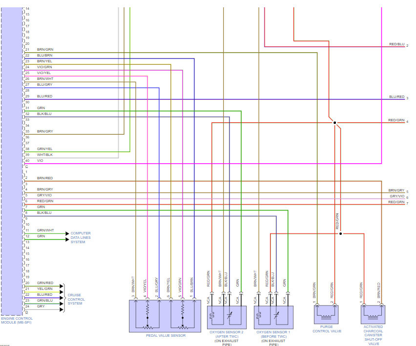

Just wanted to add if you don't have your 5-volt reference back, you'll have a no start situation. A shorted sensor will pull down the 5-volt reference circuit with any sensors that it shares. That must be tracked down before you'll get any correct ECM activity.

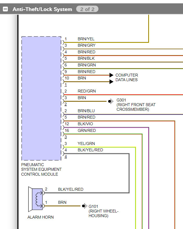

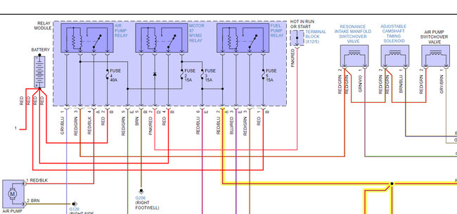

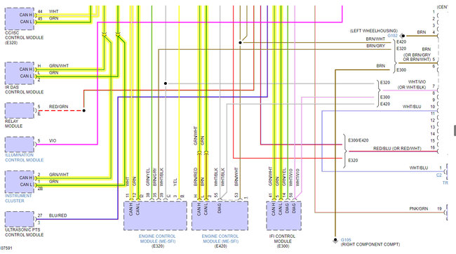

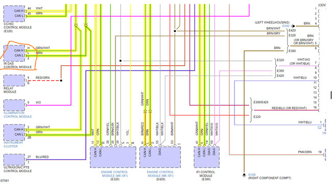

I don't believe so, but it does disable all fuel injection for the security system. Usually if the transmission is awake there is a 5-volt reference, unless this Drive Authorization System shuts down part of the transmission. In Mitchell it does say that the DAS and ECM are married together and can't be switched out. DAS also includes your Infrared system. So, you're probably correct, in that you're dealing with a security system issue. These cars are pretty complicated, even back in 1997. There are 20 modules in this model, which is amazing for how old it is.

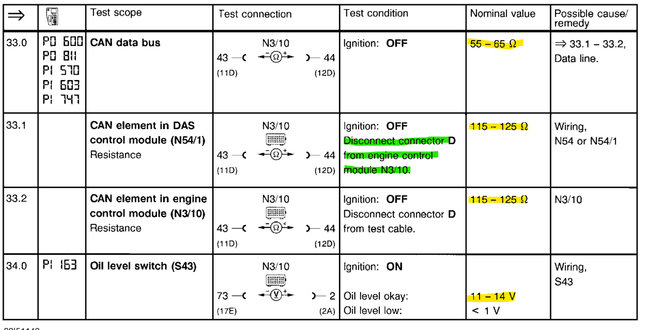

Are you able to pull any codes or have communication with a scan tool to this thing? I think swapping out modules is going to lead you to more issues, if the car has communication, a technician with the correct scan tool could probably get into the ECM and reprogram the security system. If you don't have a scan tool, you can check for communication by looking for a voltage signal on one of the CAN bus lines. That would tell you if the ECM is awake. CAN bus averages 2.5 volts, CAN bus high goes to 3.5volts and CAN low goes to about 1.5 volts when there's communications. So, with a multimeter it would average 2.5volts if there's data packets being transferred.

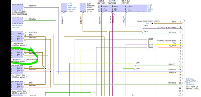

The third diagram is all CAN High and Low wires (Highlighted). Those are the High-Speed Network circuits, if the ECM is awake, you'll have a voltage signal on these wires.
But honestly i think you're going to need a technician that has a scan tool that can reprogram the security system. I have no idea how the previous tech was able to bypass the system, there must be a trick to it, but Mitchell doesn't give a whole lot of information on these different systems.
There are some mobile techs that will come to where the car is, if you have that in your area. But as you can see in the last diagram as an example, there's nothing labelled on the diagrams for the ECM. Did anything from those previous videos help out?
As for your scan tool question, the Autel MX808 is under $400 from JBtools.com but it doesn't do security system reprogramming.

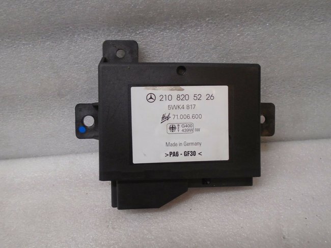

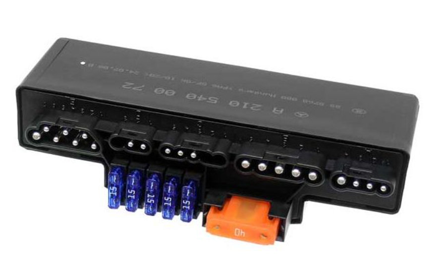

Is this the module he took out?
One more question, sorry about this, but I'm looking up different info here, does your key have a lock/unlock button on it? or was that just the FOB?
Also, the ME2-SFI is the engine control module, main ECM.
Dec 11, 2021 at 3:47 AM
ROCBAR
  • 26 POSTS
The module that was missing looks like the picture below. I got one from eBay, but I understand it has to get program to my car by a locksmith who have the proper tool to do so. I also replace my original transponder with one from the junk yard that has the same part number since a quarter of my original transponder chrome ring was peeled off. I know the chrome ring acts like an antenna. I also install the used Luck Control module as well.

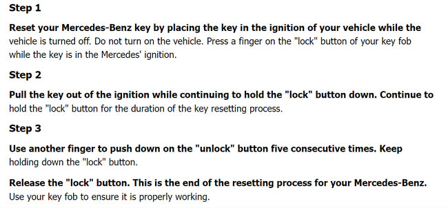

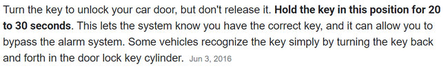

Do you have the owner's manual still? there's supposed to be some instructions in there for new keys and fobs. I was just reading about another tech that got this same could you're getting, and he just replaced the fob batteries, cleared the codes and was good. So that's where we need to get you to. Are you positive the previous tech actually took the Infrared module completely out of the car?

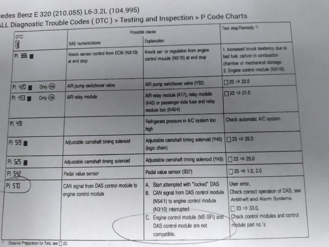

I know for sure the previous tech did remove the Lock Control module (LCM). The previous deceased owner told me the tech removed the LCM because it got corroded from water damage some time ago, but he's not sure what the tech did to get the car running. The plug for the LCM is just there hanging.
You got me thinking maybe the previous tech were able to access the system via the 38/32 pin port under the hood. I still have the owner's manual. I will take a look into it regarding the FOB reprogramming. My FOB only has one big button. When pressing for 2 seconds, a little red-light flashed once.

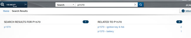

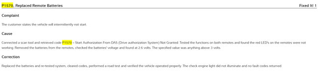

My OBD2 only has three wires coming out of the back. I am not sure which pin goes to the TCM.

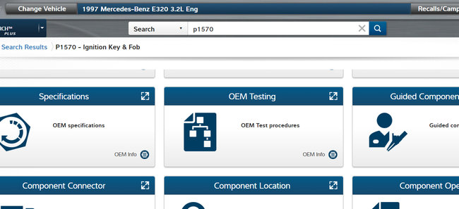

I also did some searching online regarding the P1570 code and some folks said a bad crank shaft sensor can trigger the P1570 code. Although I don't think the crank shaft sensor is the problem, but I may still need to check it; do you know the ohm reading to expect from a good working sensor?

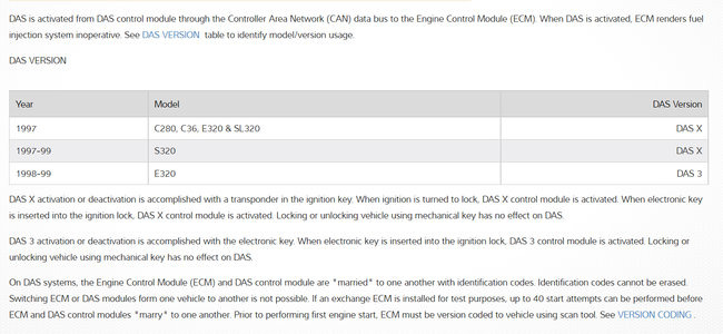

  • 5,692 POSTS

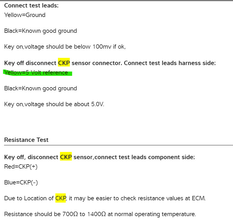

Are you able to get into live data with the scan tool, and/or does this model have a tachometer? If it has a tachometer, while you're cranking the engine over the tachometer should jump a little. I know most things are not functioning right now, I don't think this is a crank sensor issue, the ECM is being inhibited because of the missing DAS, that's what it does. That also explains why you can't read any other modules; the ECM is probably the gateway for communications.
This is right from All Data: "Note: The drive authorization system inhibits the engine management system. Although the starter rotates, the engine does not start."

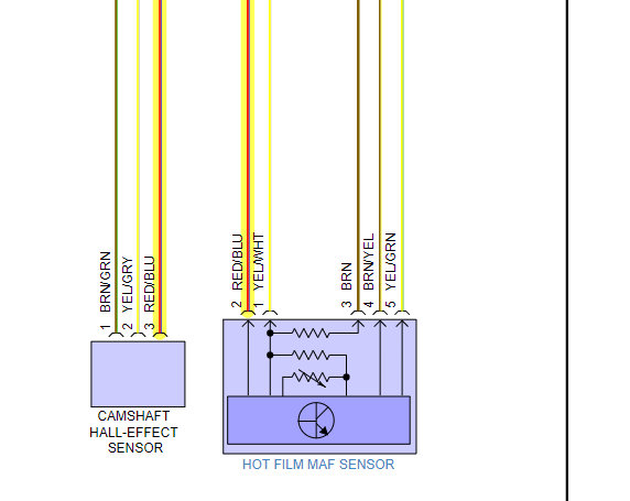

But here's the crankshaft position sensor specs, the wiring coloring is not correct on this info, the green wire is the 5-volt ref, and the green/white is the ground for the sensor. But again, if you're missing the 5-volt ref, the ECM is not awake.

I had to step away to attend to other things. Anyway, I do agree with you about the CKP is not the problem, but I am still going to take it out, test it and clean it for name sake. You ask if I can get live data : Yes I can via the OBD2 port. The CAN network protocol will not connect when selected, but the ISO 14230 protocol give me some other data. I ordered a Benz 38 pin connector and should get it this weekend so I can check all the other modules. I also was able to talk with a Benz Tech online and he told me that my IR FOB may need to be replaced, but I am dough full since I don't have a second FOB to try. See the attached file he sent me. One thing I forgot to mention is the red and green LED lights attached to the rear view mirror don't lite up at all. I check all fuses and found no problem. I am going to pull the rear view out and check it this weekend.
Dec 15, 2021 at 11:42 AM
AL514
  • 5,692 POSTS
That's the exact same sheet i was going by. This is the other half of it for testing the module and wiring. I've asked multiple people about this issue, and only had one person tell me the immobilizer can be disable but he didn't know how.
One thing about the 32/38 pin connector, when you get it, open it up and make sure the wires inside are actually soldered to the other connector. I saw some of them were fake adapters I guess, where there were no connections inside the actual connector from the OBD2 side. I really hope yours works. But maybe he is right, in the long run here to get this thing going maybe you'll need to find another module. I can't really find an explanation on how it was bypassed, almost everyone said you can't do it. But obviously something was done to get it running in the past.

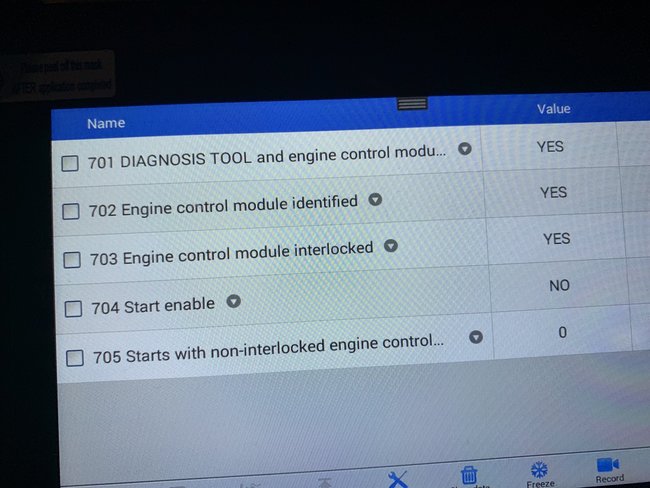

I have also noticed from one of the videos I have recognized the live data - Drive Authorization stored in the ECU with the Start Enable having a No for the value while being reprogram. See the image below
Dec 17, 2021 at 3:56 AM
AL514
  • 5,692 POSTS
Yes, i was thinking in the live data it would have a drive auth state of yes or no. The fobs obviously won't work without the infrared module. This is the issue with some guys that have a $1,000.00 scan tool that can do things for with the security systems. Most of them are more than that. It's an uneven playing field. Working two jobs and I don't make enough to go out and buy the scan tool I'd really like. I did also notice the information taken down due to it being used improperly. Of course, it would be an almost $3,000.00 scan tool. Even if you were to find an infrared module it too would need to be programmed and married to the ECM currently in the car. It's unfortunate that it's disabling the fuel injectors. There's no way to get around that, I will watch the videos you linked to in a few, I've read so much information on this issue and it's all pretty much saying the same thing you're finding. I am kind of surprised that the ECM would lose its programming though, the red and green LEDs under the mirror are straight from the Infrared module, so they wouldn't be there. An ECM that was re-flashed really shouldn't lose its coding. too bad you don't have the previous techs information to contact him again. I suppose if you have mobile technicians in your area, you could call one and see if one of them has the capability to reflash the ECM. Thats all he would need to do really, let me know if that's an option where you live. Because I don't want to leave this case unsettled.

So, what do you have, you have a mechanical key, any FOBs?
Was this the module removed, its responsible for actuating the locks and such.
Dec 19, 2021 at 4:19 AM
ROCBAR
  • 26 POSTS
My car has a mechanical key with one button infra-red FOB only; I do not have the EIS (Electronic Ignition Switch). The anti-theft lock control module was removed, so only the mechanical key is used for open/locking and starting the car. However, the DAS must have been disabled to allow only the mechanical key to work without the transponder ring around the ignition to read the FOB frequency and send it to the DAS with the rolling code. DAS will then validate the data with the ECU which gives the authorization to start. Remember, I was operating the car with only the mechanical key until I disconnected the battery for about three days. When I reconnected the battery that's when the car stops starting.
Dec 19, 2021 at 8:09 AM
AL514
  • 5,692 POSTS

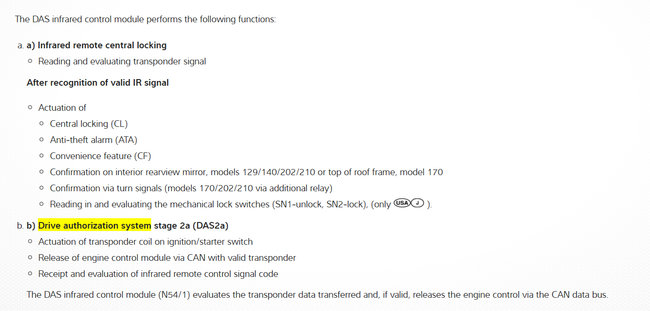

Okay, sorry I just wanted to get a clear picture here. Does the mechanical key turn in the ignition switch? Also try this, leave the key in the ignition switch (off position) for 90 minutes. I just want to see if that works. It's part of one of their key procedures. I've been reading about MB systems, and they have quite a few different ones, I guess they have changed the Start Auth system a lot over the years. It's good to know your car doesn't even have the EIS, which would complicate things a lot more. And does the transponder have any LEDs built into it? and do they light up?
I'm asking because the DAS has the infrared integrated into it. It's not a separate module.
Okay, I just went back through everything you wrote previously. You got a different key fob, transponder from the junkyard with the same part number, but yes that one will need to be married/taught to the vehicle. Thats why it's flashing red.
These cars have so many things that need to happen in order to start, one module sends a signal to another, then another, and so on.

You will have to focus only on the 1997 E320 W210 because it is easy to get sidetrack with all other info surrounding the E320. Every year Benz makes some changes to their electronic system. The 1998 model uses an EIS which includes the transponder and incorporates the DAS within the ECM, so the system is not the same as the 1996 - 1997 which has the components separated. I have accidentally left the key within the car in the "0" position for about two days and it did not work. Yes, the used transponder from the junk yard needs to get married/taught to the car so as the anti-theft lock control module. My infra-red signal receiver LED lights doesn't work and I think it's because of the anti-theft control module. My DAS is not an IR- DAS. The above image which year car is it for?
Dec 19, 2021 at 2:08 PM
AL514
  • 5,692 POSTS
That's from your car. 1997 Mercedes E320. That diagram is the Data lines and the modules. it's the bottom half of the diagram. All the network wiring. The Pneumatic System Equipment Control Module is the other part of the security system. It controls the actuators for the locks and trunk lid etc. I'm very focused on this car and have been the whole time. Almost every fix for this code has something to do with the new fob or new batteries in it.
Dec 20, 2021 at 5:11 AM
ROCBAR
  • 26 POSTS
I am still looking for a local mobile auto electronic tech who has the proper tool to check the system and reprogram any of the modules that's need to be sync including the IR-FOB.
One company I located so for is "Elitek Vehicle Services", they claim they can do the job, but they don't go to homes. I will have to take my car to a auto service shop and they will go there and fix it. I hope to hear from a couple more mobile tech tomorrow Tuesday. I just want to weed out the possible causes.
