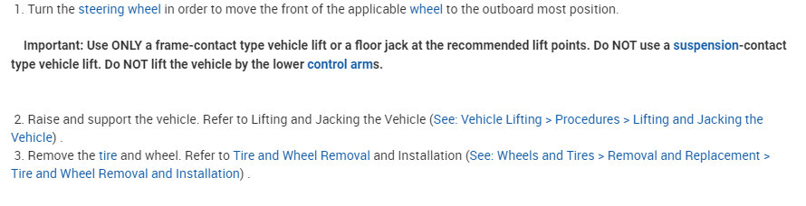

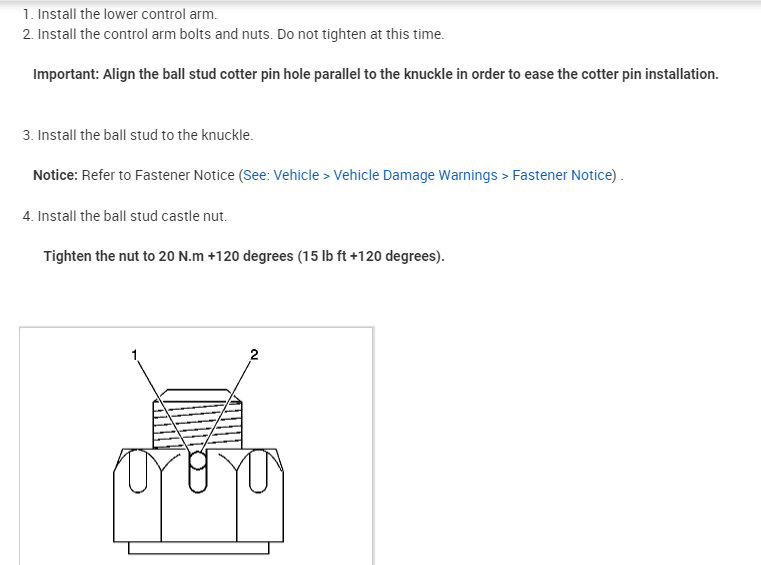

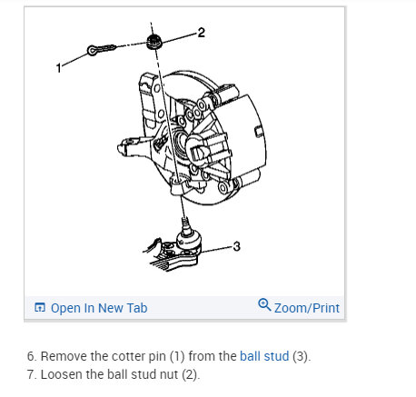

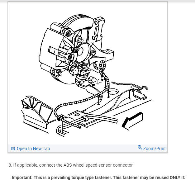

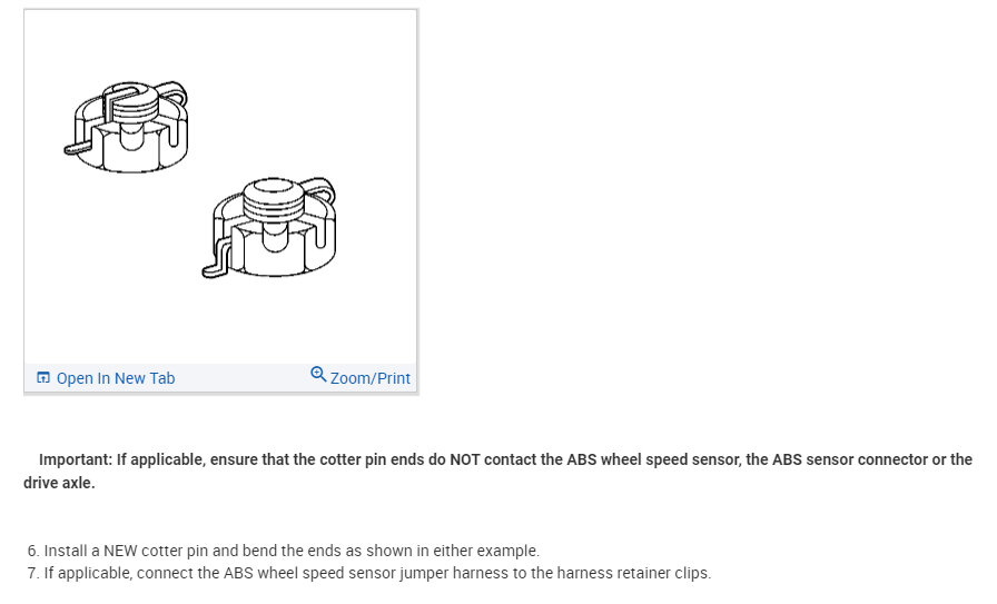

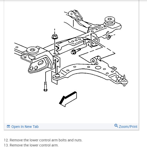

Can y'all give me steps on how to change my front L and R control arms? Thanks
Nov 8, 2023 at 11:41 AM
  • 110,240 POSTS

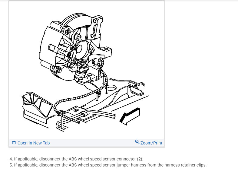

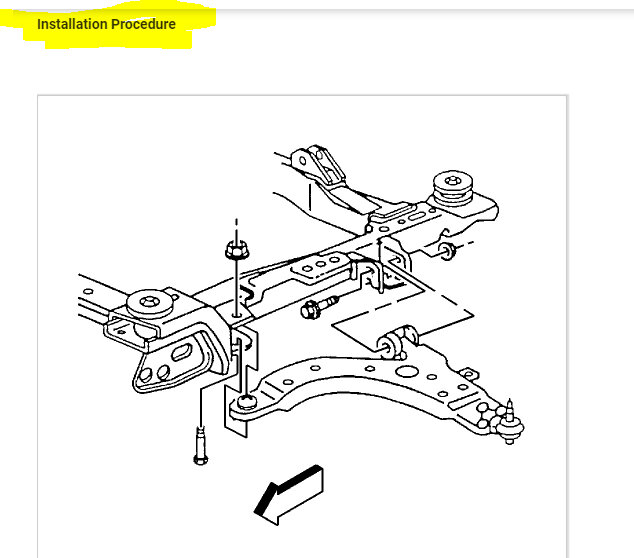

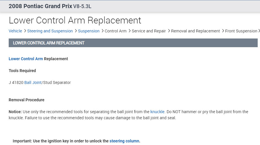

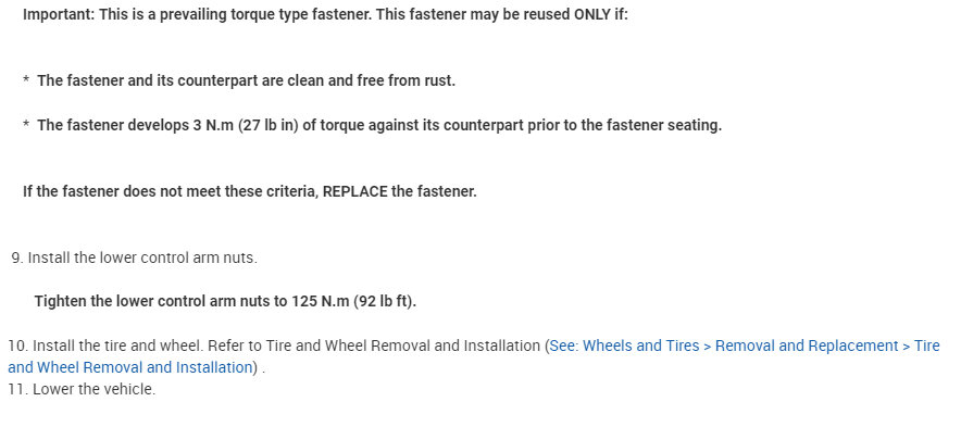

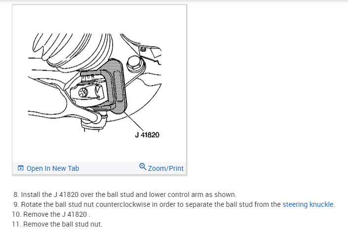

The procedure isn't as difficult as most think. However, you need to take your time and properly tighten and secure everything when you reinstall the control arm.
As far as the replacement, I attached the directions below. Both sides are basically the same as far as replacement, so the directions are for both sides.
Let me know if this helps or if you have any questions.
joe
See pic below.

Thanks a lot, it was simple ride way better. Next I want to change my CV axles they old.
