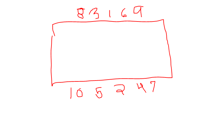

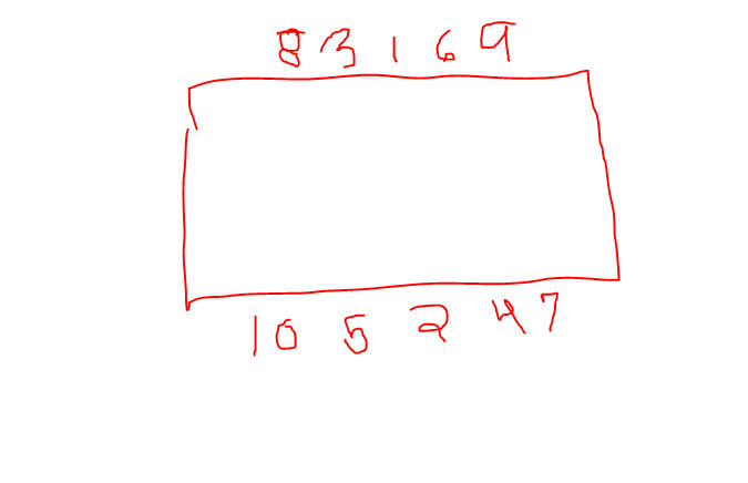

Is the oil pan torque?
Monday, September 12th, 2022 AT 4:35 AM
  • 109,867 POSTS
Because of the model year, I don't have that info. What type of gasket is being used? Also, make sure to take a ball peen hammer and tap each of the bolt holes so they aren't bent upward towards the block. From being tightened over the years, they bend inward. Make them as flat as you can.
As far as torque, if you have a rubber gasket, I always work from the center outward (see the very generic pic below that I drew). Simply snug them first. Then, go around the pan in the same sequence and tighten them. I always use a 1/4" drive so I don't overtighten them. Pay attention when tightening. Make sure the gasket isn't squeezing out.
If you have a cork gasket, all I can say is Ugh. LOL Snug it, gently tighten it and wait for about 30 minutes and retighten it. Don't overtighten it because it will split. After it's installed, expect a leak within a year. LOL
Let me know if this helps.
See the pic below (sorry it's so elementary) I'm no artist. LOL
Monday, September 12th, 2022 AT 6:24 PM
