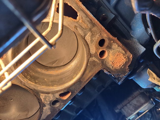

Well, I removed the other head, and it looks like the cylinder sleeve has been replaced I can't take the piston out because of a residue build-up where the rings stop, I tried to hone it out but got worried that I might do more damage because this sleeve feels very thin compared to the others. We are moving across the country soon. So, I think I will just put it back together with the new piston and will have it looked at by professionals once there. Where we live now there is no one that does that here. My gaskets come tomorrow and my piston on Wednesday hope a goes well on the reassembly. thanks again for your support.
Sep 5, 2022 at 3:26 AM
  • 110,248 POSTS
What you need to remove is a ridge reamer. It will cut the high spots so the piston can be removed. However, if it is bad enough that the piston won't come out, that may be a concern. As long as the compression was good on that cylinder, I would leave it alone.

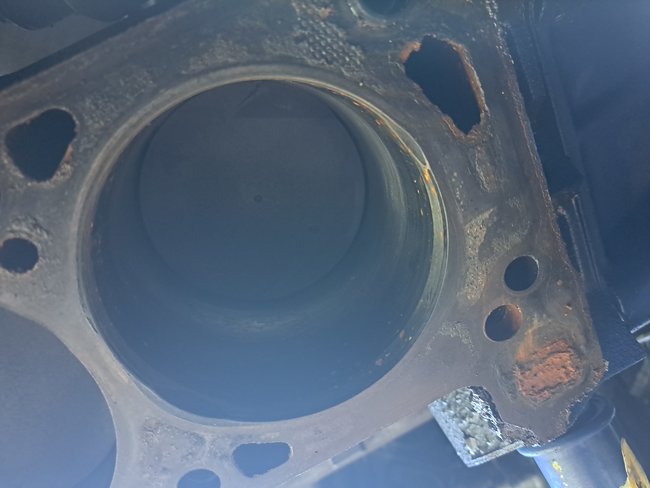

Steve,
If you want to clean build-up, brake cleaner is excellent. Just remember, it removes all oils as well, so make sure to put a film of oil on the cylinder walls because it will rust.
If you can, take a pic of the cylinder wall. I'm interested in seeing it.

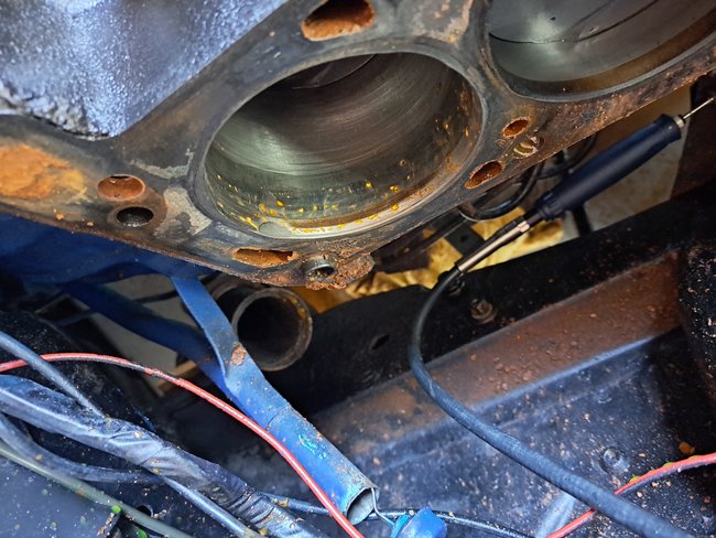

It looks like it was chamfered to slide the piston in, and the sleeve has a ridge at the top of where the piston ring stops on the changed sleeve or liner. The gaskets were put on wrong, so it did not get coolant from the second cylinder back. I was shown this on a YouTube video to be sure to put the gasket on correctly. So, this is most likely why this cylinder failed got overheated and melted.
So, this cylinder is not perfect but works to this point so I will connect back in the new piston is coming and will put everything back together. The shipper is overnighting the piston but where we live it takes 3 days LOL. Everything should be back together on Friday. I will have gaskets for the intake which should reduce the oil burn, a full piston should help reduce blow-by.
Sep 7, 2022 at 12:07 AM

Yes, me too. the red you see is mostly old coolant dye that was stuck in the heads and block after sitting stagnant for years because the gaskets were wrong.

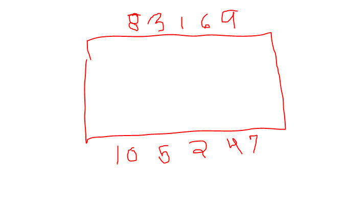

Is the oil pan torque?
Sep 11, 2022 at 9:35 PM
  • 110,248 POSTS
Because of the model year, I don't have that info. What type of gasket is being used? Also, make sure to take a ball peen hammer and tap each of the bolt holes so they aren't bent upward towards the block. From being tightened over the years, they bend inward. Make them as flat as you can.
As far as torque, if you have a rubber gasket, I always work from the center outward (see the very generic pic below that I drew). Simply snug them first. Then, go around the pan in the same sequence and tighten them. I always use a 1/4" drive so I don't overtighten them. Pay attention when tightening. Make sure the gasket isn't squeezing out.
If you have a cork gasket, all I can say is Ugh. LOL Snug it, gently tighten it and wait for about 30 minutes and retighten it. Don't overtighten it because it will split. After it's installed, expect a leak within a year. LOL
Let me know if this helps.
See the pic below (sorry it's so elementary) I'm no artist. LOL
Sep 12, 2022 at 11:24 AM
