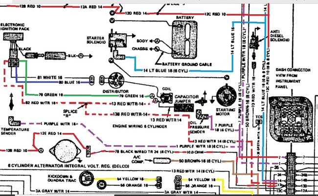

Hey, I happened to stumble into a rebuild wiring problem mess and I was wondering if you could send the picture of the wiring that you had and the diagram you had made from this post: https://www.2carpros.com/questions/jeep-cj5-1976-jeep-cj5-voltage-drop-at-coil
Thank you
Nov 17, 2019 at 6:12 PM
CJ MEDEVAC
  • 11,004 POSTS

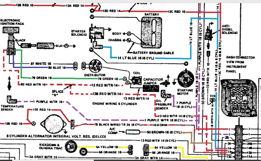

I'm going to shoot you a diagram. I think it covers 1976 - 1978.
I colored this in myself using Microsoft Paint, it's much harder to follow in black and white.
Due to the diagrams not giving wire stripes/tracer colors, I "winged" it by "Dotting"/ "Dashing" those wires with the main color (given) You'll have to hands on the wires to determine what the stripes color really is.
I had no other way to denote those wires (the dotted ones) without digging into a 1978!
