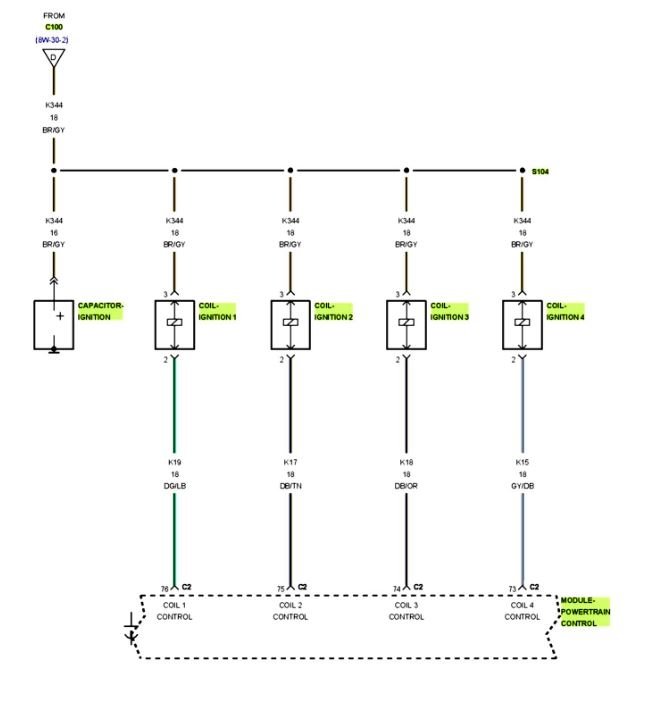

Does it make any difference if the plastic housing of the coil pack is cracked?

It can depending on why it cracked. If it is simply due to the aged plastic getting brittle and cracking versus the coils getting hot and swelling and that cracking the plastic. If it still runs good with no misfires or other issues I would probably just take some silicone and fill in the cracks to keep moisture out. If however there are signs like misfires when it rains or a code for a coil issue, then I would replace it as it could be from internal damage and that could result in PCM issues from the coils pulling excess current.

I'm getting a P2311 ignition coil D secondary circuit. Code. Two cylinder 3 and 4 not firing at all.

Okay, that code is for cylinder 4 and says that the spark in the cylinder isn't lasting long enough. Common cause for that is a bad coil or the PCM coil driver is failing. A quick way to test the coil is to simply swap it with the coil on number 1 and see if you now get a code for cylinder 1. However if it is cracked I would replace it as it's likely from heat due to an internal short.
Swapping it would show if that was the case or if it's a different issue, say you swap it with 1 and the code stays on cylinder 4 and nothing changed, that would show it's the PCM or the wiring to it. Those coils all get power from the same source on the Brown wire with gray stripe. A quick test using a test light on each coils power feed would show if that was okay. Then use the test light in the place of the coil and see if the light flashes at all. If you have power but don't see it flash then it could be the driver transistor at fault.

Thanks Steve for the info. I already tested all the coil connectors and all seem to be working. 11.89 on brown wire or first pin. Don't have anyway to turn engine over and watch the test light to see if it blinks on pin# 2 when cranking over the engine. And did you mean PCM or ECM? I don't want to replace the PCM talking involving Dodge now, and lots of money.

PCM. You could use a chunk of 2 conductor wire gently inserted into the connector for the coils and extend it so you can see it from the seat area. The code you have is indicative of a bad secondary in that coil. It would also explain the misfire in that cylinder. At the moment I doubt even a dealer would be able to help you as many PCMs are on backorder. You could get a used one though if yours did test bad.
