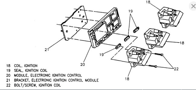

Hello, I have the car listed above that I'm working on and I need to know what size is the lug nut that came of the coil pack plate? It's two nuts and I lost them. I think I took a 13mm to get them off but to replace them what size is the thread? Not the bolts on the coil packs but the two lug nuts that hold the coil pack plate on.
Nov 9, 2020 at 4:15 PM
Good morning,
They are 8 mm, 1.25 thread pitch.
You can get them at any parts store or hardware store.
Nov 9, 2020 at 5:18 PM
IGENIUS92
  • 205 POSTS
The bracket plate there's two screws that has has two nuts i need the size for those.
Nov 9, 2020 at 5:31 PM
The size wrench or socket will be 13mm.
Is that the information you need?
Nov 9, 2020 at 5:43 PM
IGENIUS92
  • 205 POSTS

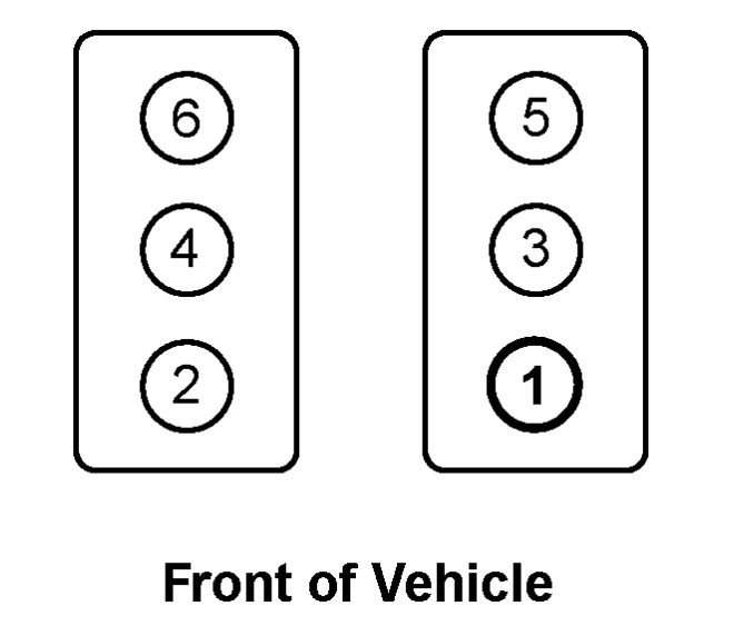

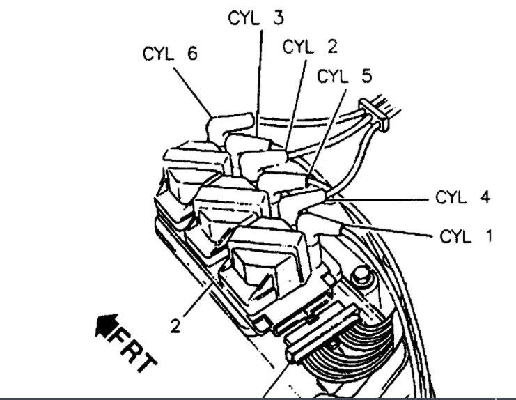

No, I'm sorry. the lug nut thread size for the 13mm nut, and do you know the firing order for the spark plugs? Also the firing order for the coil packs? I'm trying to get the right order for the spark plug wires to connect to the coil packs. guess I should of marked them, lol. but I was in a hurry.
Nov 9, 2020 at 11:49 PM
The stud size is 8mm 1.25 by 1 1/2 inches.
I attached the wire location for the coils and the cylinder identification.
Nov 10, 2020 at 12:05 AM

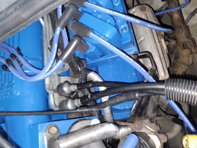

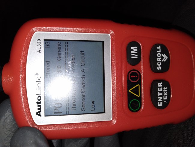

So I took of the fuel lines, air box, MAP sensor, fuel injection system and cleaned up the engine. tried to put it all back together some I marked some like the fuel lines I didn't now it started but running very rough and a few pieces of metal shot out the tail pipe red hot. Also I got a check engine code light on with this code.
Nov 22, 2020 at 9:14 AM
okay, the fuel lines are correct.
I do not like the metal out the tail pipe. I would do a compression test to see if something got into the engine and went out the back.

Hey Roy, so update: compression test fine it was my firing order that was right so I switched the spark plug wires and vroom! But I have a cylinder 6 misfire code if it isn't one thing its the next, lol. so I'm going to just buy one spark plug even though I just changed them all. they are all brand new but one spark wouldn't hurt to get the car running. right?
Nov 23, 2020 at 12:09 AM
Correct. Good find

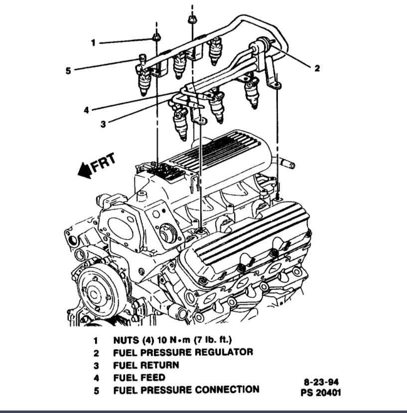

Okay, so update: i changed the spark and still have the p0306 cylinder 6 misfire code, and I also have a gas leak somewhere. I can smell it and when I pulled it out the drive way. I could see a spot where it was leaking looks like it came from the engine somewhere. Geez I'm getting so frustrated with this car.
Nov 23, 2020 at 9:46 PM
Did you do a compression test on number 6? You need 140-160.
Do not drive the car with a fuel leak. It could catch fire very easily.
Check around the injectors for a leak. I attached a picture for you of the rail.
Nov 23, 2020 at 9:57 PM
IGENIUS92
  • 205 POSTS
Can't really see where the leak is coming from the fuel injection system looks fine and dry. it is dripping down near my oil pan just can't see where it's coming from. how would I know if I hooked the fuel rails to the fuel injection system up correctly? If I crossed them up would it even start? This is so annoying i'm ready to drive this car, but the leak is my issue.
Nov 23, 2020 at 11:43 PM
Look carefully around the fuel rail where the injectors attached. Make sure you do not see any fuel leaking.
Check the lines to the rail as well. Make sure there is not leaks where the hoses connect.
