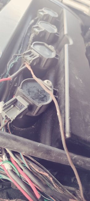

Capacitor wire not connected to anything except the capacitor.

Should go ahead and connect the brown capacitor wire to the brown/grey wire supplying power to number 1 cylinder? JC

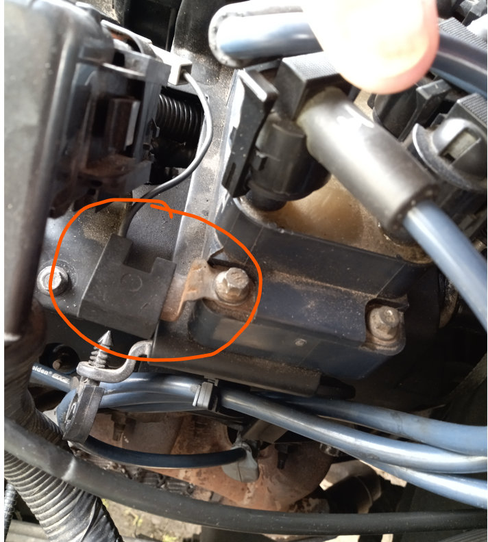

Yes, this is a picture of the Capacitor from my truck. Just so you get the idea. Make sure it's bolted to the engine block or frame somewhere because that's its Ground connection. Looks like you're doing good there. You have power to every coil now?
I feel bad someone made a mess of your car there.

Thank you so much you've helped me tremendously. I just got home I drove
It to Auto Zone and got those connectors you showed me. I think I should go ahead and replace all the connectors the wires are all worn and if jiggle the wire up close to the coils
The engine will misfire. But the good thing is now I know what to do. Thanks to you. But it ran fine going to town. Thanks again. I did tie the brown capacitor wire into the 1 coil I would never have known about that capacitor if not for you. It all makes sense now. JC
