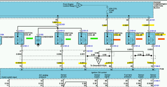

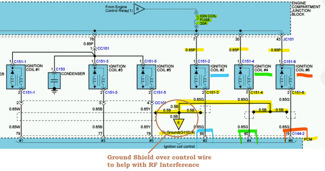

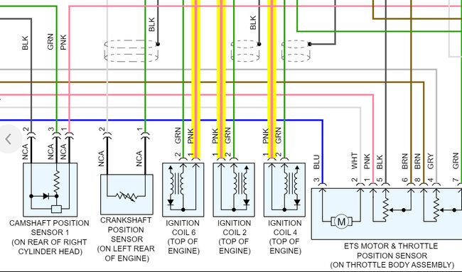

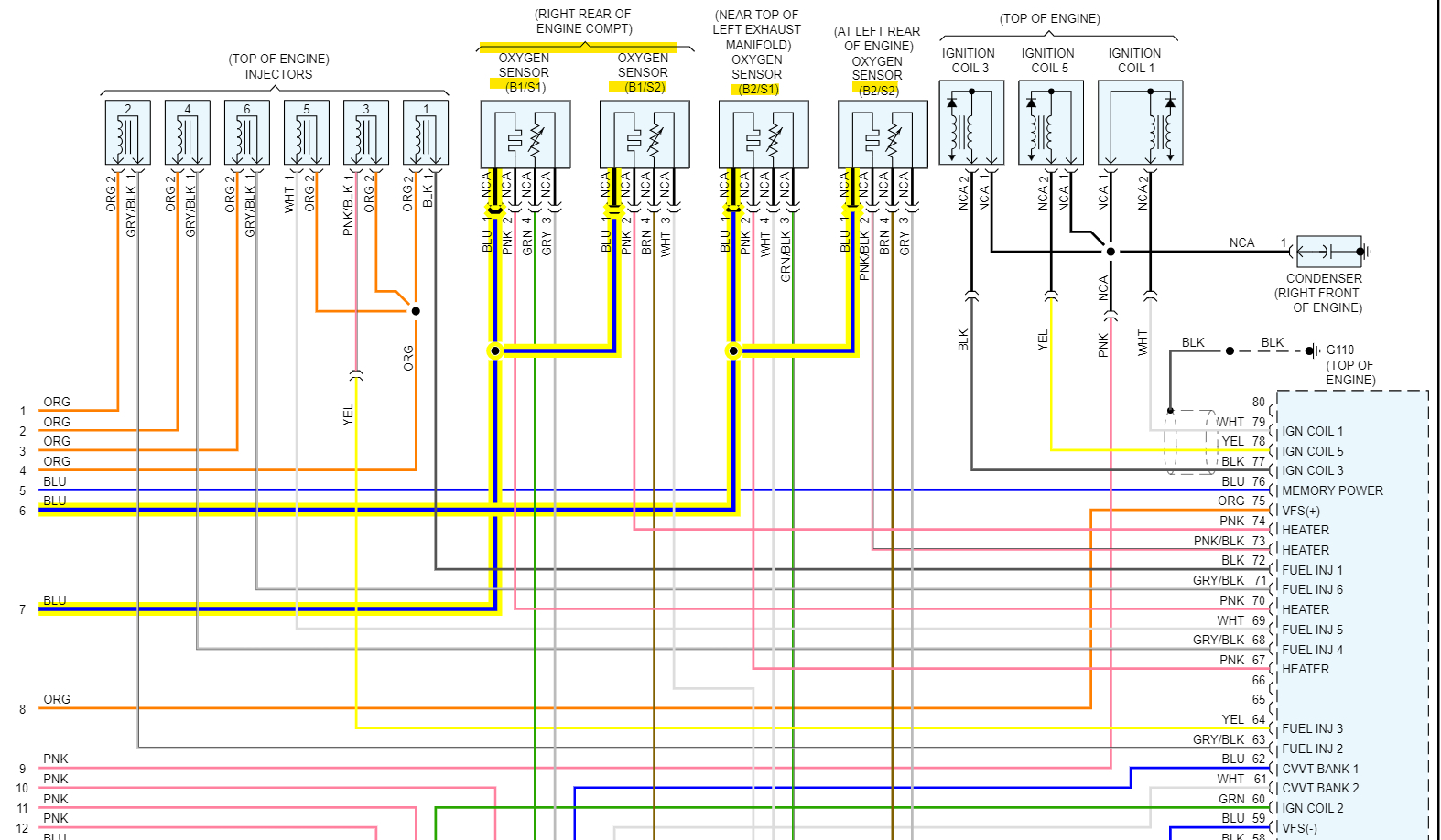

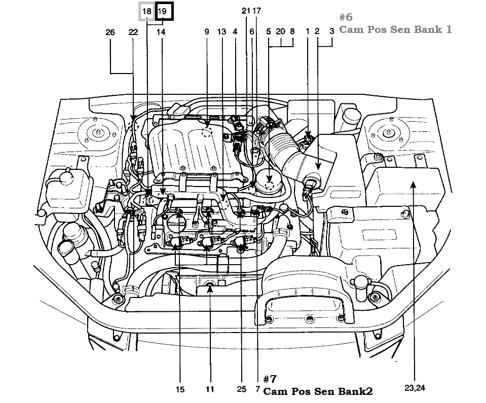

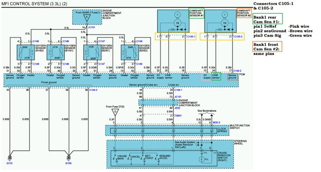

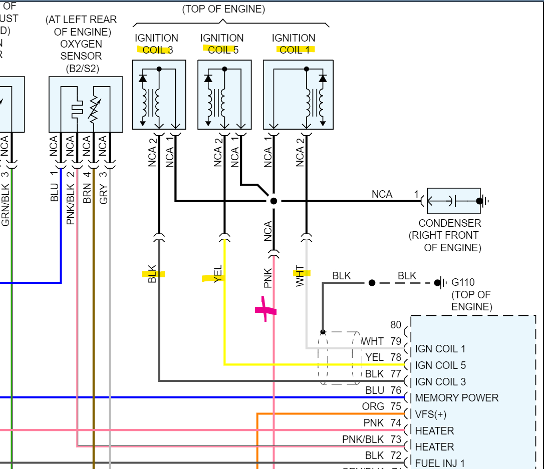

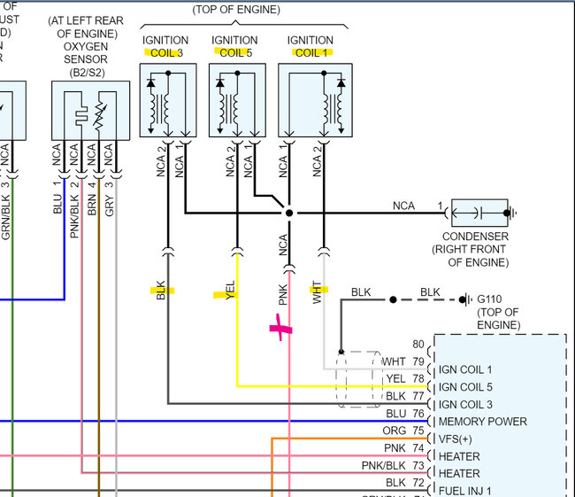

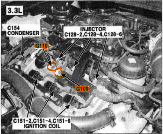

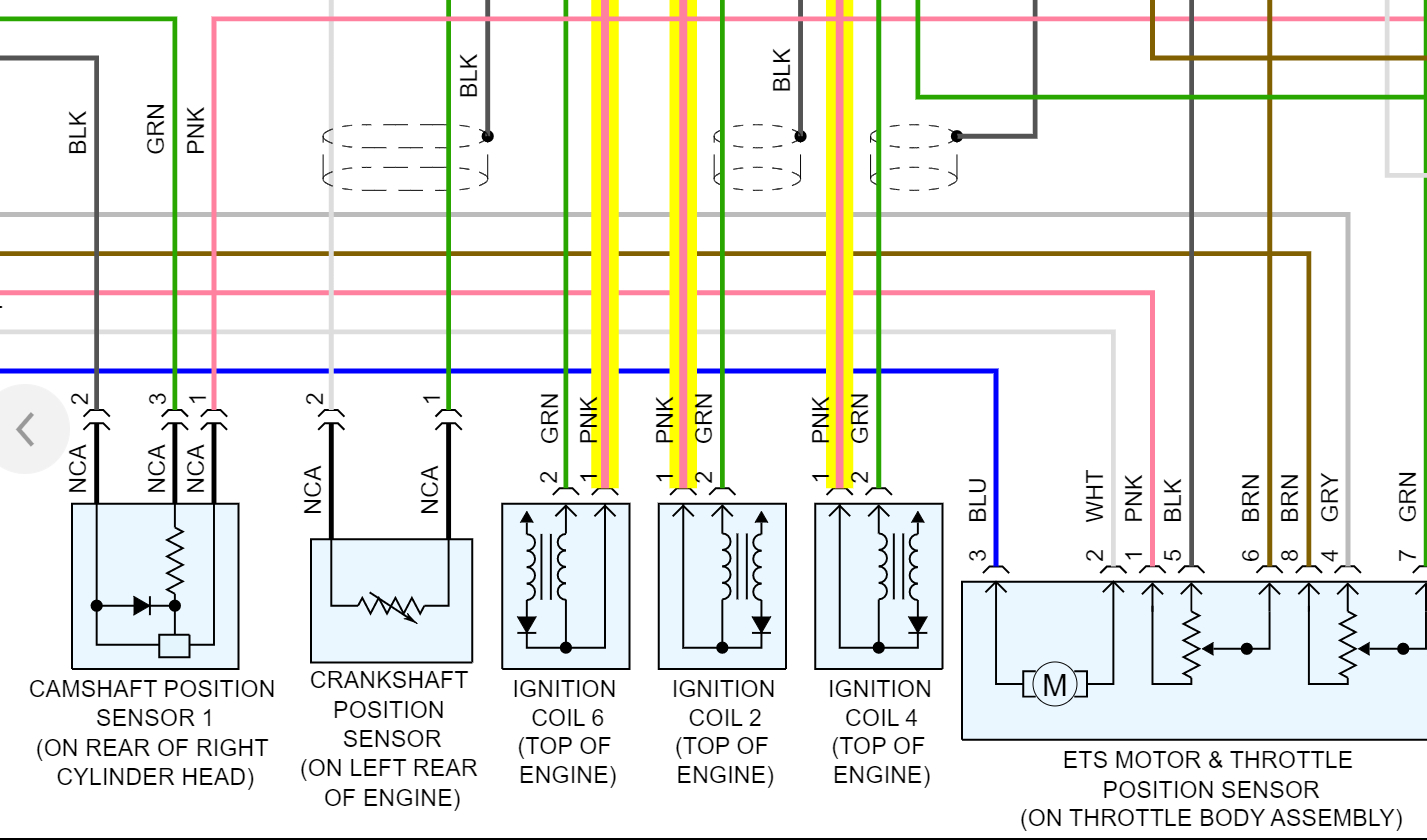

I need a wiring diagram for the front 3 cylinders. I had a rat chew the wires.
May 28, 2023 at 7:58 AM
AL514
  • 5,675 POSTS

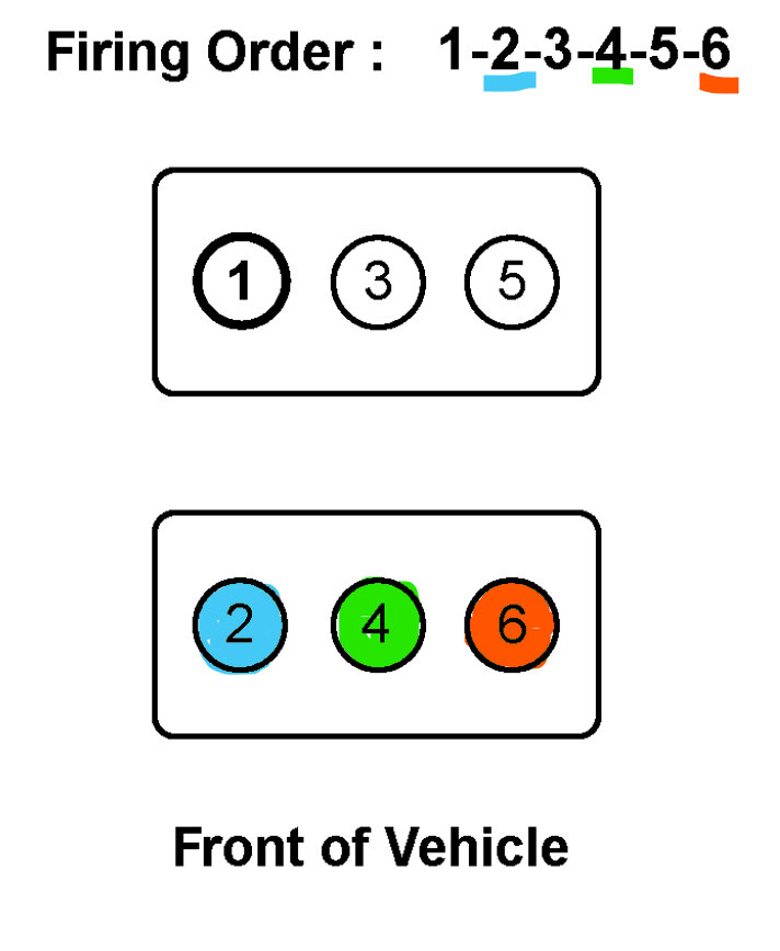

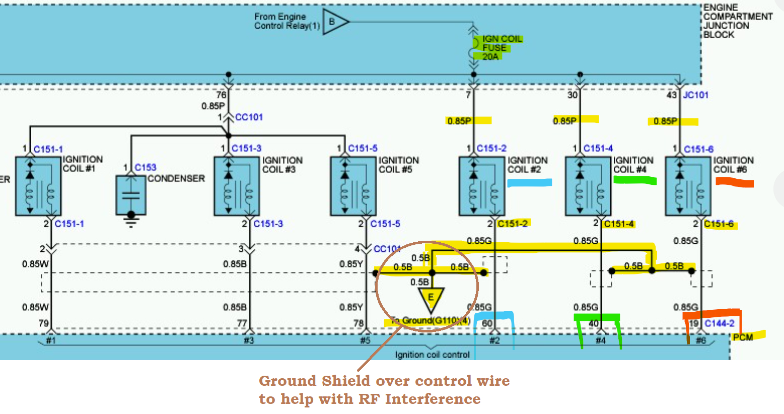

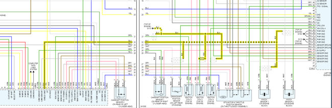

Hello sorry to hear about that, so you need cylinders 2,4,6 on the front cylinder head. There are 2 wire coils, correct? Are all the wires for the front coils the same color?
I have never seen this ever before, this is the OEM manufacturer wiring diagram for the ignition coils, and it shows the front 3 coils 2,4,6, have the same color power feed wire (pink) and the same color control wire (green). But the back 3 ignition coils have different color control wires which is what is expected. Can you confirm these front 3 coils for me? If they have different colors on the front coils, then this is an error and a bad one at that. It is showing the same on aftermarket diagrams.
I was able to trace each ignition coil wiring back to the ECM connector, so I can post the wiring for that, if it is indeed the same color wires for each coil on the front bank of cylinders. If there is a section of green wire for each of the front coils, you can unplug one of the ECM connectors and using a multimeter set on Ohms setting, you can check for continuity to the correct ignition coil from each of the 3 ECM connector pins if needed. I'm not sure how much wire is left over to work with. I hope this is somewhat helpful. I have never seen ignition coils with all the same wire colors like this before.

Yes, they are all the same color.
May 28, 2023 at 12:31 PM
TIMOTHY WAYNE DAVIS
  • 24 POSTS
There are no pink wires. Could it possibly be orange or tan?
May 28, 2023 at 9:31 PM
AL514
  • 5,675 POSTS
They might be discolored due to age, but I assume there are sections going to each coil that have 2 wires left, and is there any wiring left on the coils harness plugs? I'm really surprised that even the manufacturers wiring diagrams are showing the same colors. But there should be 2 wires going to each coil, one will be Green and the other is the power feed coming in.
If you have a multimeter and have the sections of wires striped back somewhat you can check for 12volts with the key On. But my concern here is making sure that each coil has the correct control wire going to it. It's extremely important, or the coil will fire at the wrong time. We don't want cylinder 2 firing when cylinder 4 should be. Hence the reason for each control wire being a different color. Like the back coils have. Take a picture of the mess if you can so I have a better idea of what you're dealing with. We want to get this right the first time for you.
May 29, 2023 at 4:20 AM
TIMOTHY WAYNE DAVIS
  • 24 POSTS
Thank you. You have been very helpful. I feel confident that I can figure out the control wire dilemma. The 3 wires are all different lengths and will only reach the cylinder that they go to. The coil connectors have an orange and green wire so I assume the orange wires from the harness will be the correct power wires. After further inspection the injectors wires are torn up as well as. Some of the wires further back in the harness. I won't be able to work on it for a day or two. Will keep you posted. Thanks again

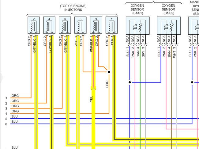

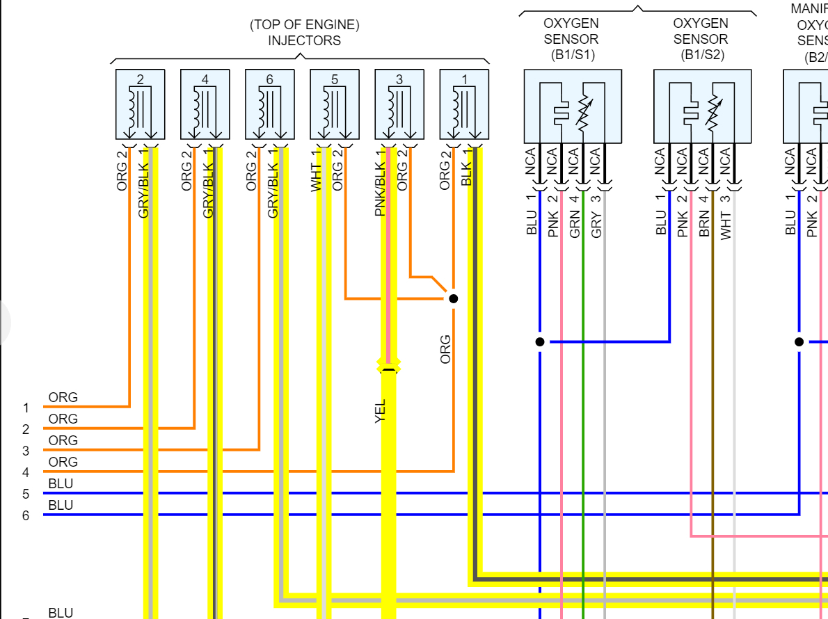

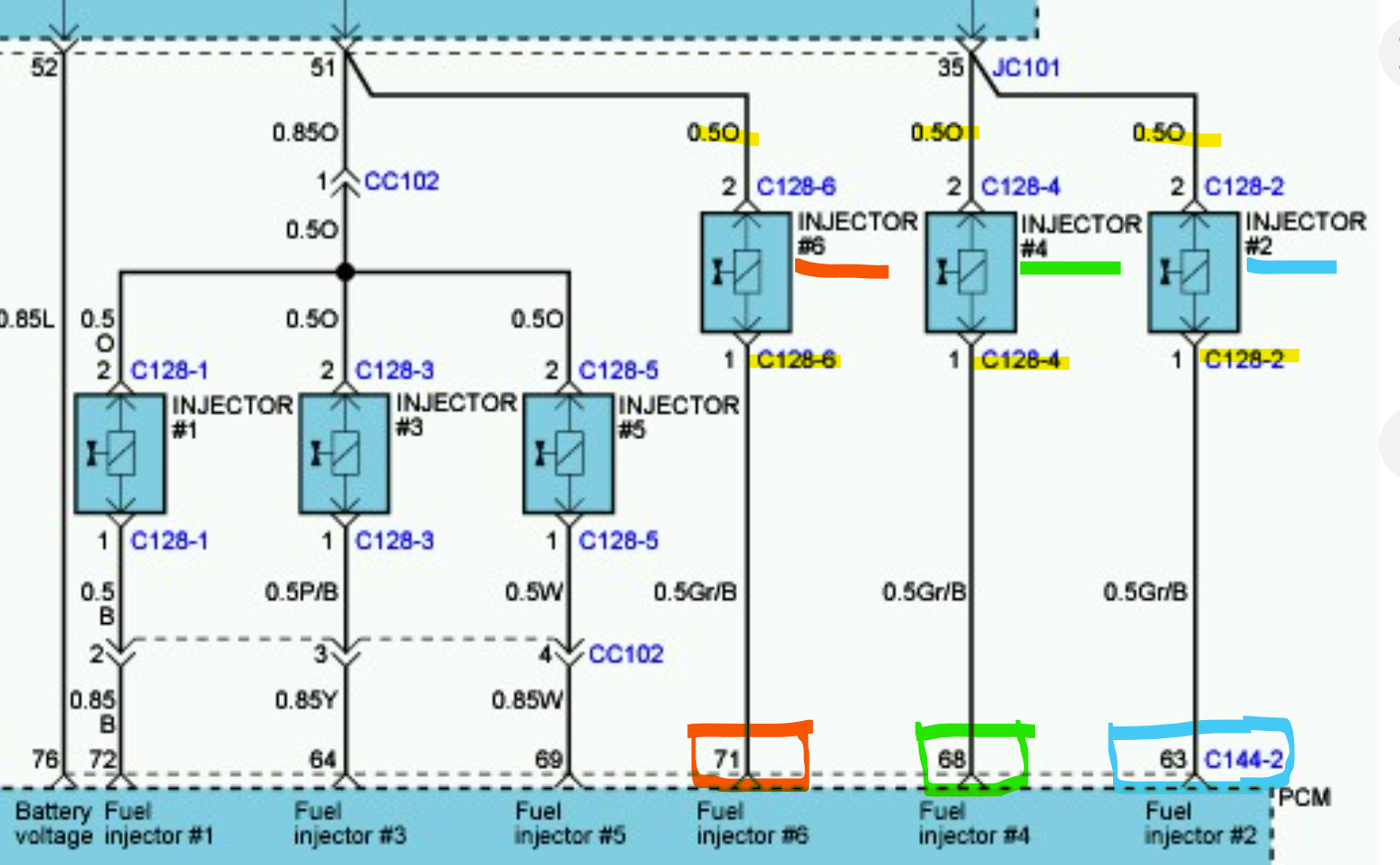

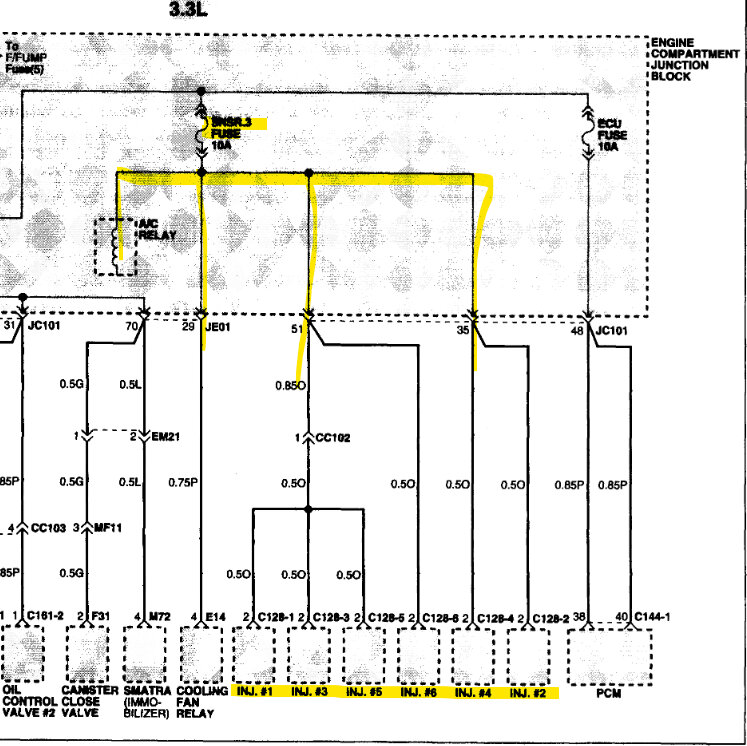

These are the diagrams for the Fuel Injectors, unfortunately it looks like Hyundai did the same thing on the 3 front injectors with the wiring colors. They are all the same, Power feeds look to be orange (will have 12-volts with the key on), and each control wire at ECM looks to be Grey with a Black stripe. So, if you can identify the control wire to each injector by length like you did for the coils, that's what you will have to do here. Or we will have to check continuity from each wire to the ECM connector to Identify each cylinder. Let me know if you need that or if you are ok with these diagrams.

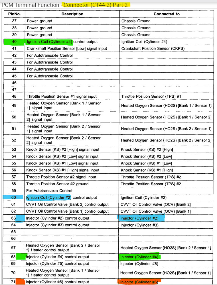

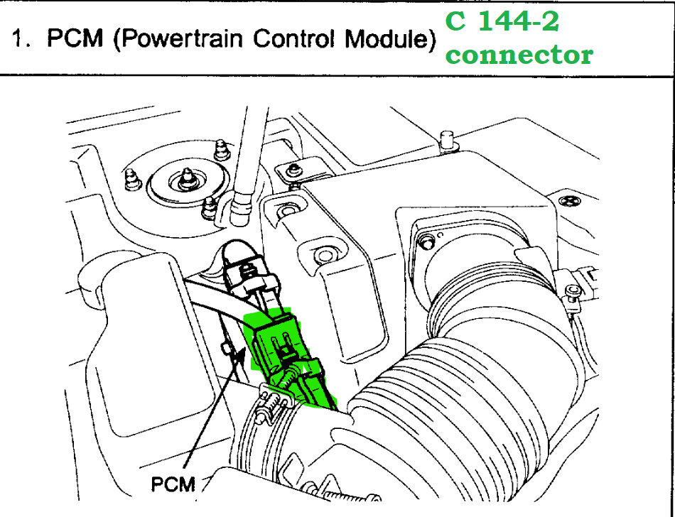

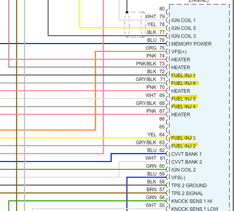

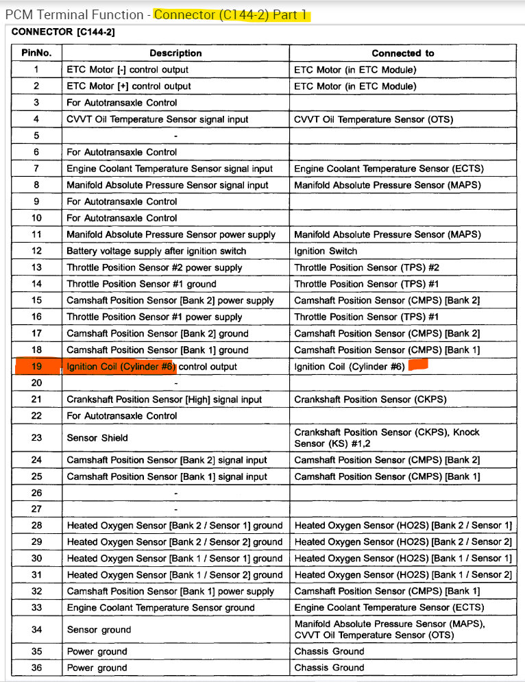

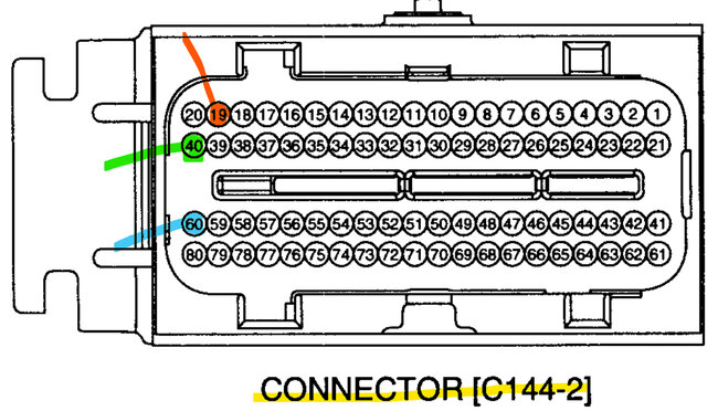

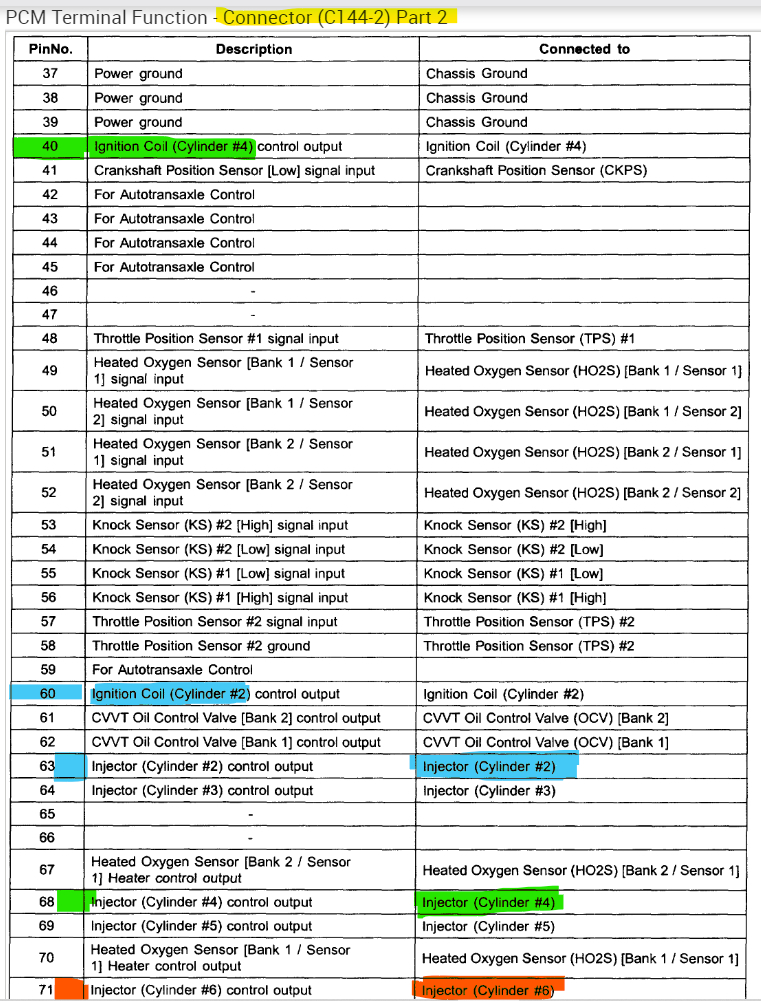

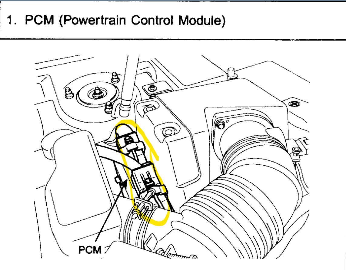

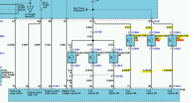

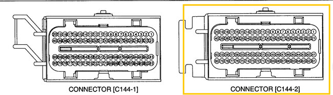

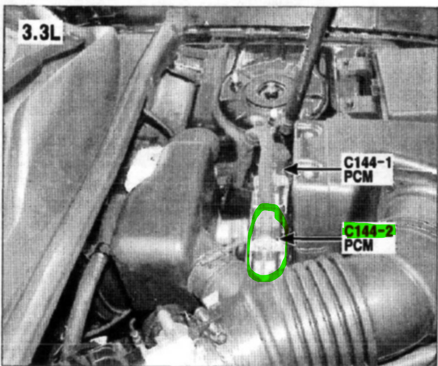

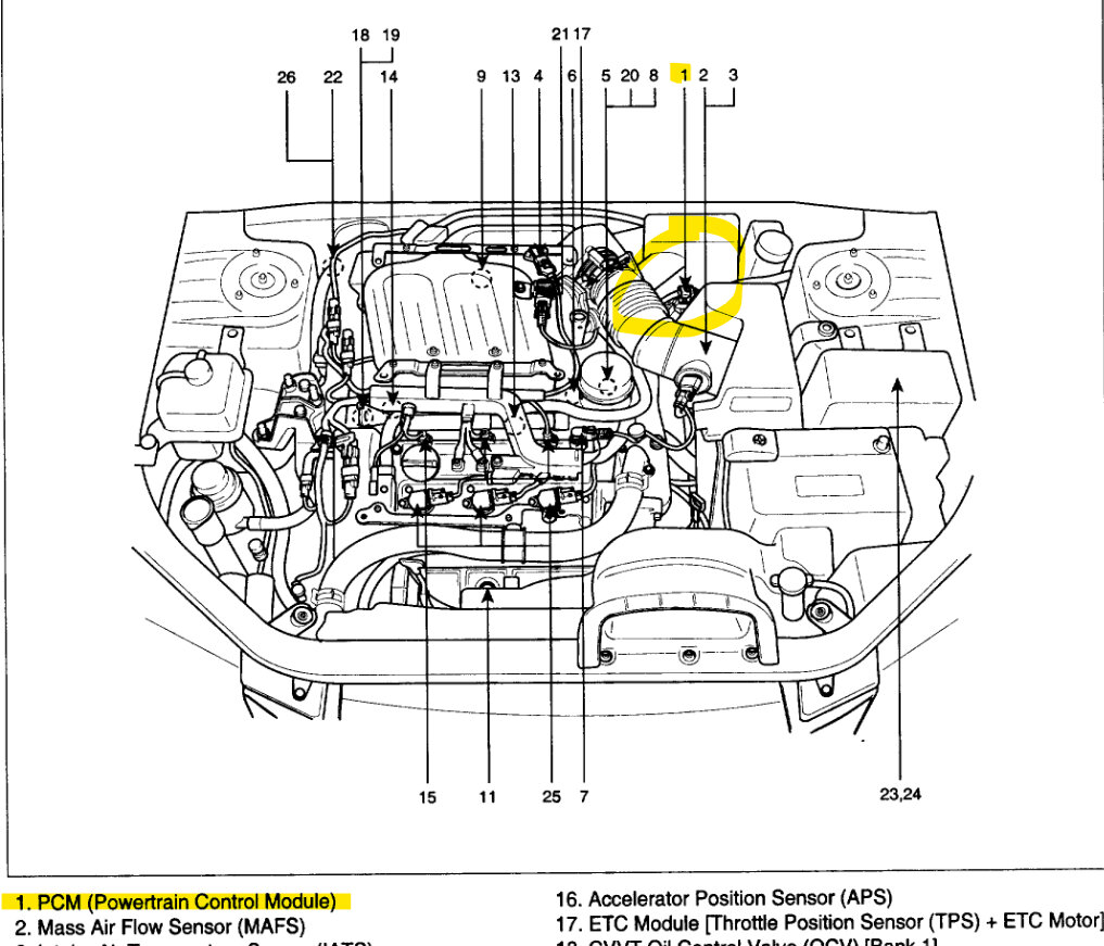

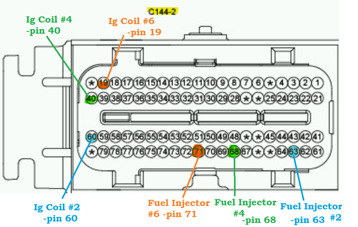

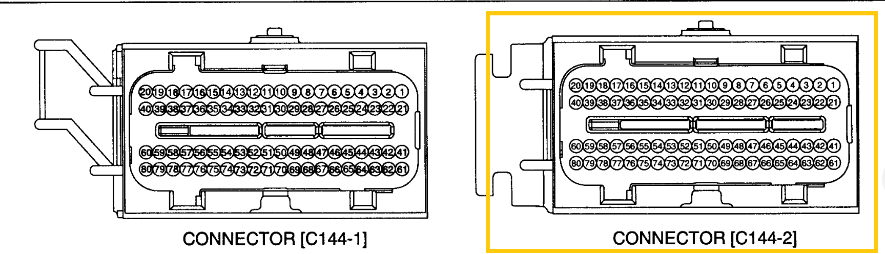

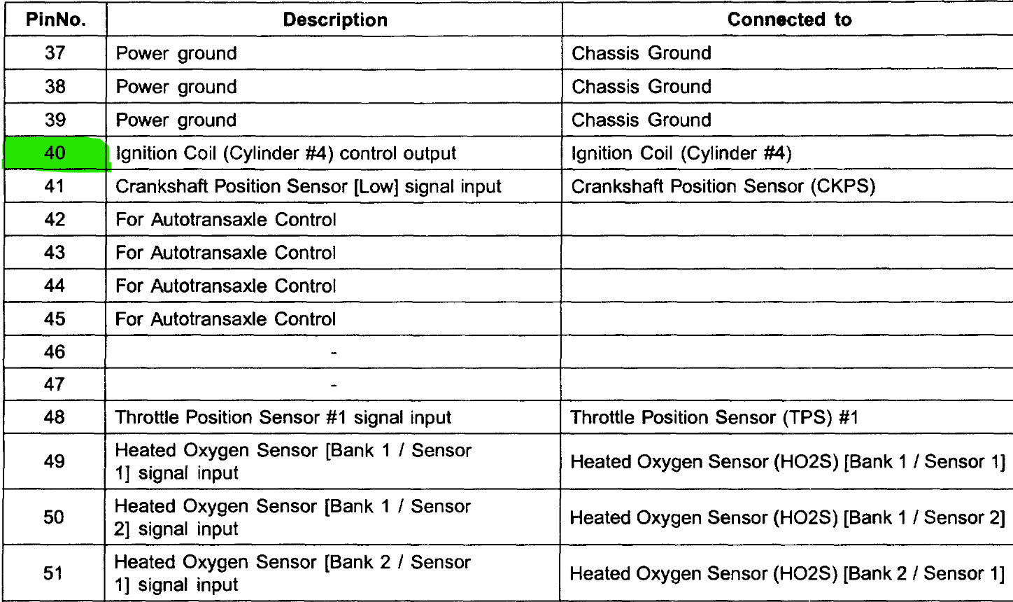

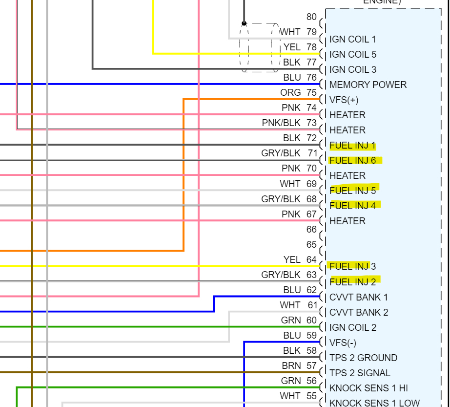

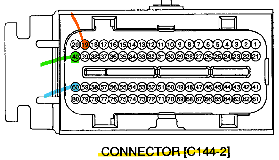

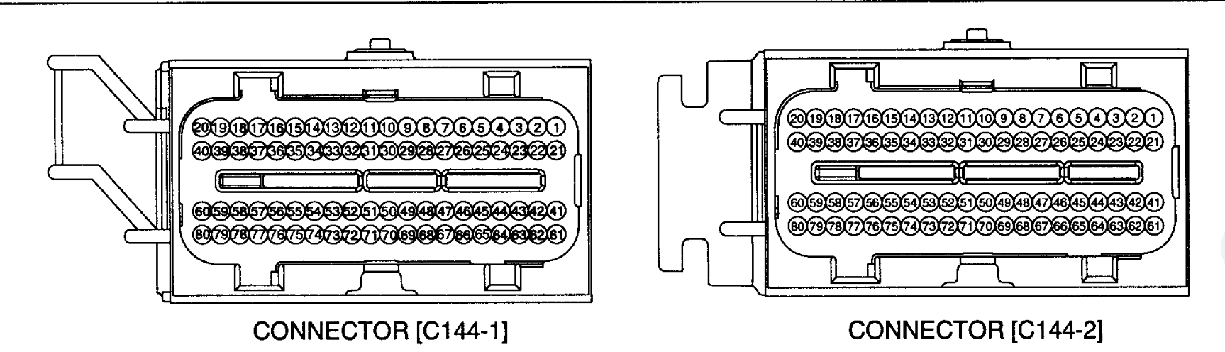

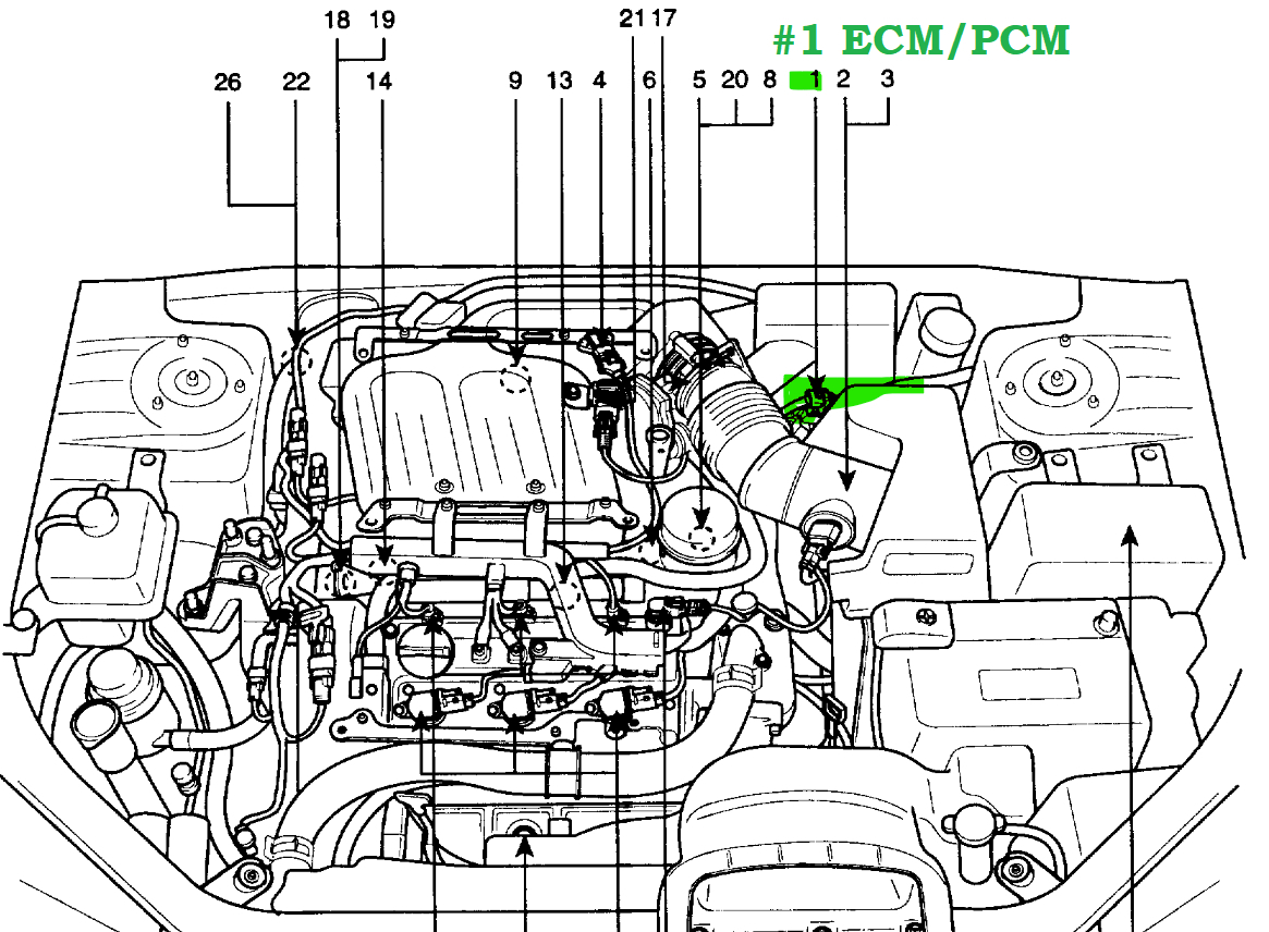

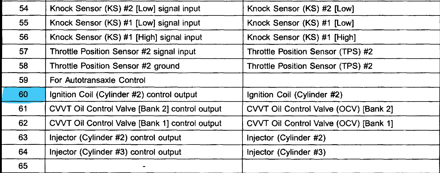

Here are the ECM location and connector C 144-2 which is the connector you'll need to access to Ohm out each control wire. Diagram 6 is the Front Ignition Coils. Diagrams 7,8 are the pinout for C 144-2 ECM connector. Everything is color coded to its front bank cylinders.

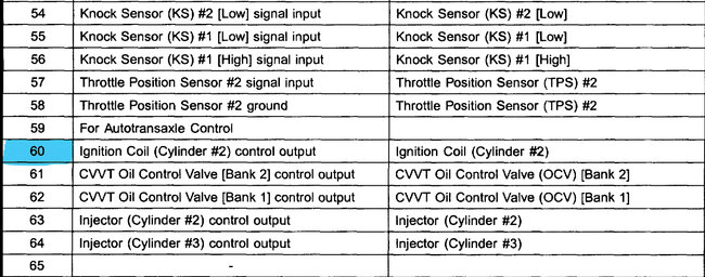

Diagram 10 is the C 144-2 connector with each pin labelled to its component.
Hopefully this is easy enough to see which wires should show continuity to the correct ECM pin.
Diagram 13 is the Fuel Injectors with their corresponding wire to ECM pin, same color coded to each cylinder.
Make sure the key is off before disconnecting the ECM connector. And unplugged before testing. Hopefully this section goes okay for you.

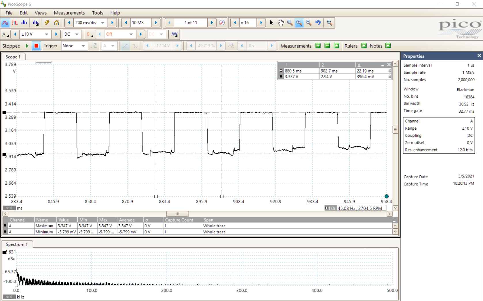

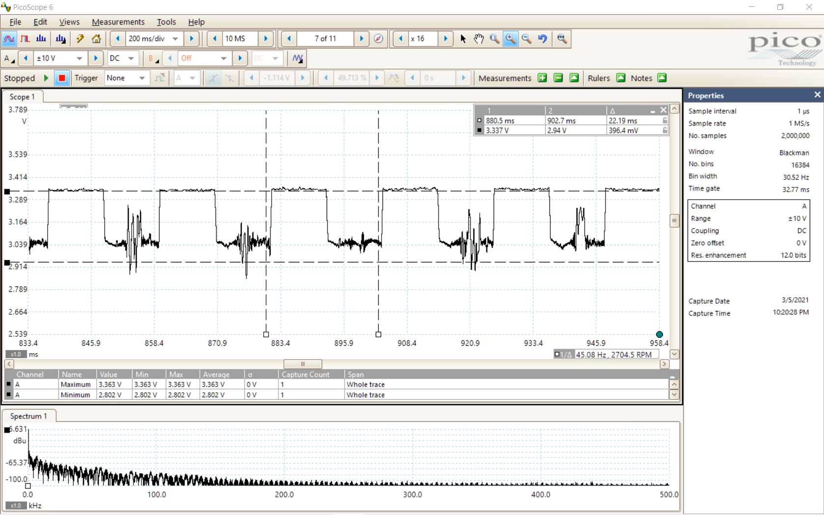

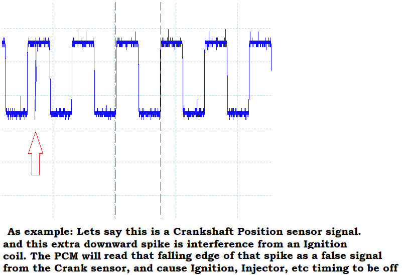

You are talking about the Capacitors that are on the ends of each of the power feeds for the Ignition coils, yes you need them, because of the high voltage the ignition coils make, those capacitors act as a filter of buffer for the voltage, otherwise you will have high frequency interference with other circuits in the vehicle. Any voltage spikes get absorbed by the capacitors and the spikes won't affect other sensors. If sensors such as the vehicle speed sensor, crank position sensor, cam sensors, etc., receive voltage spikes from the ignition coils the ECM will read those spikes as incorrect data from the sensors. Since the ECM watches the rising edge or falling edge of a sensor's voltage square wave signal, any interference will be interpreted as one of those edges the computer reads.
These are some examples of a square wave voltage signal. This is not from an ignition coil, but the same effect applies. Notice in the 2nd scope captures all the interference.
From a computer's standpoint, the spikes in the middle of the pulled down section could possibly be read as a signal, and that's why capacitors are used to filter out and clean up any weird voltage in the circuits. Sorry for the long post, I just wanted to explain why they are there.

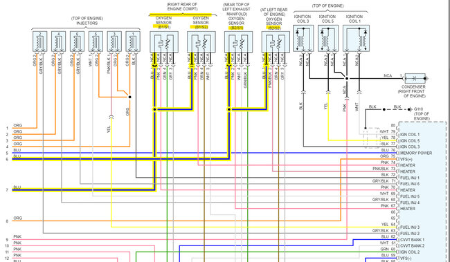

I got everything back together today. I'm pretty confident that all the injectors and coils are in their proper spot. I only had time to try and start the car. I just knew that it would start right up. Well, it turned over but no start. I found that the 19 mini fuse was blown and before I can put another fuse in it blows immediately. I know that this fuse is for the injectors. Fan and Ac according to what I read. I have power to each of the front 3 injectors. I'm going to take the intake plenum off tomorrow and check power on the rear 3. Any ideas that you may have are welcomed. Thanks
Jun 21, 2023 at 2:15 PM
AL514
  • 5,675 POSTS

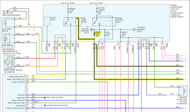

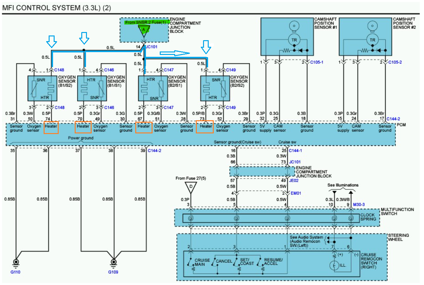

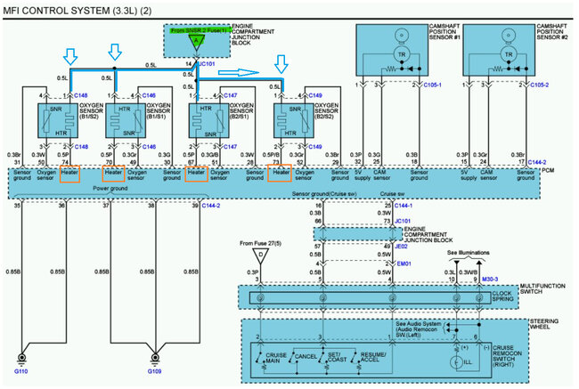

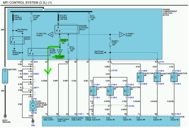

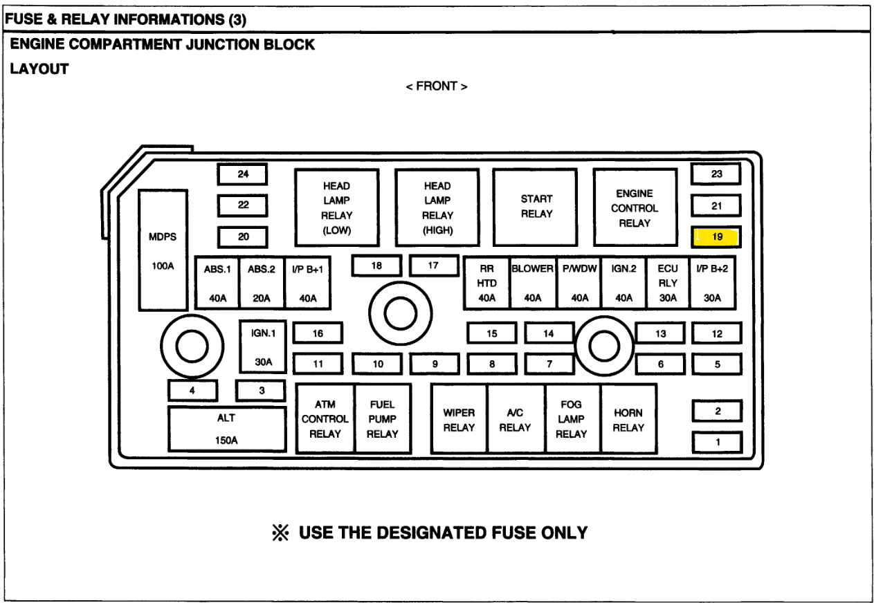

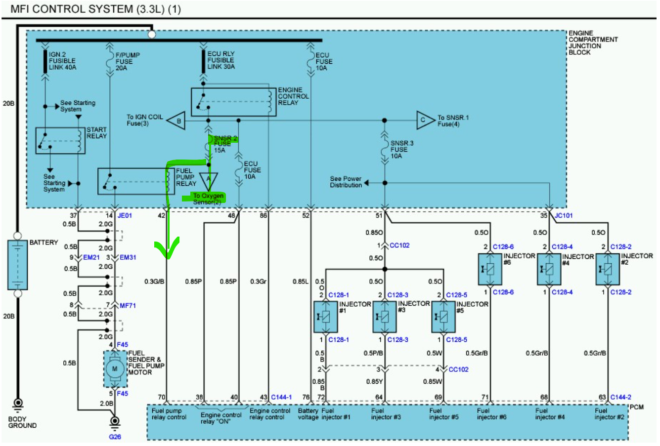

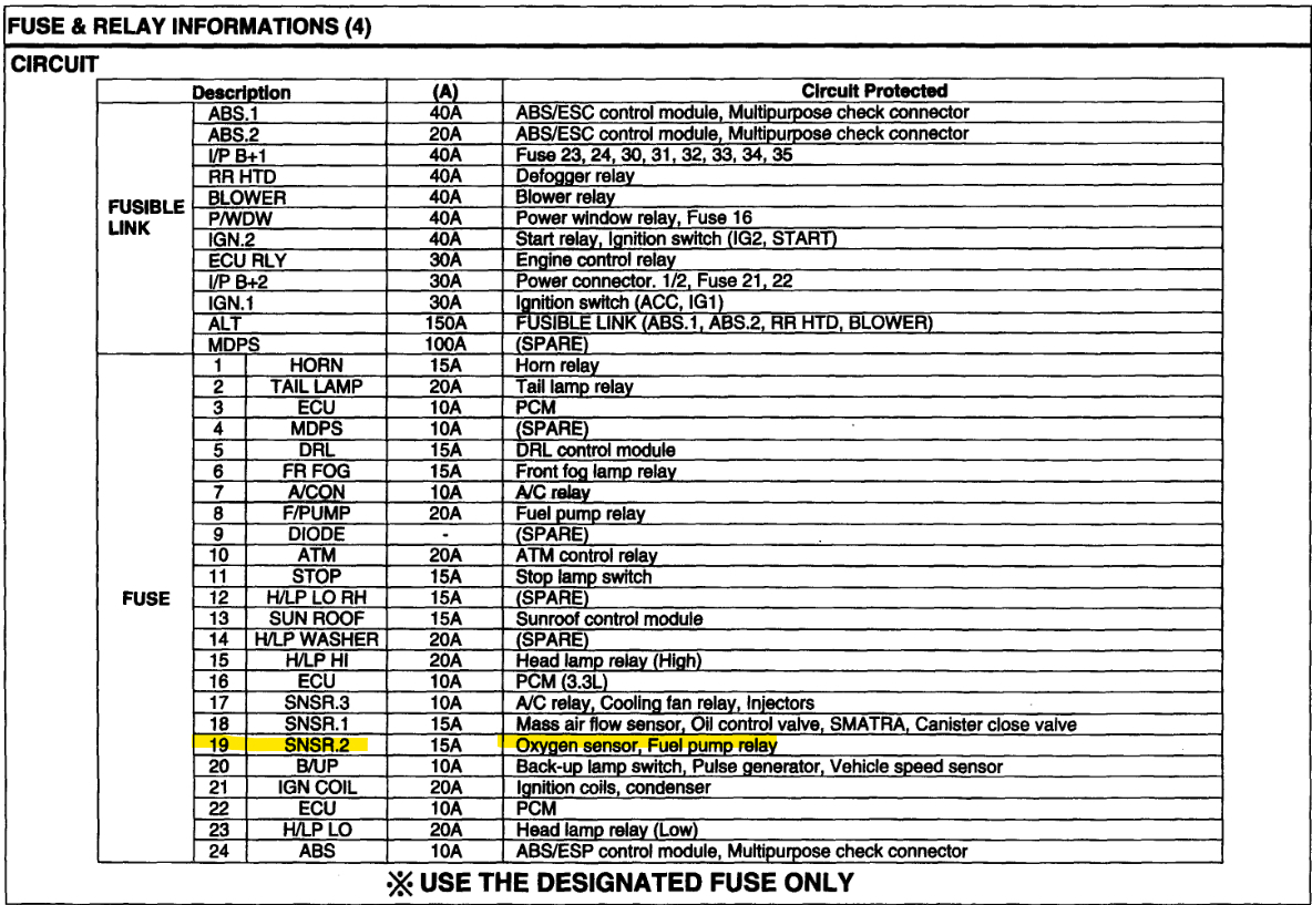

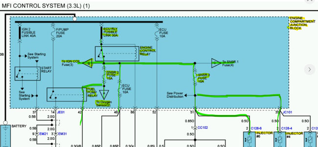

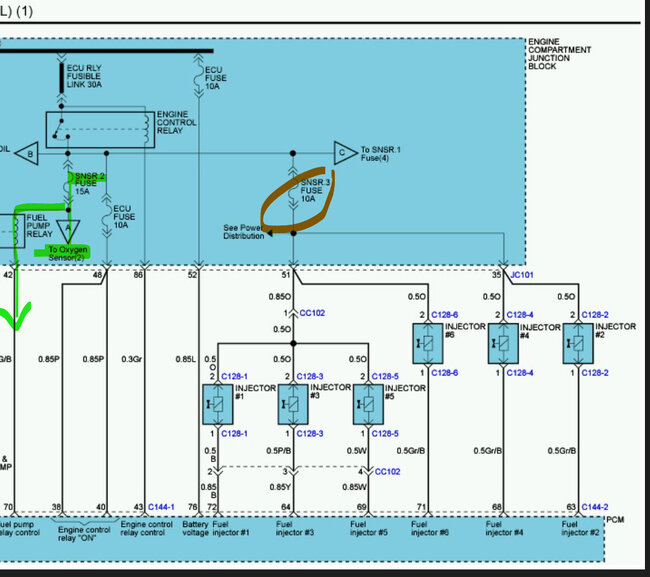

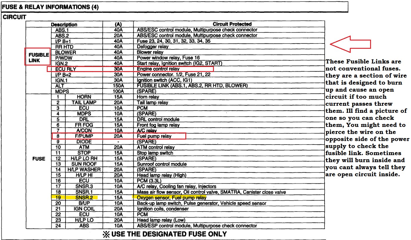

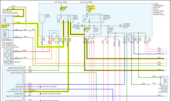

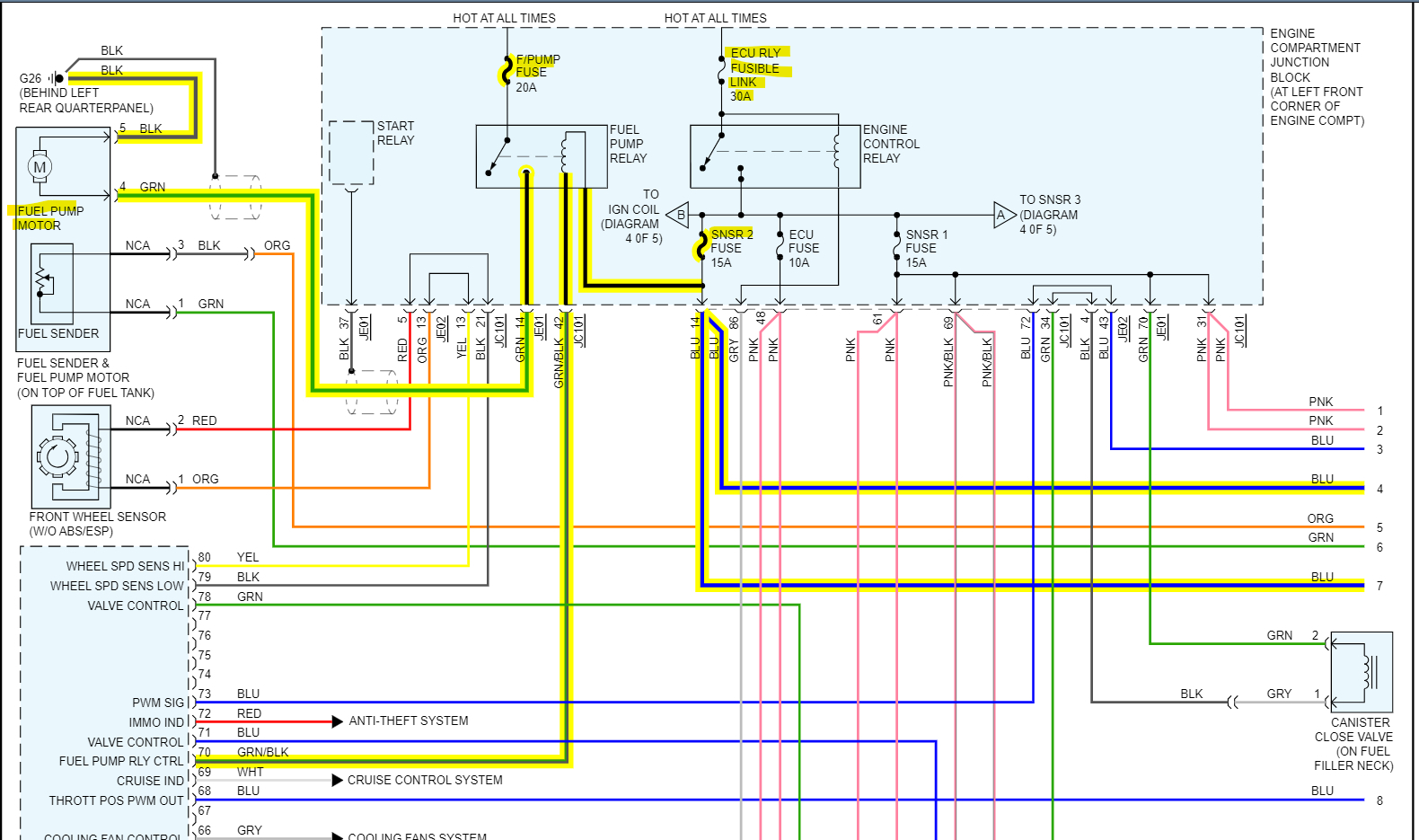

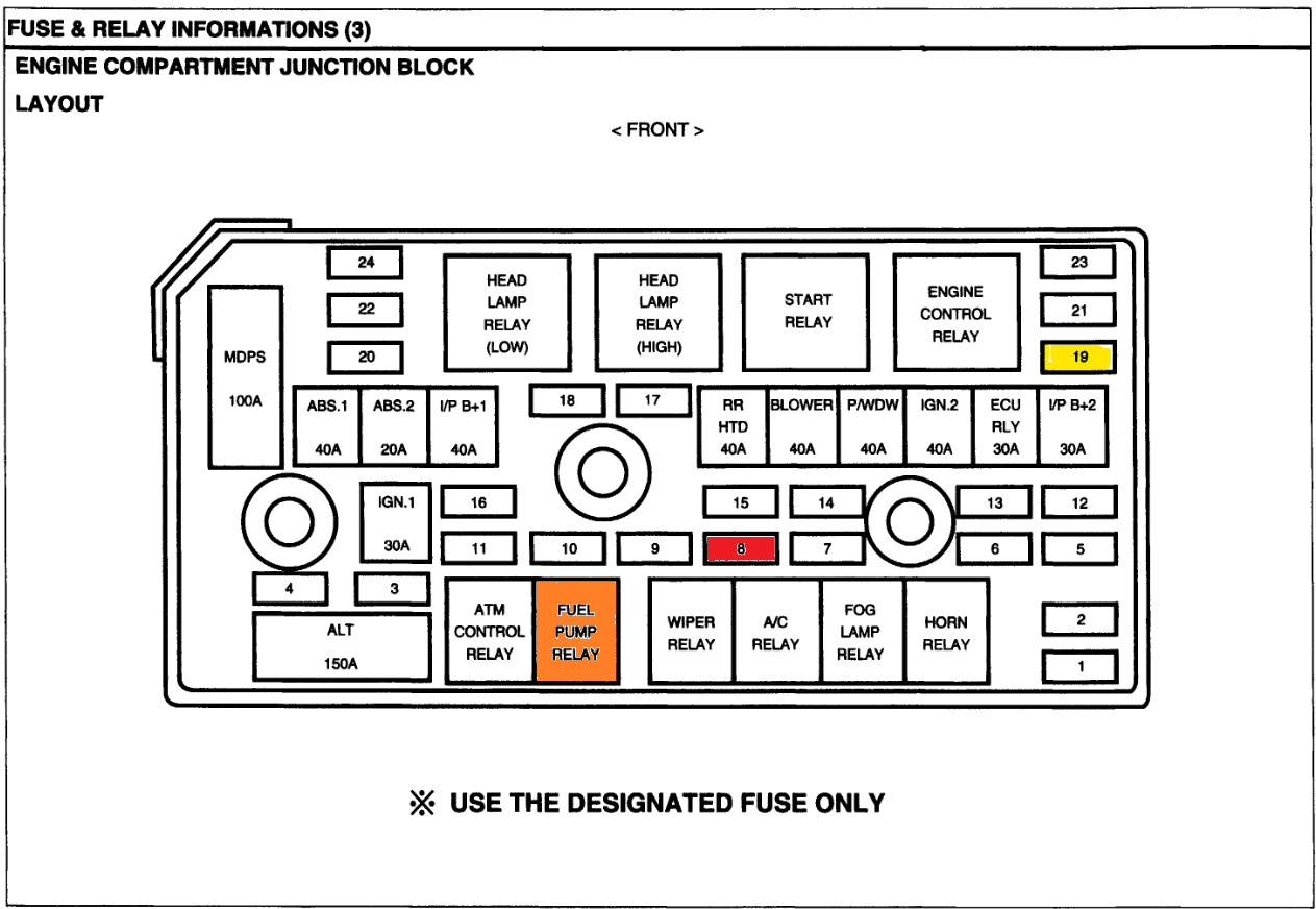

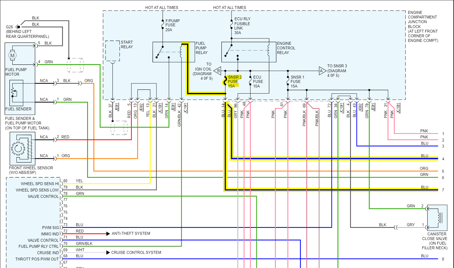

Where is this Fuse 19 located? In the engine compartment fuse box? And does it have any other label than 19? and what amperage is it? I don't see any fuses with that label going to the injectors, the injector fuse is the SNSR 3 Fuse 10amp feeding the injectors,
The fuse panel in the engine compartment has Fuse 19 (15amp) Oxygen sensor, Fuel Pump Relay
This is the Fuse 19 circuit, its label is SNSR 2 15amp, and it feeds the Fuel pump relay control side, but also feeds the Heater circuits for all 4 Oxygen sensors. So, I think you have another circuit that is either been chewed on, or there is a shorted heater circuit in one of the oxygen sensors,
You can test this really quickly by unplugging all 4 oxygen sensors and seeing if the fuse still pops. If so then there is most likely another wire that has been chewed under the fuse block in the engine compartment, it should be a blue wire coming from the fuse block going out to the oxygen sensors.
Jun 22, 2023 at 7:23 AM
TIMOTHY WAYNE DAVIS
  • 24 POSTS
Yes, you are correct. I read the label wrong. Will get back soon going to test now. So am I right to assume that if the fuel pump relay is involved then I'm not getting gas to injectors. That's exactly what it sounds like to me is no fuel.
Jun 22, 2023 at 9:56 AM
AL514
  • 5,675 POSTS
If that fuse is blowing, yes, it's the power supply to the control side of the relay, the ECM grounds the other side to activate the relay, so that's why you don't have any fuel pressure.
What you can do if you don't find a chewed wire, is pull the fuel pump relay out for now, unplug all the oxygen sensors. And using a test light at the fuse location, hook the test light to battery negative and find out which side of the fuse is the power feed side, and the other side goes out to the oxygen sensors. Once you know which fuse pin is the power, then you can hook the test light to battery positive and touch the other fuse pin, the side that is shorted to ground. The test light should now light up because of the short. With the oxygen sensors unplugged, the only path to ground now is the shorted wire. So, you can do a wiggle test and find the short much faster this way, I can draw up a quick diagram of this test if you want it. Or you can use a multimeter hooked to battery negative with the fuse out and do the same test, it's just much easier to watch the test light flicker when you move the wiring harness near the short.

I unplugged al 4 oxygen sensors and inspected the wiring. There were no obvious chews or breaks in the wiring. It all had that black insulating electrical tape still wrapped around it from the factory. I didn't see anything that would make me feel there was a problem. The fuse quit blowing when I unplugged the fourth sensor. It' sounds like it's wanting to start but so far, no luck. I pulled out a couple plugs and they all had a strong smell of gas and looked to be fouled. So apparently, I'm getting fuel. Now. wouldn't you think that the car would try to start even with fouled plugs? I got some extra coil packs, but I think I'm going to go buy a set of plugs. Would it make a difference if I got the injector and coil power leads mixed up? They are very close to being the same color. All of the other fuses are working properly. I'm pretty much stuck. I'm trying hard not to use the process of elimination to fix what is wrong. I did pull the fuse box out when I was considering buying a new harness so it is possible that I could have caused a problem, but it went back together with no issues and everything else is working asp far as I can tell. Any suggestions are welcomed, and I will be standing by. Thanks for your time and patience.

If the last Oxygen sensor (4th) caused the fuse to stop blowing, you should check the resistance of the heater circuit internal to that sensor. I'm not sure which one you mean by 4th, but if the heater internal to the sensor shorted out, it will blow that fuse. Have you replaced the fuse with leaving that oxygen sensor unplugged and it still will not start? I know the chance of the Oxygen sensor heater being shorted out after all this does sound like a fair chance, but I have seen stranger things happen.
As for the power feeds to the coils and injectors, that shouldn't matter, but the control wires will matter. If the plugs are wet and fouled out with fuel, the injectors are working, the question is do you have spark.
So, we can have you check that oxygen sensor that you unplugged for a short, either in the sensor or in the harness with a test light. If you want to do that let me know,
But if you're going to test for spark at each coil, I think you should unplug the Injectors, so the cylinders don't get washed out with any more fuel. You can pull the SNSR 3 fuse 10amp which powers the injectors or unplug each one.

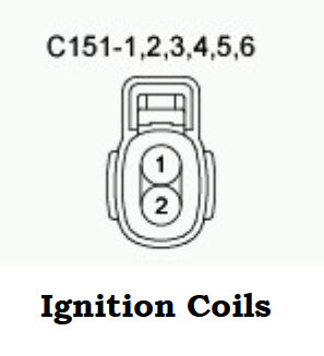

Well, each coil has 2 wires on each connector, looking at the engine from the front of the vehicle cylinder 2 is on your left and cylinder 6 on your right, 4 in the middle. And you should be able to identify the power wire by just turning the key on and check it with a multimeter with the other meter lead on battery negative. Only 1 wire on each coil will have 12volts, the other wire is the control wire. Pin 1 is the power feed; the original wires would have been pink.
Same with the Injectors, one wire should have 12 volts with the key On. Pin 2, orange wire was the original power feed color for the injectors. But verify them with a multimeter to be sure they are correct. You may have not fried the ECM drivers since you still had a load in the electrical circuit. The coil or injector would be a load in the circuit. How the Oxygen sensor shorted out, that is to be seen yet.

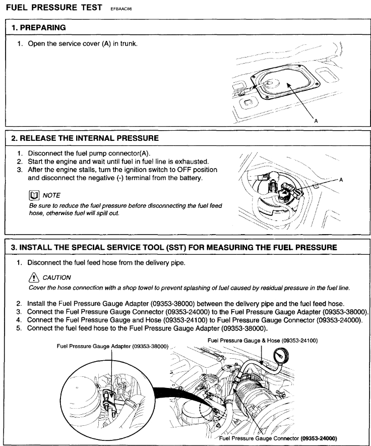

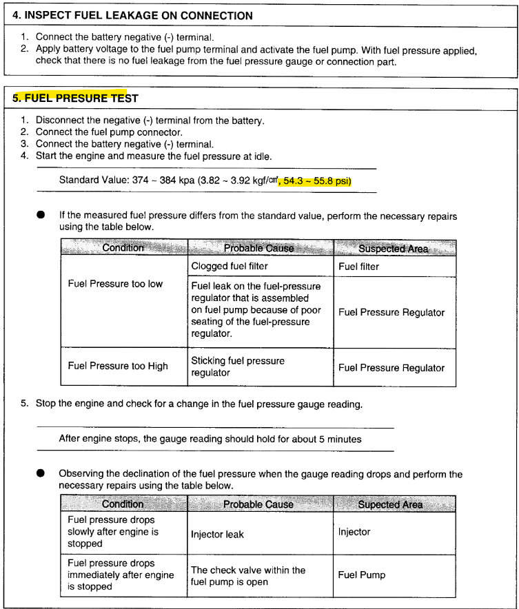

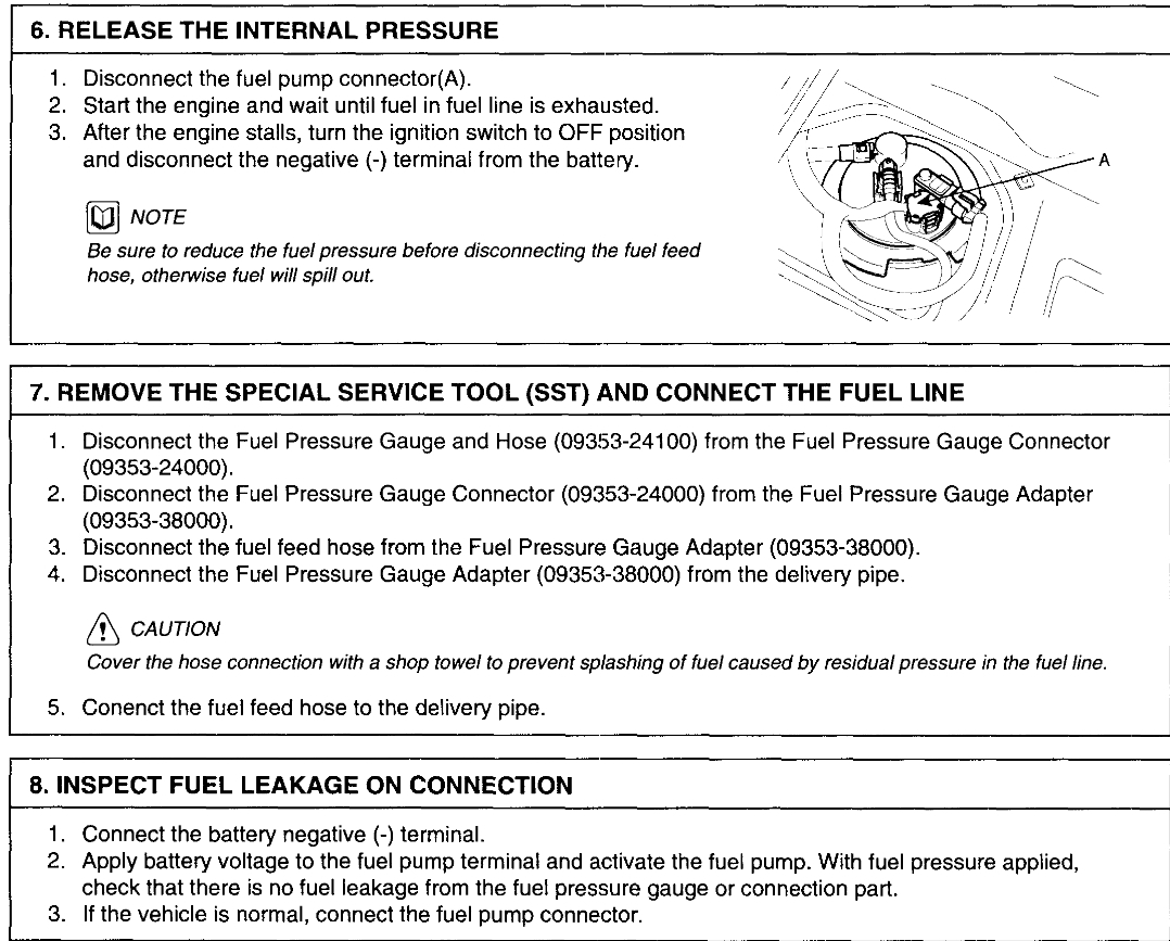

As for fuel pressure it looks like there is an access panel in the trunk, I'll put the instructions for a fuel pressure test, although with this fuel pump relay being on the same circuit that was blowing the oxygen sensor fuse, you should check the rest of the fuses in the engine compartment fuse block, since we don't know yet what is causing that fuse to pop. To do this fuel pressure test you have to T into the line, but when you turn the key to just the on position you should hear the fuel pump run for a couple of seconds to prime the system. Maybe have the trunk open and get to the access panel and have someone else turn the key On and see if you hear the pump, from the top of the access panel you should hear the pump with no problem, they are pretty loud. It looks to be under the carpet in the trunk area. I will see if I can locate what number this F/PUMP fuse 20amp is in the fuse block. I'm wondering if there are more chewed wires, it sounds like the rodent really went to town on the wiring harness.
Fuse #8 is the Fuel pump fuse that feeds the load side of the Fuel pump relay
Ok in diagram 7 are the fusible links, I'm not sure why they call them fusible links because this is not the conventional style fusible link at all. But I also don't know why they colored all the wires the same color either, seems like anything goes with Hyundai in this case.

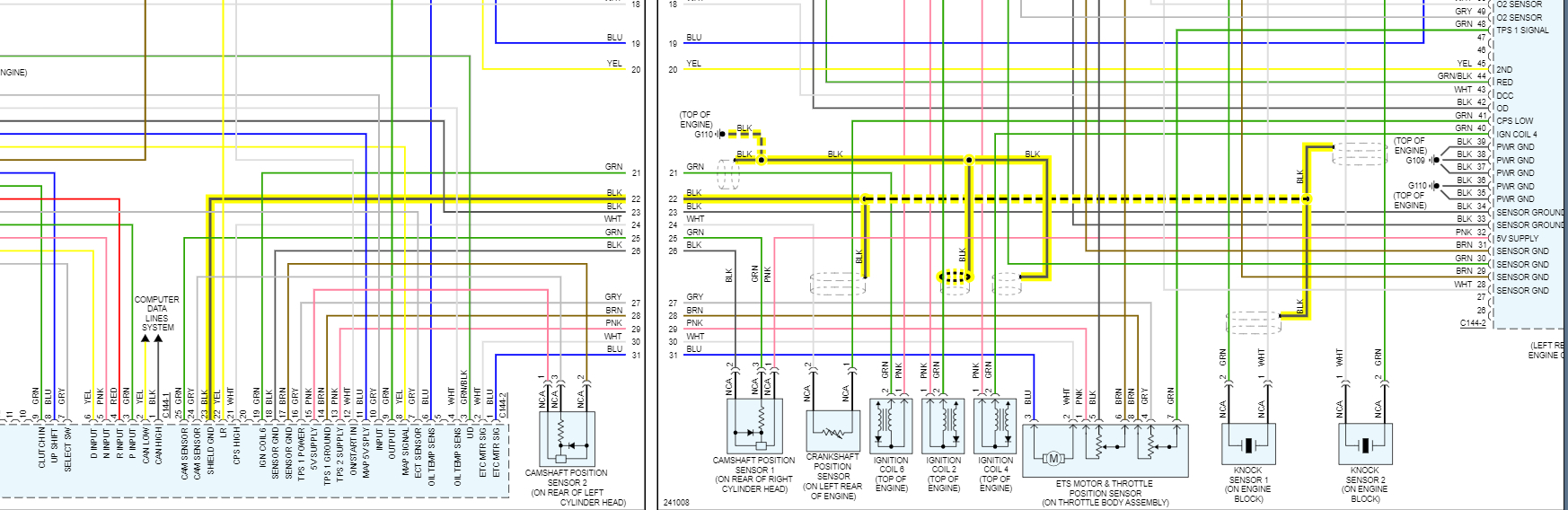

Are you missing spark at the back 3 coils and also the front 3 at the same time? Unfortunately, the power feed for the coils, the injectors, oxygen sensor heaters, and fuel pump relay all come through the ECU RLY Fusible Link 30amp. Then through the Engine Control Relay, and then branch off from there. So, you might want to check more around that fuse panel, If the harness is wrapped up in conduit and taped up, I don't think you'll find chewed wires inside there, I guess depending on the rodent size, but they will usually chew up the entire thing. I need to restart my page here, having some technical issues.
So, depending on if you're missing power on the back coils or control, it will direct where you look next, being that the PCM is located next to the Air intake tube and air filter box, you might want to just pull all that out of the way. Looks like the PCM harness runs under the air tube, and since you have no spark back there, I'd be concerned with hydro locking those back cylinders and having to pull that intake off so many times, you probably just want to go through the entire engine harness. Checking the engine and chassis grounds. These Grounds in the 2nd diagram 109, 110 all go to the PCM, there is 5 there, all Black wires. If the rear coils wires are still there, then there is most likely going to be issues from that engine Junction Block (fuse block) to the PCM. The wiring in this vehicle is so different from the rear to the front of the engine.

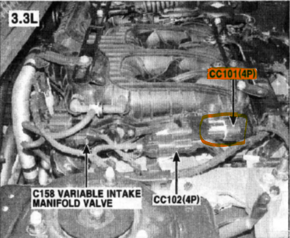

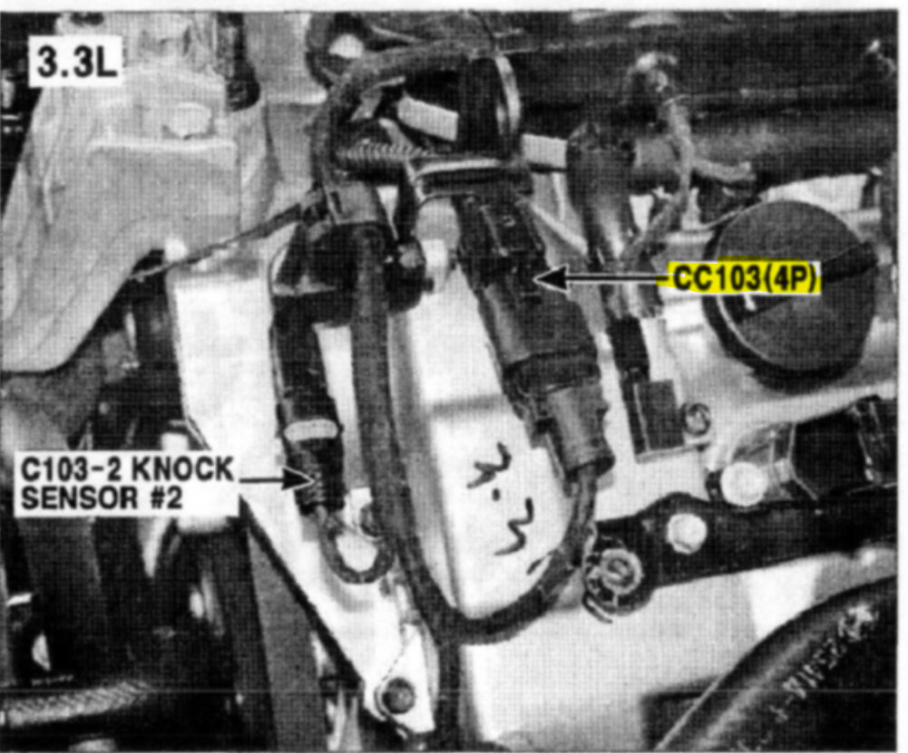

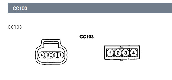

The back 3 coils run through a bulk connector CC101 for the control wires and a single power wire. Whereas the front coils have no connectors at all in series.
The CC101 is supposed to be a 4pin connector that feeds power to the rear coils on Pin 1 Pink Wire and the other 3 pins are the control wires for those coils. Should be White, Black and Yellow wires.
The CC102 bulk connector feeds the rear injectors. So, you could even just unplug that CC101 and check for resistance from the pink wire, to each of the other 3 wires one at a time, and you should be measuring the resistance of each rear coil, instead of having to pull the intake, then if anything is missing, you'll know what wires you're chasing.

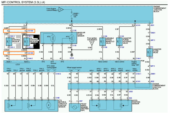

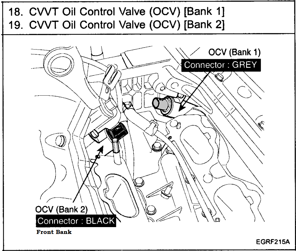

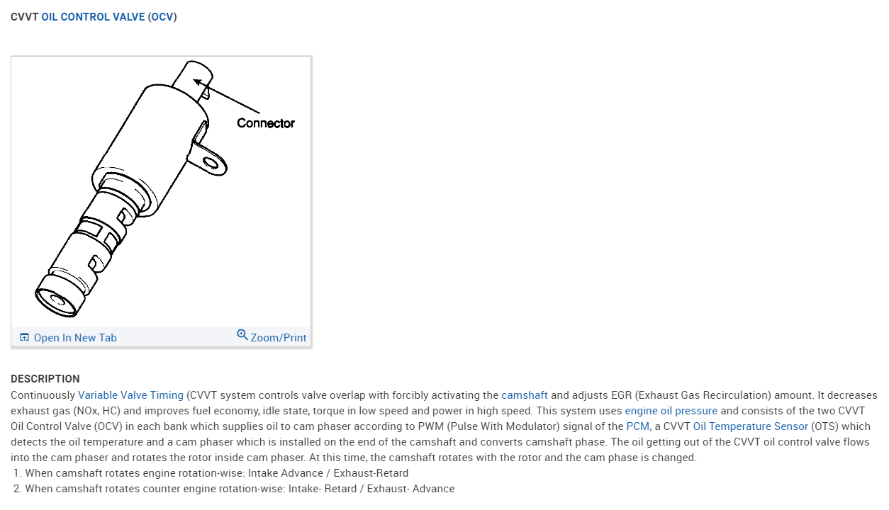

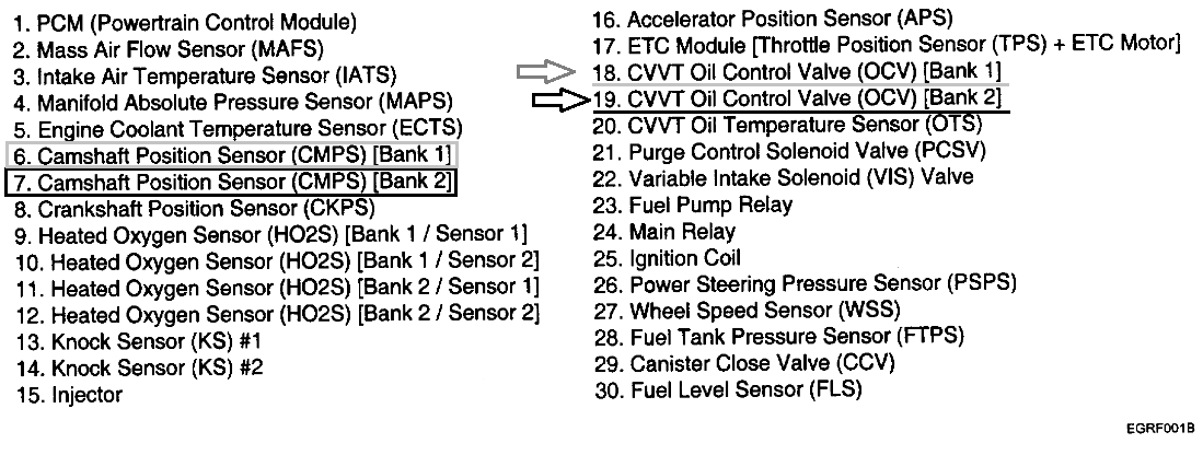

There are also wires going to the oil control valves on each cylinder head that are for controlling the variable valve timing, and of course on both cylinder heads they are a pink wire and a white wire, on the left cylinder head, which I believe is the front head, the white wire changes over to blue at Connector CC103, all 4 wires for the VVT control valves run through the CC103, I found CC103, the C105-1,2 connectors are right at each cam sensor.

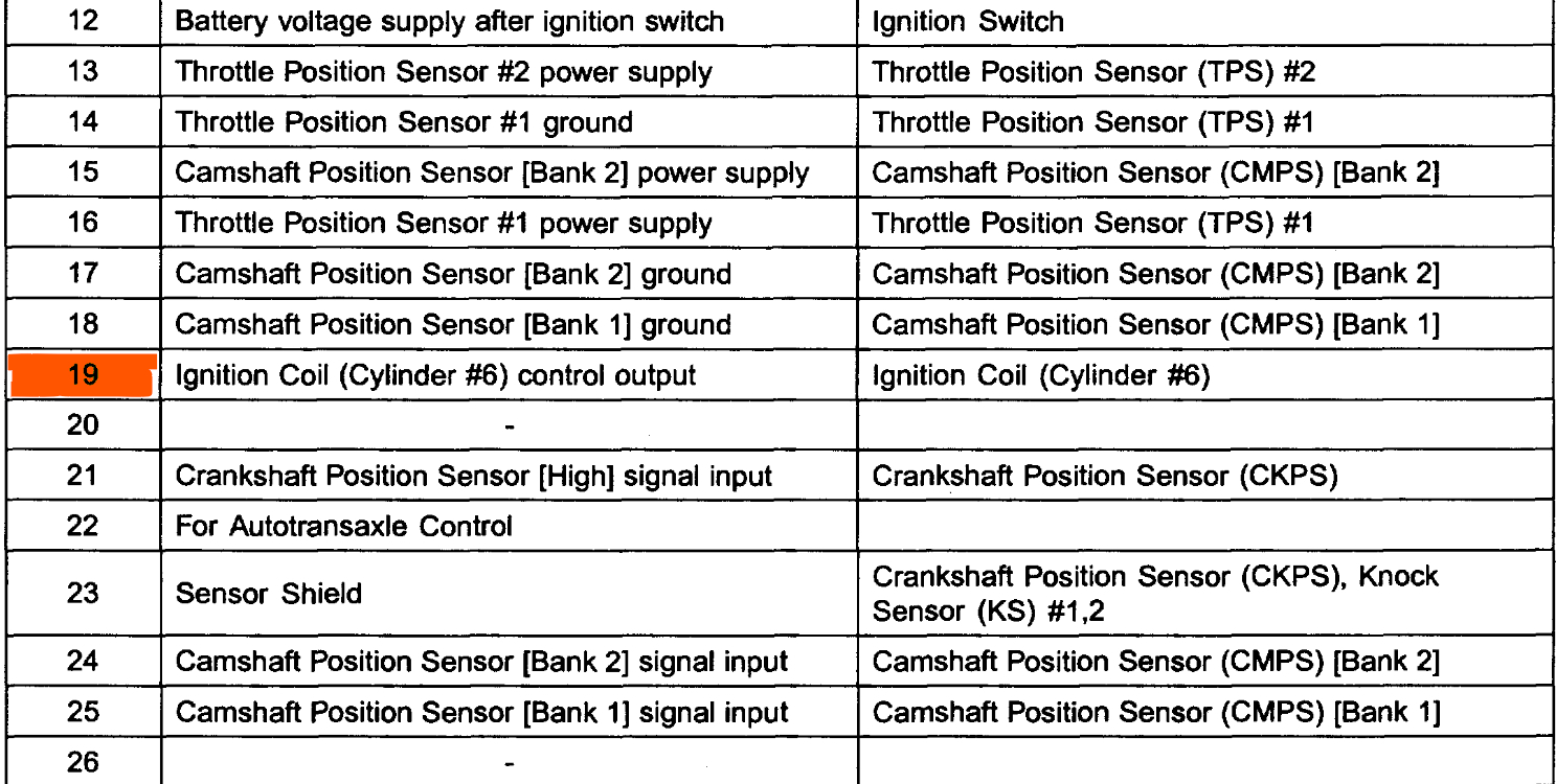

I looked back over your posts and 5 posts up where you were mentioning Fuse 19 and that #6 coil getting hot, you said you saw a puff of smoke. Where was that coming from? Fuse 19 or the #6 coil. I'm wondering if that burnt something inside the PCM. The #6 coil control wire pins out of the PCM right next to the Cam sensor pins as well as the TPS power feed. Scan it again for codes and let me see all of them. These coils don't have any protection from a short circuit, if a coil was getting that hot, that means there was a lot of current flow. You said you spliced the shield wire to the coil wire? The shield wire is meant to just cover over the ignition coil wire, not be connected to it in any way at all. It's a shield wire that runs directly to ground through a PCM pin ground. It's only for Radio Frequency interference from the ignition coils so they don't feed back into other sensor signals, which might be why the coil got so hot, there was current flow running directly to ground through the PCM. Was the shielded wire spliced into the coil control wire or power feed to the coil? But even if the #6 coil driver is burned out, the car should still start,
Now if the black shield wire is in any way spliced into anything, any coils, or injectors, that will cause and issue with the crank and cam sensors, those sensors use the same black shield wire over them to prevent interference from the ignition coils or injectors. Mostly the coils, if the coils are firing and any high voltage spikes are running through that shielded wire, it will absolutely interfere with the crankshaft or camshaft position signal. The 2nd diagram is my crude illustration of interference on a crankshaft position sensor signal from an ignition coil. Again, sorry for the long post.
