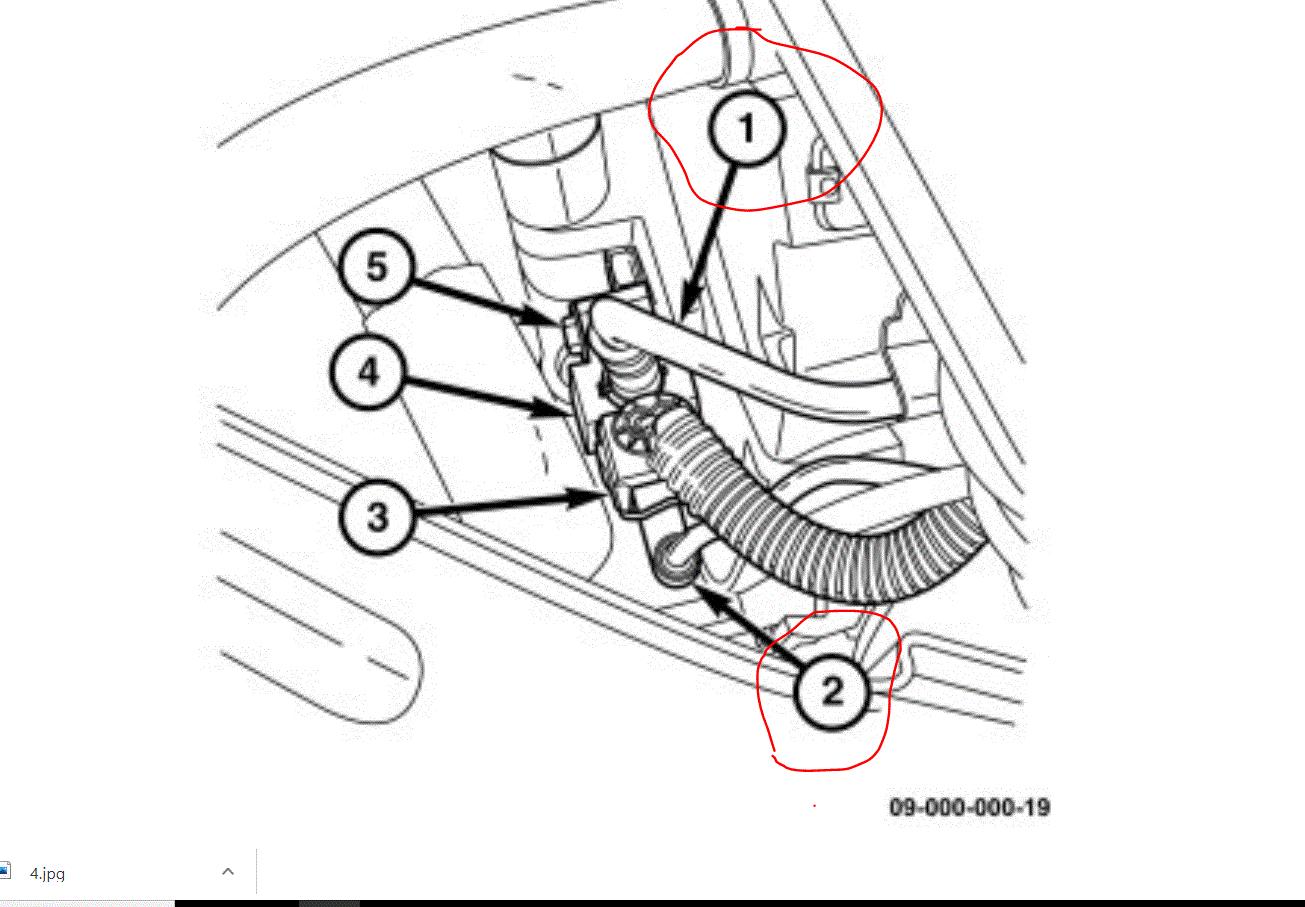

How can I check the turbo gate to see if there is any damage?
Friday, October 2nd, 2020 AT 7:29 PM
  • 109,772 POSTS
Naser,
I'm not sure I understand what you mean by gate. What harness has been cut and spliced?
Sunday, October 4th, 2020 AT 4:56 PM
NASER NASER
  • 836 POSTS
No harness was cut. I just cut the plastic protector round the harness of the PCM when I was checking the wires, and I think they thought someone spliced it or patched it. The turbo waste gate.
Sunday, October 4th, 2020 AT 5:28 PM
  • 109,772 POSTS
Naser, the only thing I have is wastegate solenoid removal and replacement.
I attached a pic of the solenoid below which should be mounted to the timing cover. Number 1 (wastegate hoses) number 2 (vacuum supply).
That's all I have related to the wastegate. Make sure there aren't any vacuum leaks.
Sunday, October 4th, 2020 AT 7:44 PM
