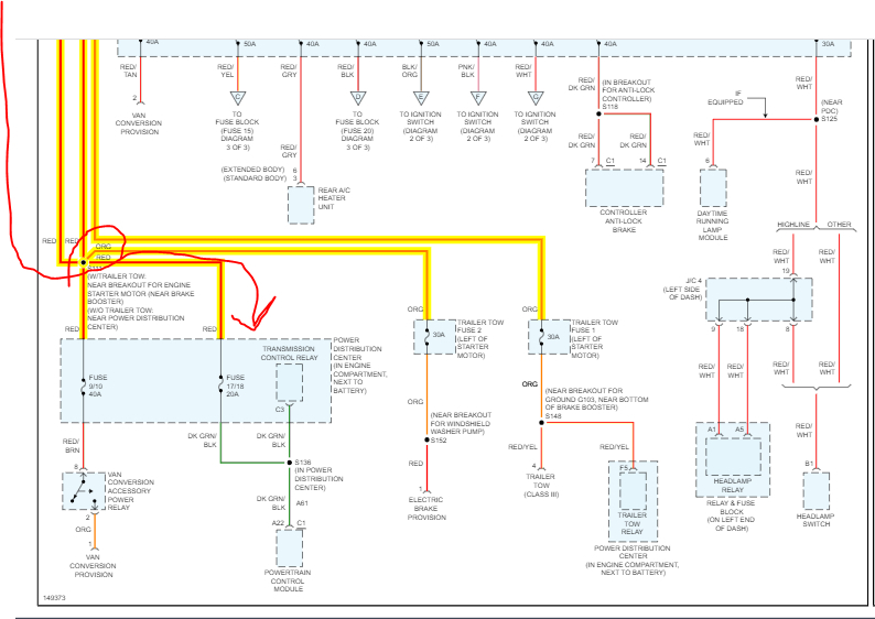

On my fuse block under the hood has a 20-amp fuse to transmission relay when tested from ground to fuse there is nothing. When I test positive to fuse it shows green on my digital volt tester. does this mean a bad wire or what senser would be bad?

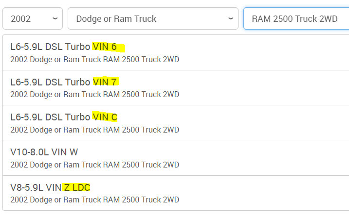

Let me know that and also, I am showing four possible engine code numbers for the 5.9L. Three of the four are diesel and one is a gas engine. I need to know what the 8th digit is in the VIN number on your truck so I can make sure to be reviewing the correct wiring schematics. See pic below.
Also, please confirm the codes you have. Are they P codes?

I checked with the key in the on position. It's a dim green on the firewall side and bright green on the front side of the fuse. the letter in my VIN is z the codes are from the self diagnostic I did, and the codes show on my odometer.

  • 110,194 POSTS

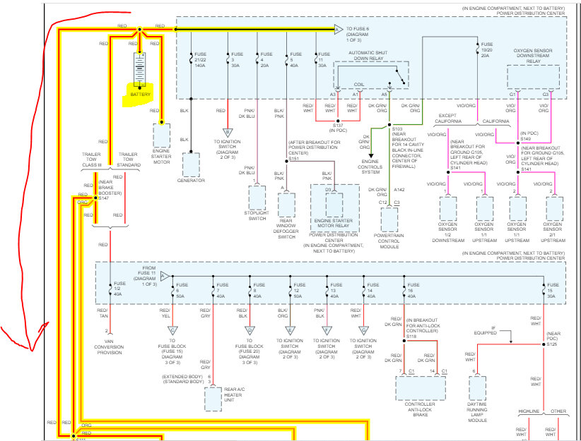

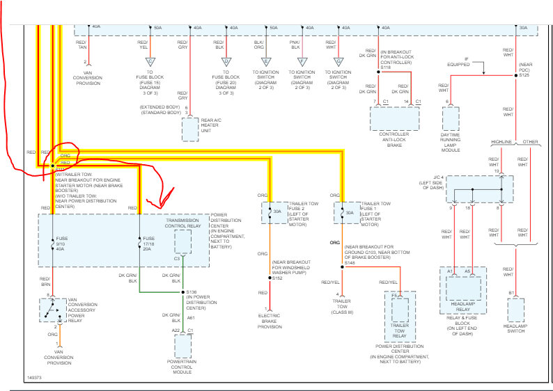

The fuse should have power at all times. There is a splice in the power supply near the power brake booster.
The power supply to that fuse comes direct from the battery. The only thing between the battery and the fuse is a wire splice. See pic below.
I need you to locate the red wire for that fuse and check if power is present at the wire. If there isn't, trace it back to the splice and check for power there.
Let me know what you find. Also, I am looking at the schematic for a Ram 1500 Van. Let me know if that isn't correct.

  • 110,194 POSTS
Don, I looked up the 3500 and it has the same schematic. That tells me there is an open in the power supply to the fuse or the fuse box is bad.
It is only a theory, but I suspect the problem is going to be at the wire splice I mentioned. Are you comfortable locating and checking it?

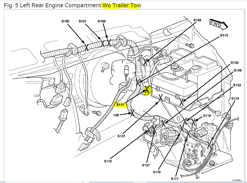

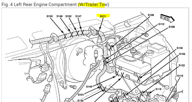

Where exactly is the splice?
Jul 1, 2023 at 10:31 PM
  • 110,194 POSTS

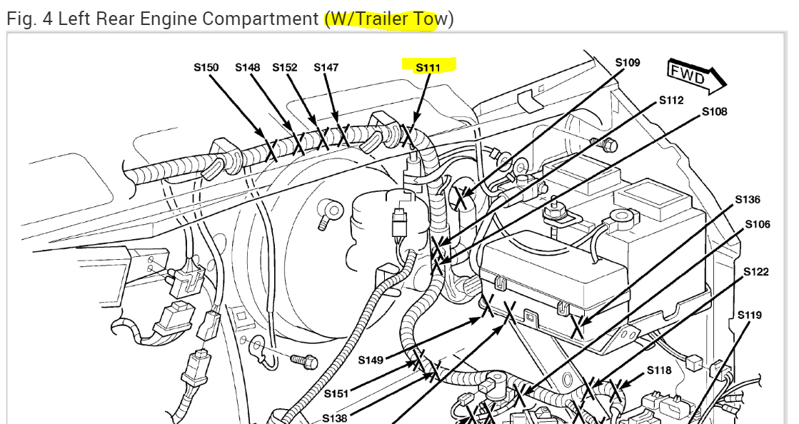

I dug into it a little deeper. It is splice 111. It can be in one of two places based on if the vehicle has a factory trailer tow package or not.
See pics below and let me know if it helps.
