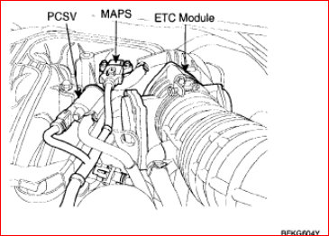

My daughter was driving and every thing shut down.I check and found these codes I seen several reasons why the P2106 would set would low oil set this code I have to keep reminding my daughter to always check the oil .There was no oil on the dip stick
Jan 24, 2019 at 12:15 AM
DANNY L
  • 5,648 POSTS
Hello, I'm Danny
Please be sure to add oil to the engine! Unfortunately that code is not for low engine oil buy for the throttle actuator control system.The first thing I suggest is checking to see if there is any damage/deformation/cracks/leaking or obstructions between the air hose first between the throttle body and air hose first.I've attached a picture below of its location and description.Hope this helps and thanks for using 2CarPros.Feel free to ask any questions if needed.
