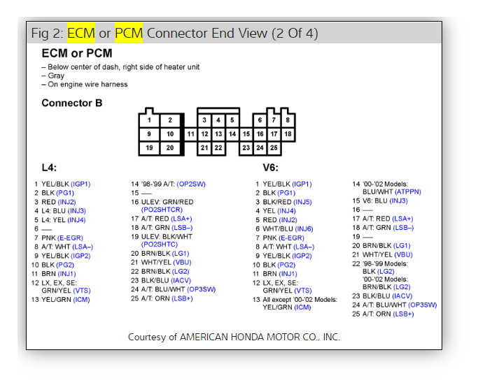

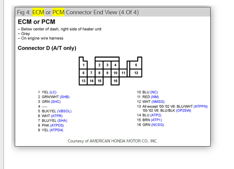

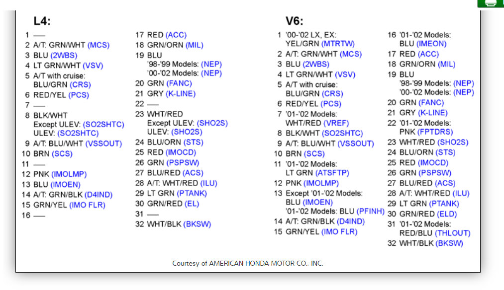

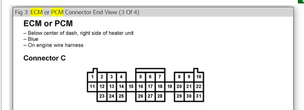

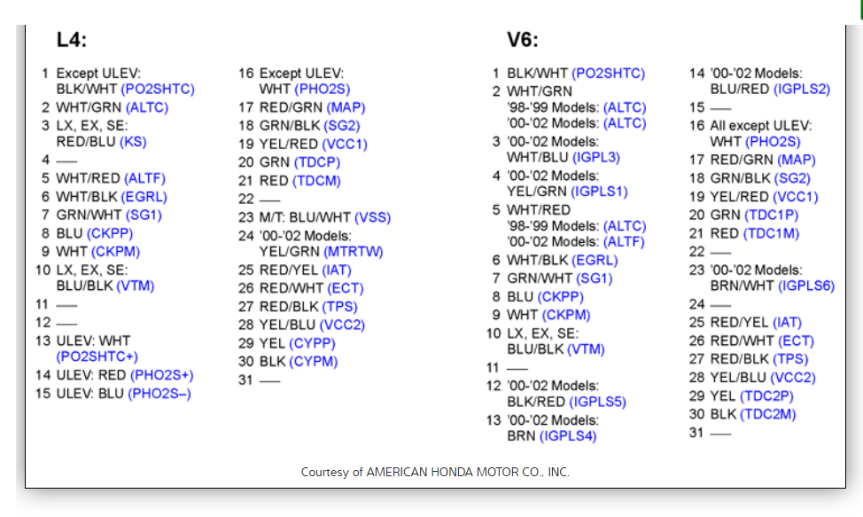

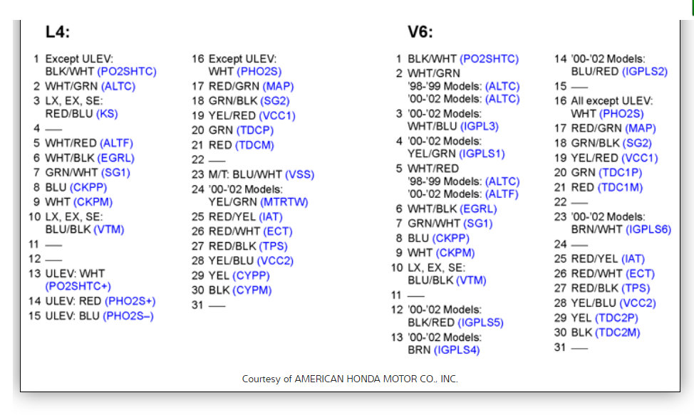

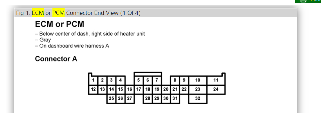

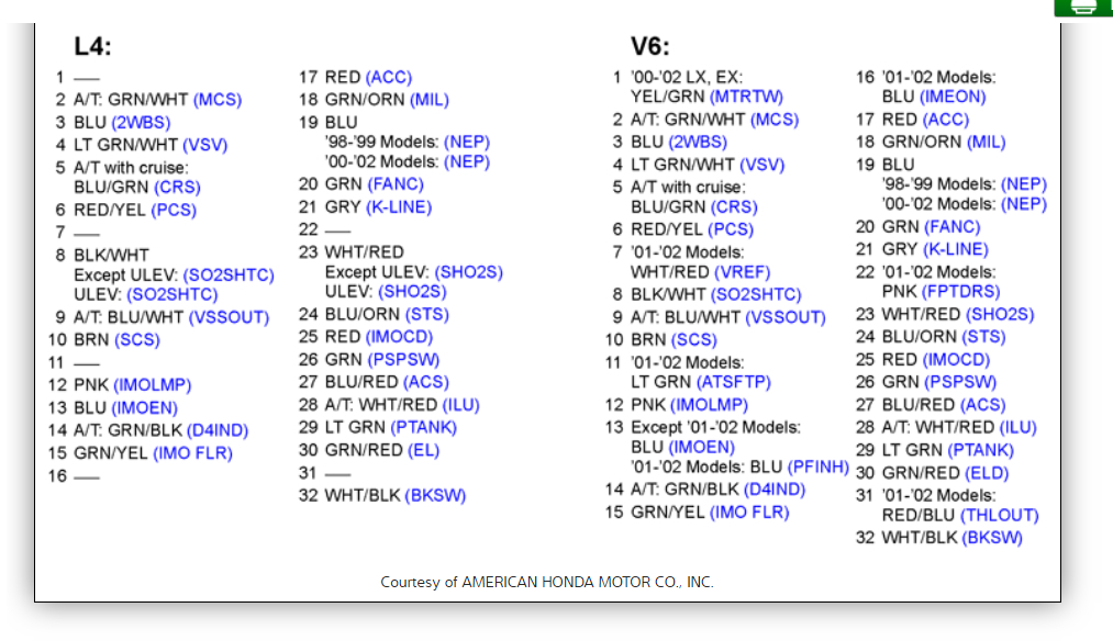

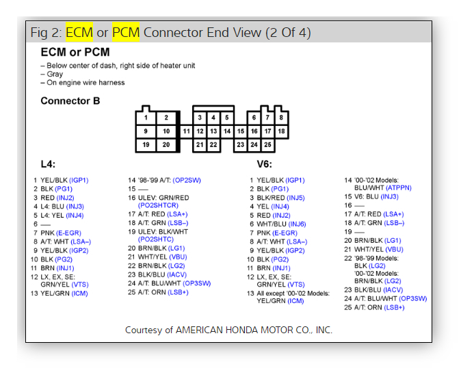

check engine light miss fires above 2800 rpms. cam sensor checks out. need wiring diagram and pin Id for pcm.

I have included the information that you requested in the diagrams down below. We also have a detailed vehicle manufacturer diagnostic troubleshooting guide for Direct Trouble Code (DTC) P1382 available if you would like. Please go through the diagrams down below and get back to us with what you find out or if you would like the troubleshooting guide.
