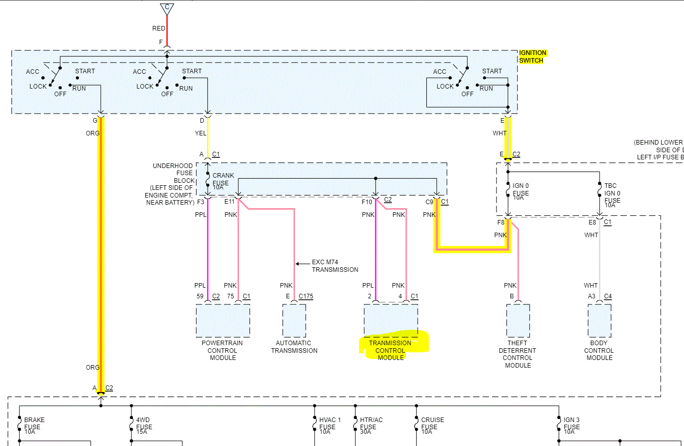

At the ignition switch, a white runs from the switch to the ignition 0 fuse. From there, it sends power to both the PCM and TCM. See pic 1 below. Check to see if there are any issues with power getting to its destination.
See pic below.
+1

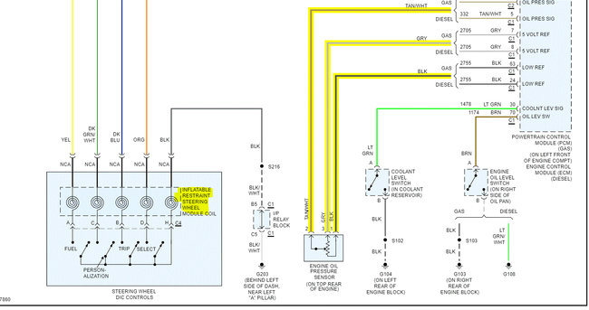

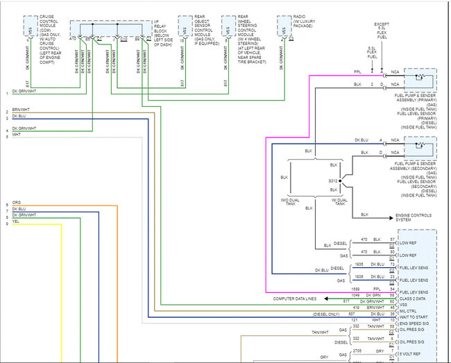

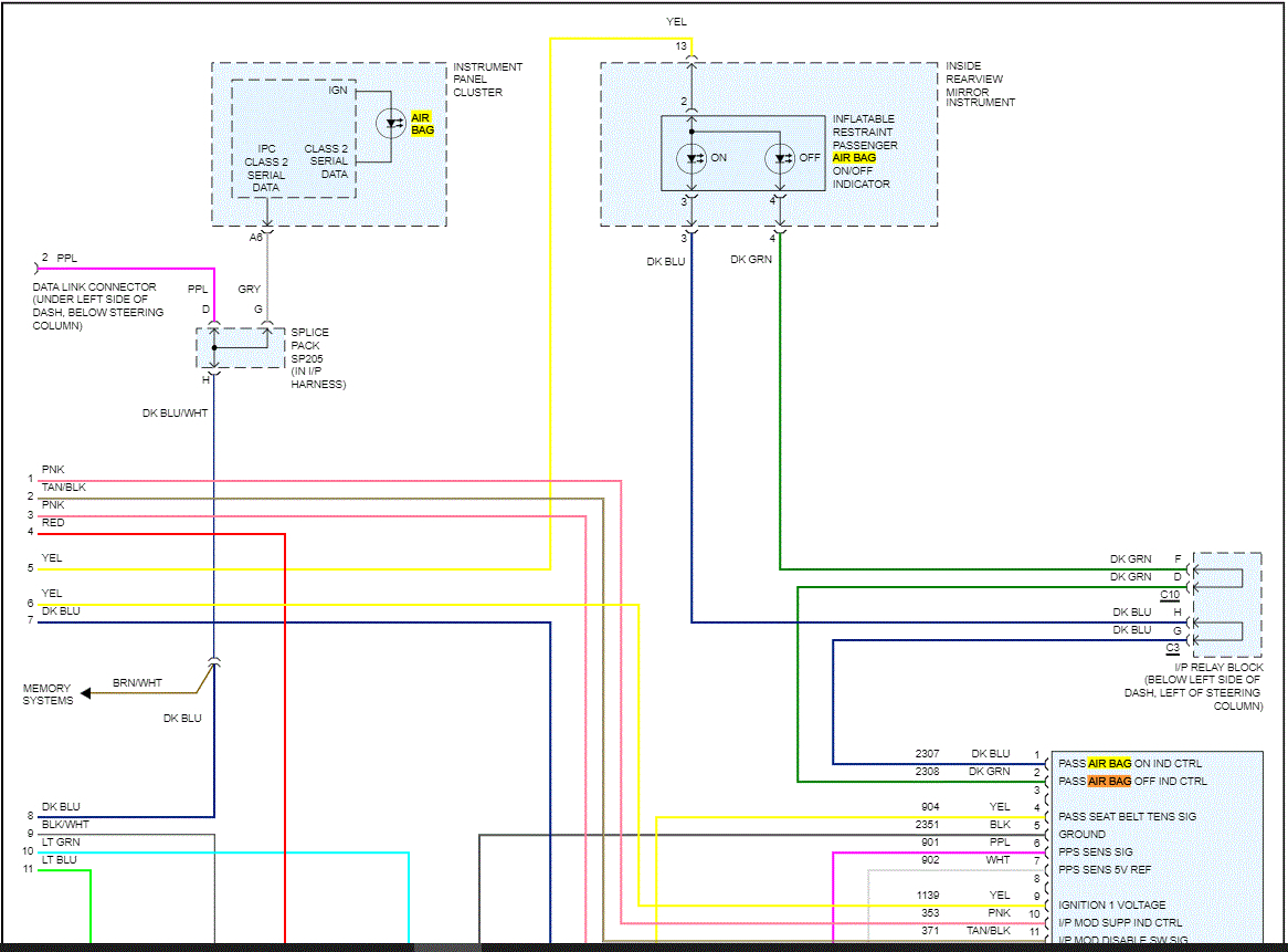

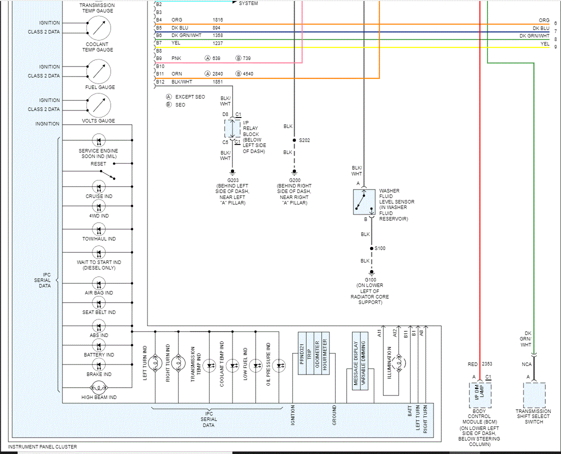

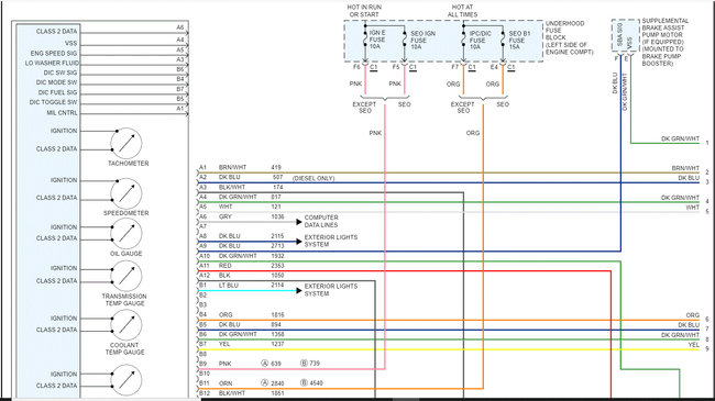

Also, do you have a schematic diagram for the low oil level display indicator? It’s popping up on dash and has an issue.
Monday, January 31st, 2022 AT 12:19 PM
LOUIS W NAGY
  • 55 POSTS

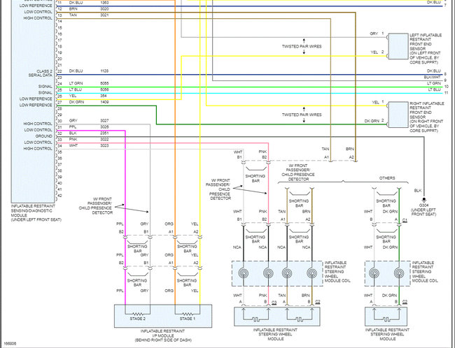

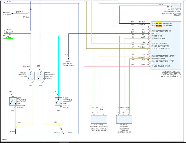

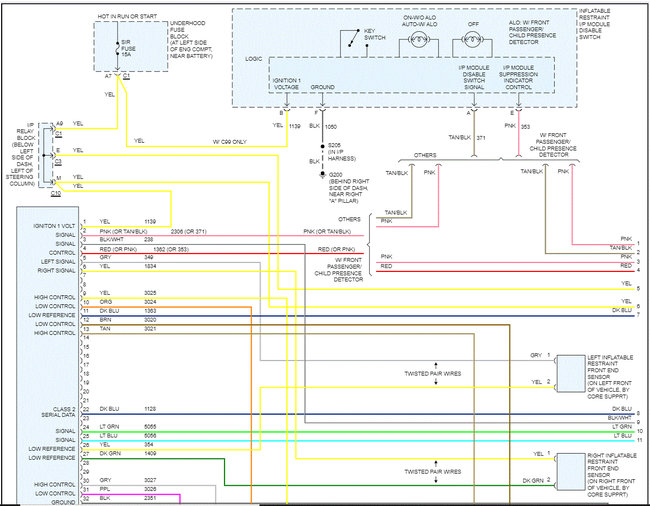

Also, do you have a diagram for airbags module it's coding up?
Monday, January 31st, 2022 AT 3:46 PM
LOUIS W NAGY
  • 55 POSTS

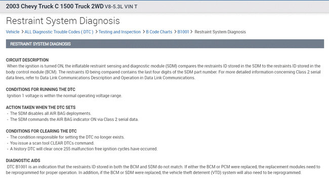

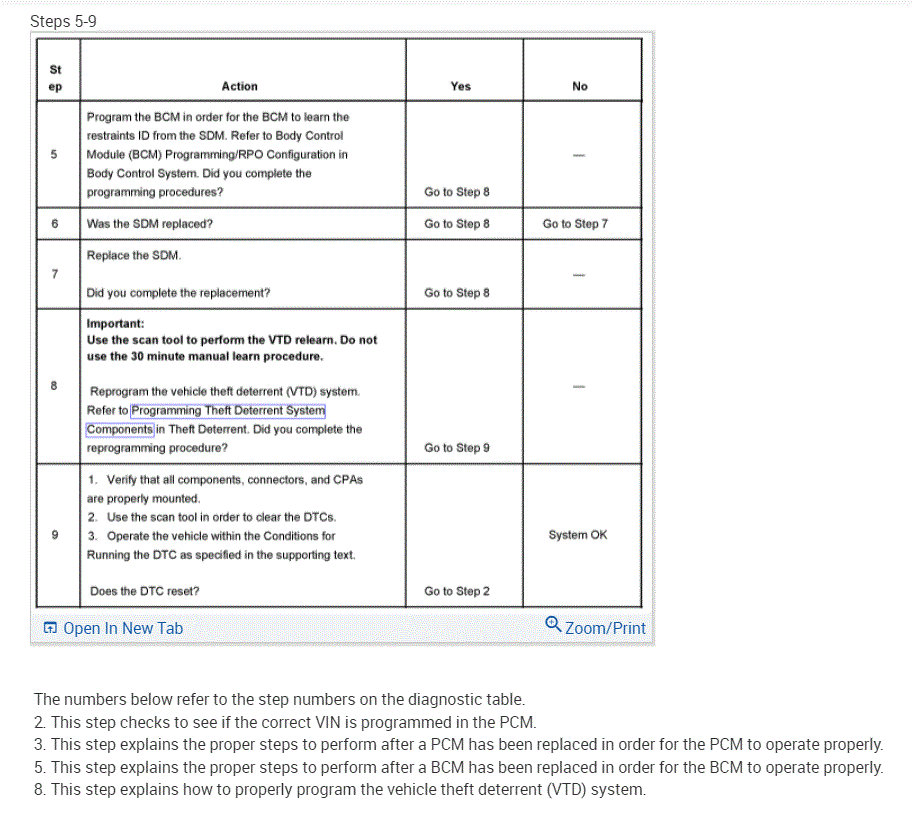

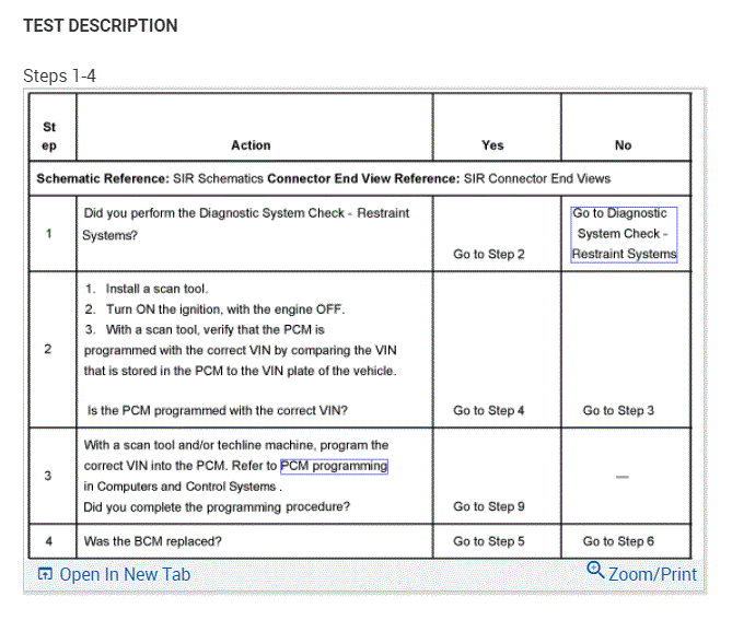

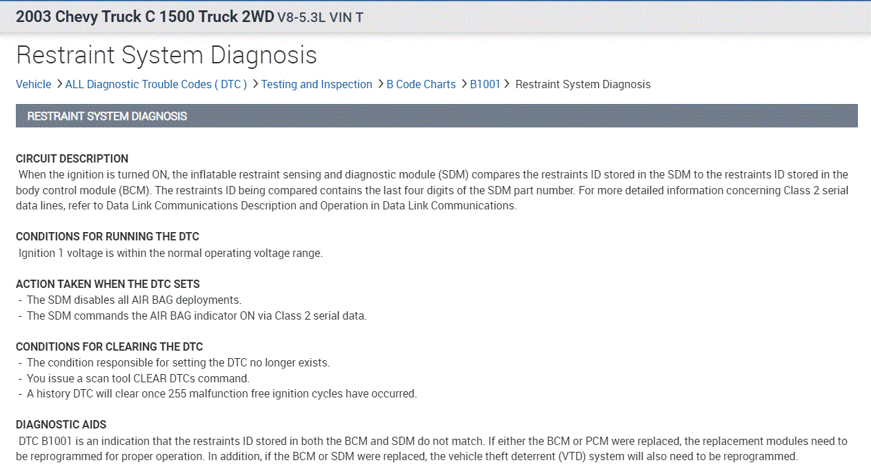

It's a B1001 code, hoping it’s a bad connection.
Monday, January 31st, 2022 AT 3:47 PM
  • 109,913 POSTS
I just sent an email related to cycling the switch to turn it off. I sent it to the site owner. Hopefully, he will have some ideas to help.

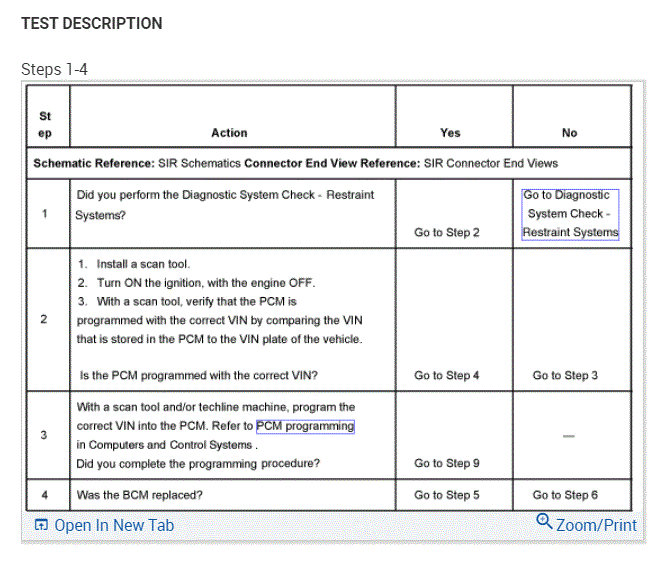

As far as your requests, here is what I did. Pics 1-3 are the diagnostics specific to the B1001. Pics 4-7 are the wiring schematics for the instrument panel, and oil pressure switch. The last 4 pics are of the restraint circuits.
