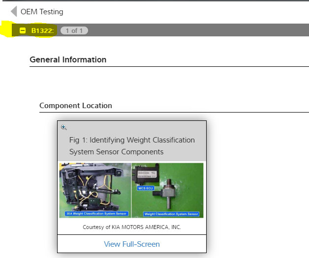

I lightly clipped an empty garbage can yesterday with my right headlight. Cracked the headlight but thought that was it. Then I noticed my airbag light was on. My Bluedriver scanner shows code B1322. I've briefly seen the light pop on in the past for like 30 seconds then shut back off. Was extremely rare but I have seen it. And whenever I did a deep OBD scan with my Bluedriver it showed it, but the light never stayed on in the past.

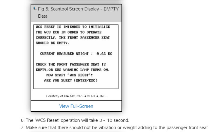

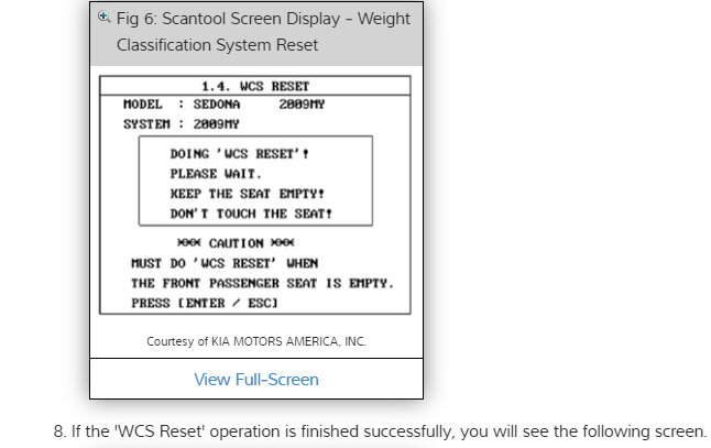

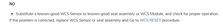

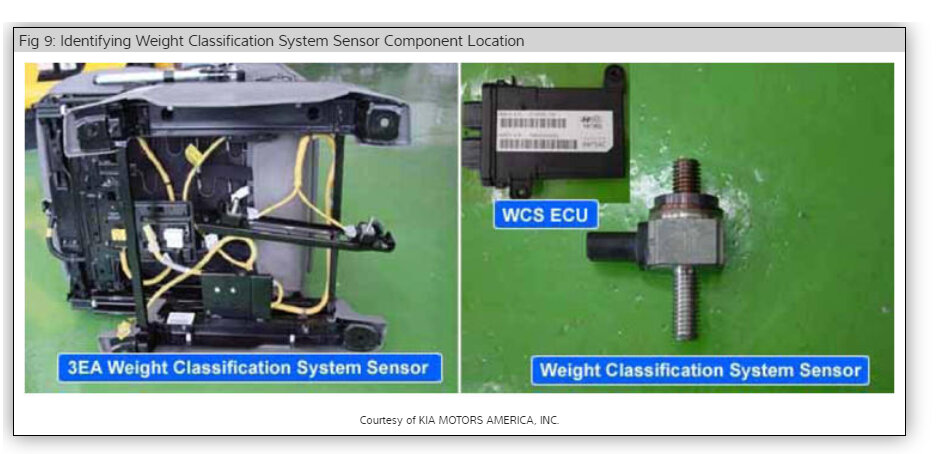

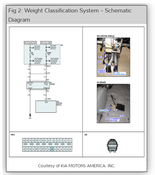

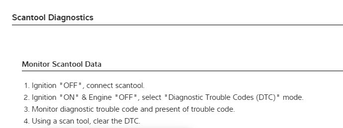

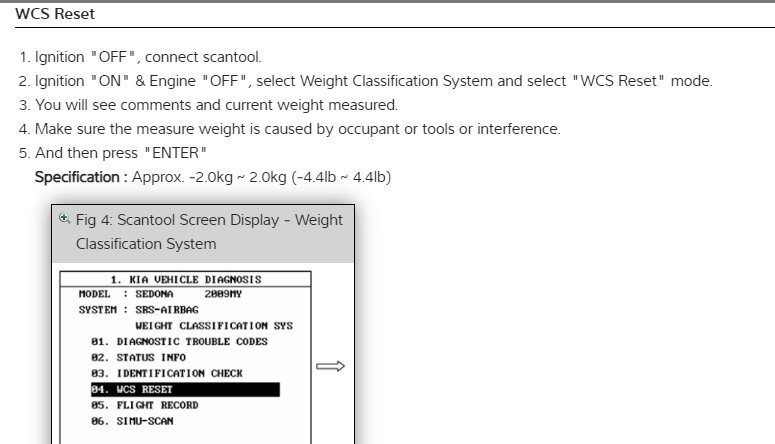

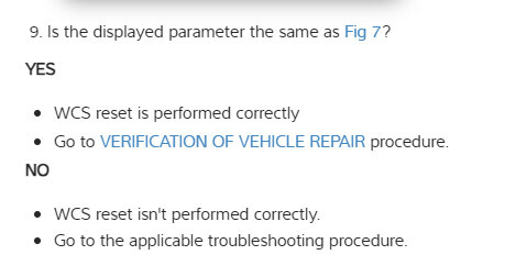

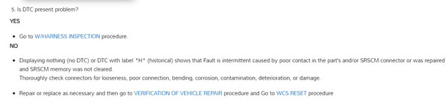

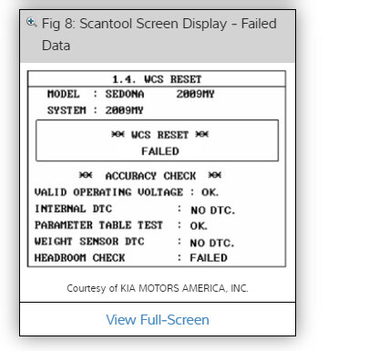

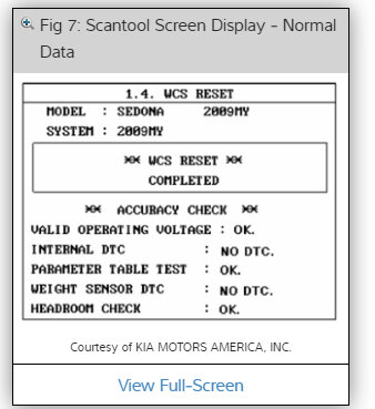

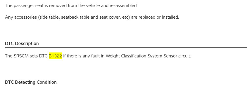

The code, although related to the airbag light, is actually specific to the weight classification sensor on the passenger seat. The system is designed to recognize when a person is seated. In this case, I suspect the code simply will need to be cleared. However, I attached directions below for diagnostics if you want and how to reprogram the WCS module.

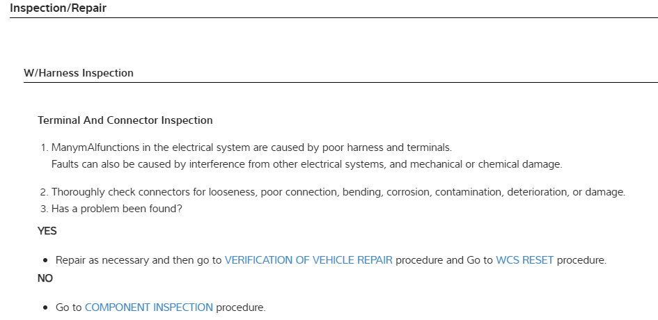

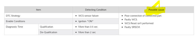

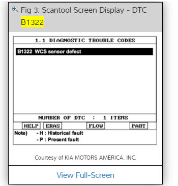

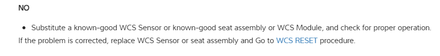

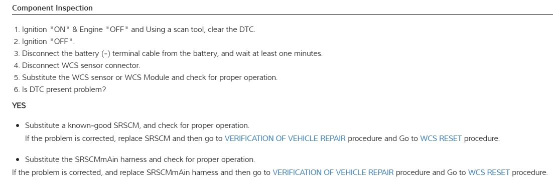

If you look at pic 1, it shows the sensor in question. The remaining pictures are the diagnostics for the code. Note that it is indicated that regardless of the severity of the accident, this code may be set.
Take a look and let me know if you are comfortable performing the diagnostics.
