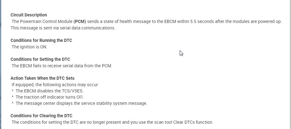

class 2 data link malfunction.
May 14, 2020 at 5:53 PM
  • CAR REPAIR CONTRIBUTOR

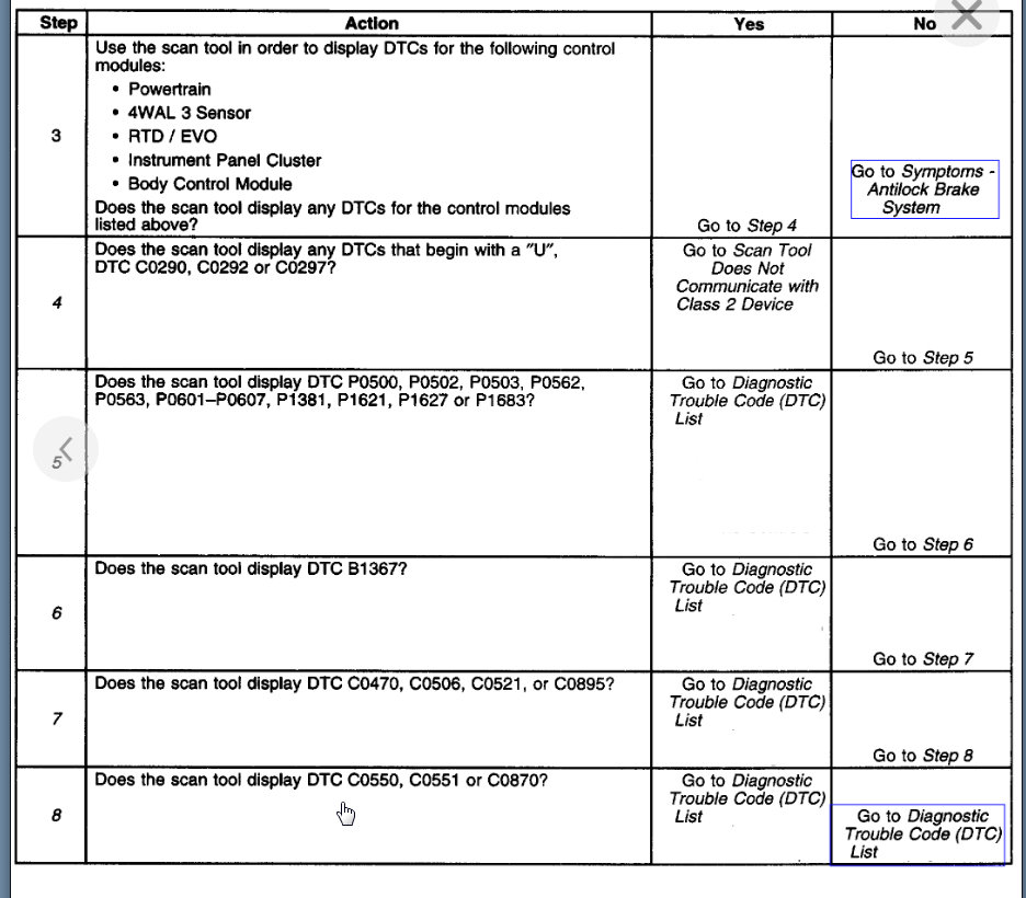

Basically this code is telling you that the EBCM (electronic brake control) failed to receive the serial data message from the PCM.
Usually this is not the only code that you have. Do you have a scan tool capable of communicating with the ABS/EBCM? If so, can you communicate with it?
If not, do you have any issues with the vehicle? Is the ABS light on or any other warning lights?
Thanks

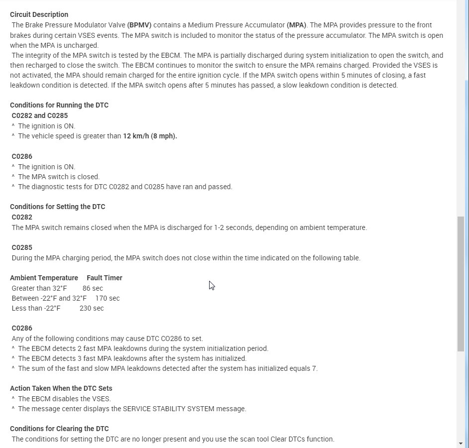

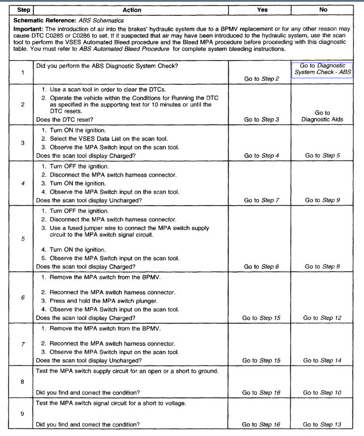

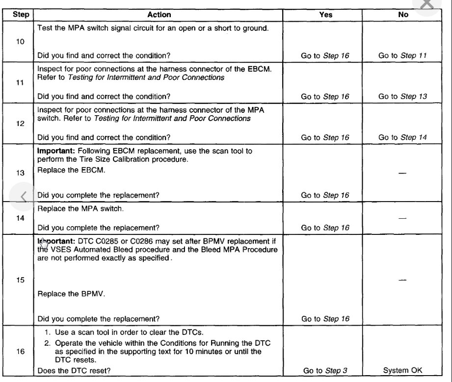

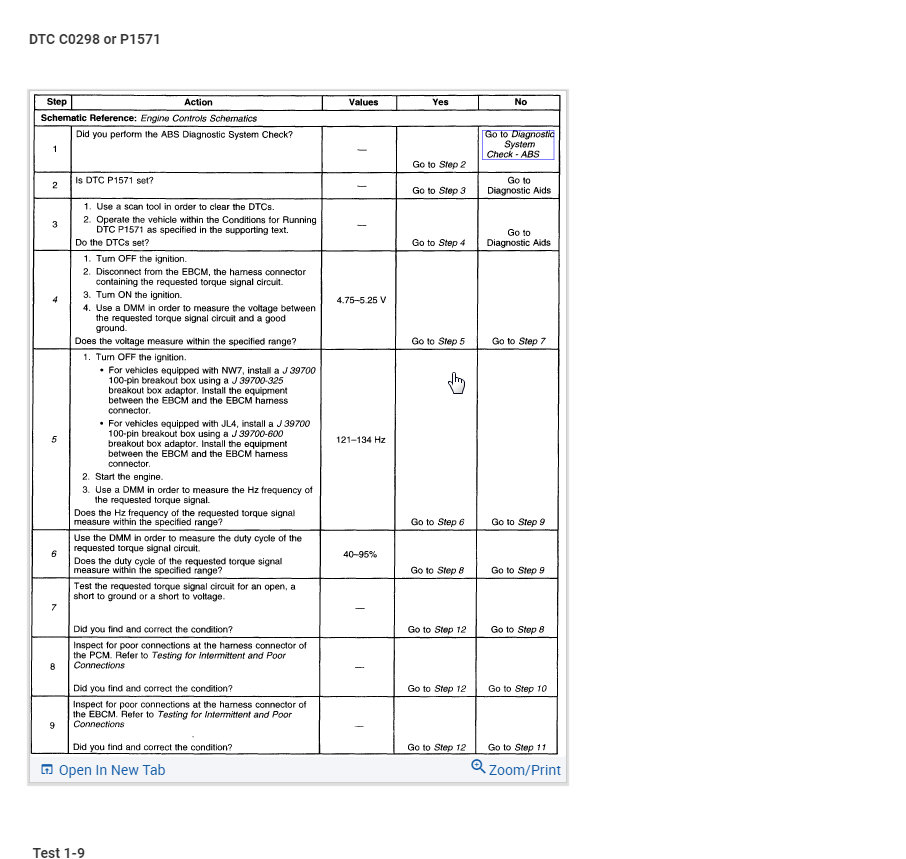

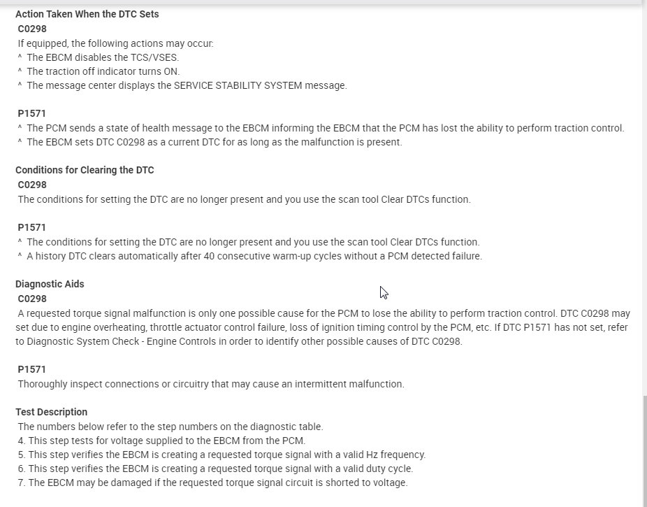

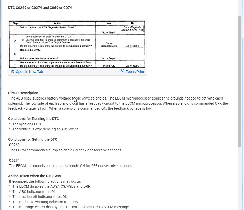

Co286(3/5) history.abs shorted to battery co269(4/5) excessive dump time. Co298(5/5)history.
May 16, 2020 at 12:28 PM

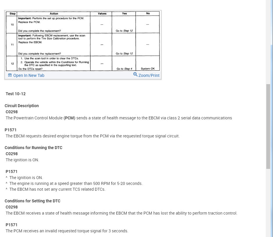

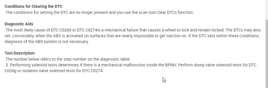

C0286 - MPA malfunction
C0269 - EBCM Commands dump solenoid on for 9 seconds
P0298 - Torque signal malfunction
I attached the testing for these codes as well. Run through these tests and we can go from there. Thanks
