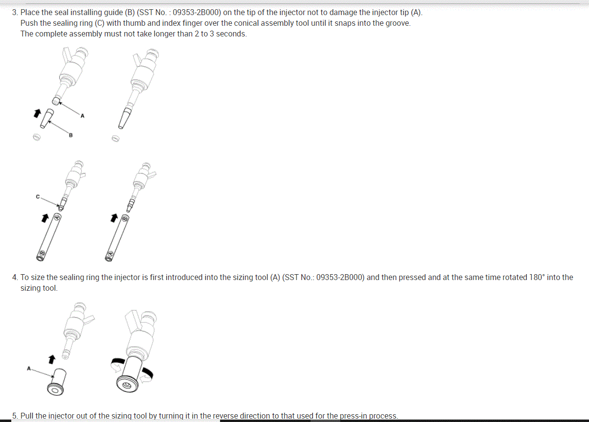

Short story. While driving the car uphill it started to shake, smell of gas, and engine light flashing. Took it to get checked. Cylinder 4 misfire turned out no issue with spark plugs but compression test was at about 150 for #4 bad fuel injector. It was not checked internally. Does a bad fuel injector cause the issue or more internal problems? Thank you.

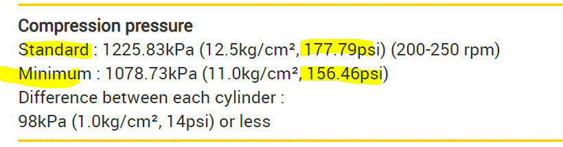

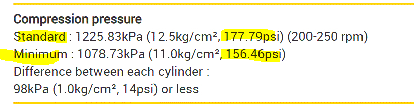

I looked up the specs on compression, and it indicates 156.4 is the minimum. See pic 1.
Now, if you had a fuel injector sticking open and dumping fuel in that cylinder, it will cause the oil on the cylinder walls to get washed away. That can cause compression to drop. Is that what they told you?
Also, if there was that much fuel being sent into the cylinder, there is a good chance it mixed into the engine oil. If you haven't, I would suggest checking the oil for a fuel smell and changing it if there is one.

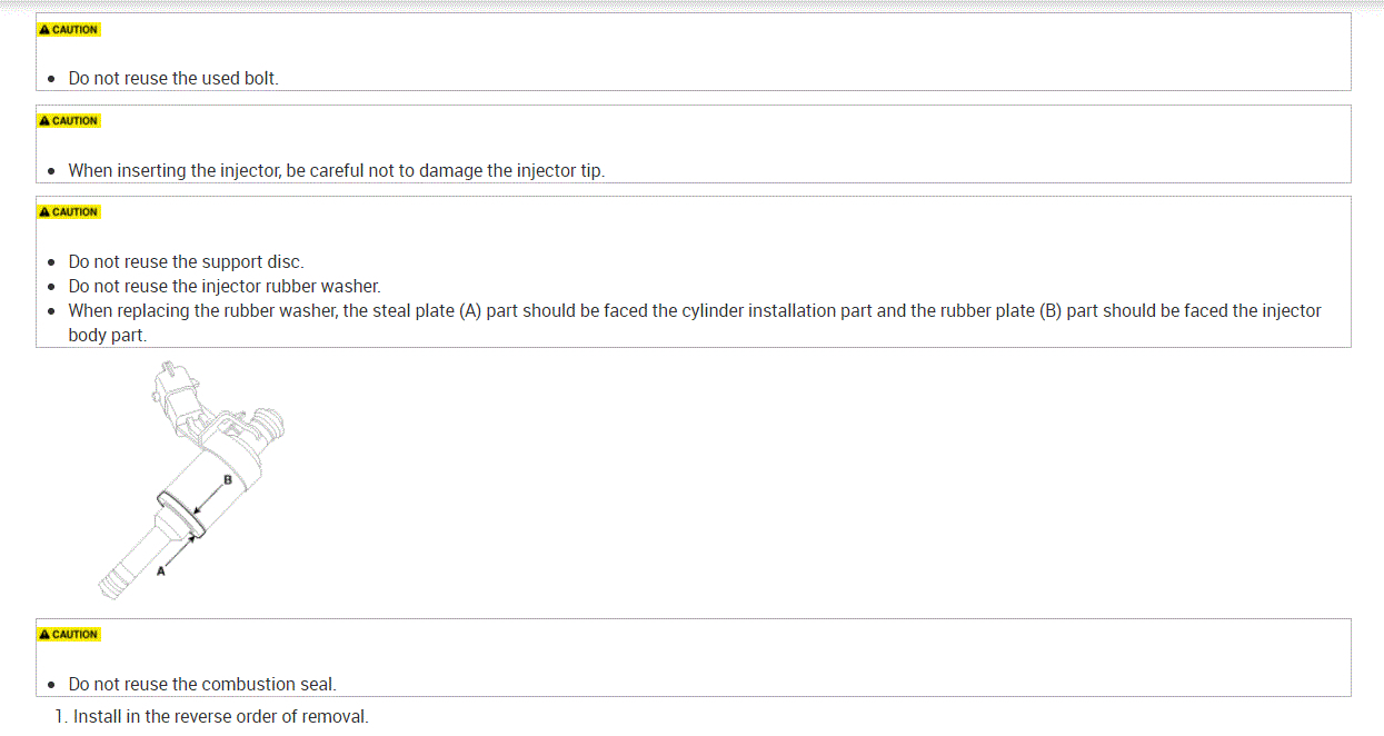

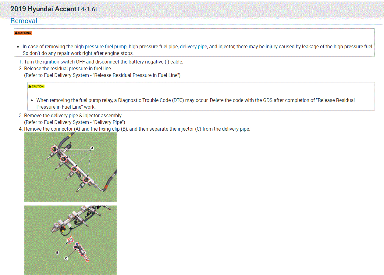

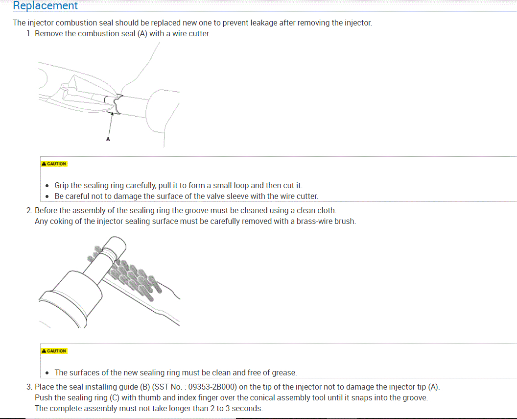

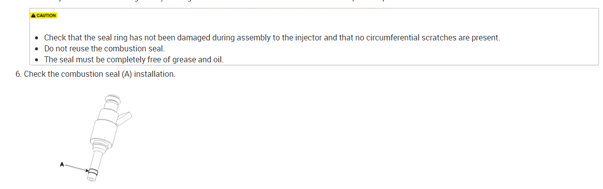

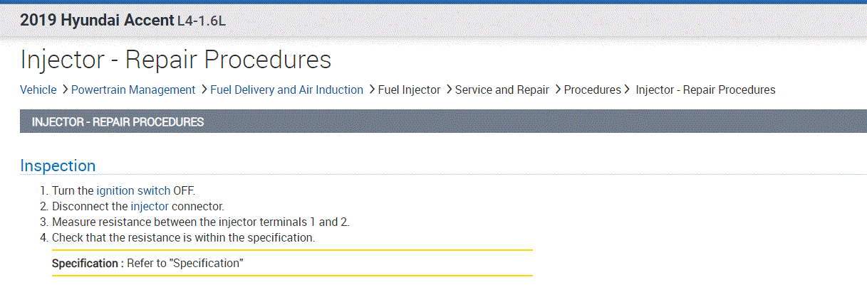

There is a chance what I described is the cause of the problem. If you decide to do the repair yourself, I attached the directions below for injector and spark plug replacement. However, I would contact the dealership and ask if it is covered. It should be.
