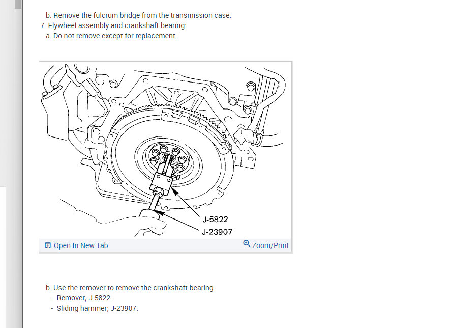

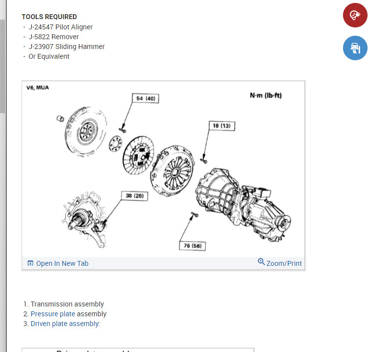

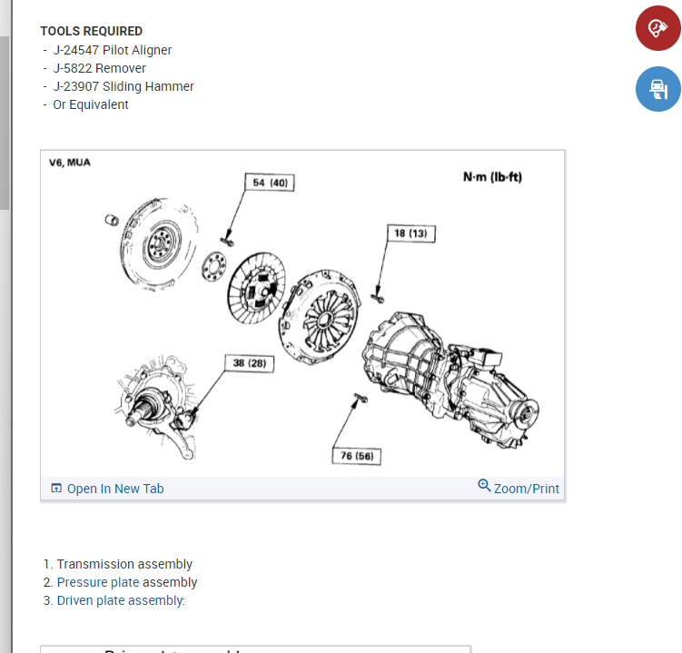

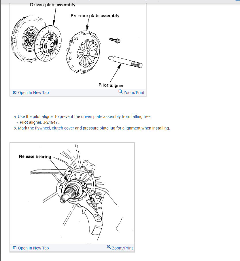

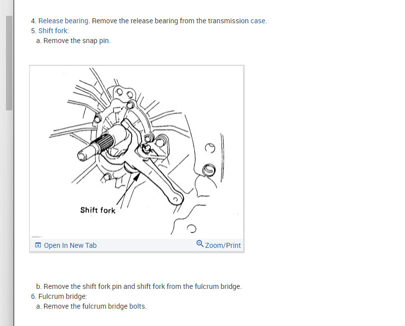

Hi, my clutch feels like it needs pumped up. It is mushy and having trouble putting it in gear.
Sunday, March 12th, 2017 AT 3:52 PM
This is almost always due to air in the system due to a leak.
Here are a few guides that will help with this:
https://www.2carpros.com/articles/clutch-doesnt-work-sometimes-or-not-at-all
https://www.2carpros.com/articles/how-to-replace-a-clutch
https://www.2carpros.com/articles/pilot-bearing-replacement
https://www.2carpros.com/articles/throw-out-bearing-replacement
If it were me, I would just get a clutch kit and replace the entire system as this is likely due to a slave cylinder leaking. So, if this is the case then when you go in and replace the slave, I would again, replace the entire clutch while you are there.
I am attaching the entire process from the manual on how to do this. Please run through this material and let us know what questions you have. Thanks
