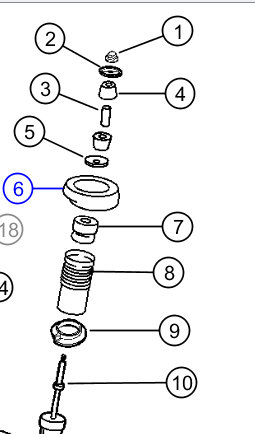

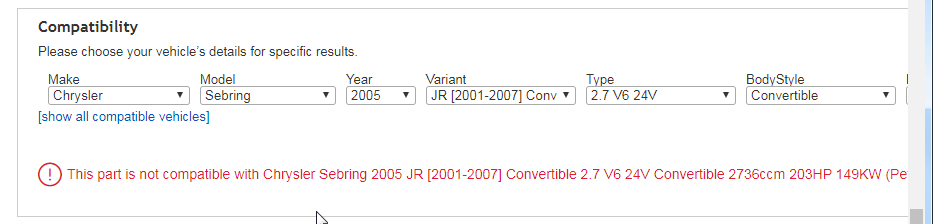

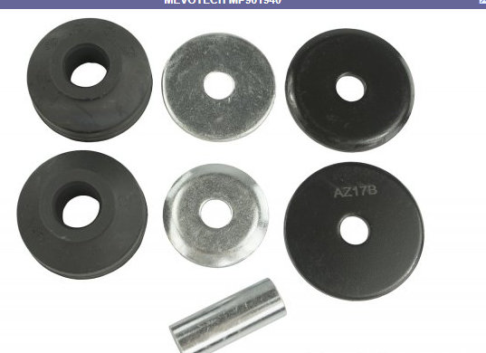

I asked a mechanic about this and he said it was the strut mount. I then asked him if these were the right ones (LEMFÖRDER 31122 01).
https://td-docs.kvikymart.eu/22123/282570196896912#v5
and he said yes. I then went to my regular mechanic so he could install it and he said they're not the right ones. I don't know what to do anymore. I don't know if I have bought the right thing.
Please help, thanks a lot!

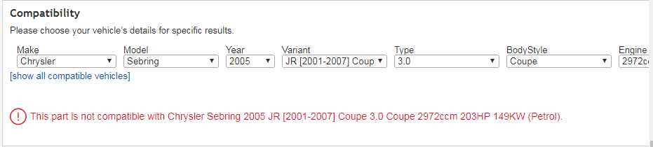

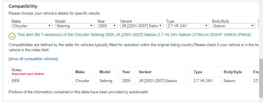

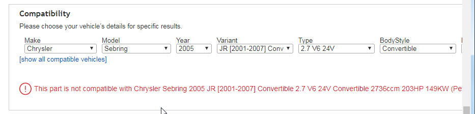

The only 2.7L Sebring that this appears to be compatible with are the Saloon model. The Coupe and Convertible are not compatible. If you give the last 8 of your VIN and I can look up what the part number is for your vehicle.

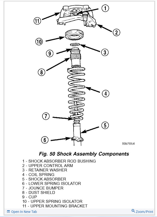

To add to the frustration, there's multiple Sebring models to insure we all get confused. For 2005, it's down to two models, the coupe and the convertible.
The convertible uses an upper mount with four bolts sticking out the top of the inner fender, near the hood hinge. Those mounts are not replaced. They have rubber bushings, or inserts, that get replaced. By loosening those four nuts, that mount can be slid in and out on top to adjust "camber", one of the three main alignment angles.
The coupe uses the style of upper mount you found, but there's no indication if what's in the photo is for your application. What's worse, online stores often use generic parts photos only as a representation. It may not be a photo of the exact part you will receive. They could use the same photo in dozens of listings for other car models and brands.
Getting back to the noise, clunks and rattles can be some of the most elusive things to find, even for experienced mechanics. Often we see the same causes on the same models over and over, so we base our diagnosis on that past experience, but even then we get caught once in a while when something unusual shows up. In this case, being a suspension and alignment specialist for over 30 years, including ten at a very nice family-owned Chrysler dealership, I did run into worn strut mounts from time to time, mostly on trade-ins of other brands, but about 95 percent of the time, those clunks were caused by the struts themselves. The upper mount is held tightly sandwiched between the car's body, (inner fender), and the top of the coil spring. There's over 1,000 pounds of compression force on the mount, so most types of wear can't show up until we take the assembly apart. In fact, that is one of the things that perpetuates our bad reputation of selling you unneeded parts. We get asked to replace the struts, and it's when the first one is removed and disassembled that the upper mount falls apart, or we can see the center hole is rusted out, and that is when we have to find you and tell you more parts are needed. We hate having to do that. And you feel that as long as you keep saying, "yes", we're going to keep on finding more things your car needs. You leave angry when we had no way of knowing those extra parts were going to be needed. This happens to almost every mechanic every day.

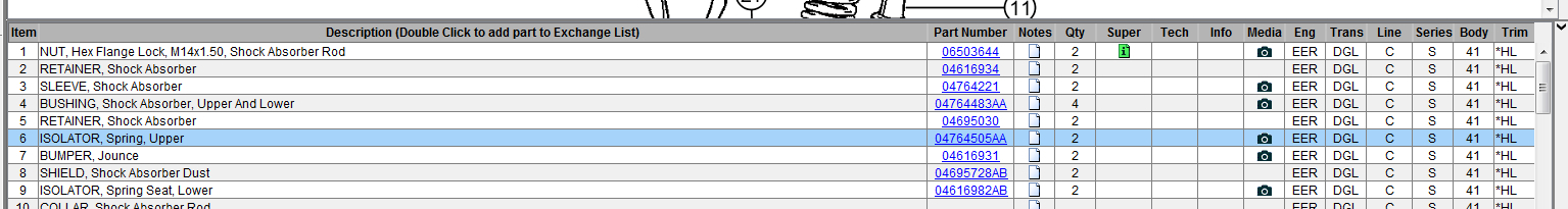

Vin: 1C3ALB6R35N615296

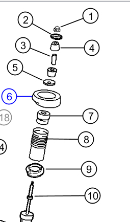

The one that they provided is for a coupe (2 Door). Your vehicle is a sedan (4 door) correct?
Unfortunately, they do not have one part like they do for the 2 door. You need to order each part individually from the dealer and reuse the bracket or you can order a kit and reuse the bracket from the link below.
You body code is JR and is a sedan. So you can select any of these options and you will be okay.
https://www.rockauto.com/en/catalog/chrysler,2005,sebring,2.7l+v6,214102,suspension,strut+mount,7600
It may be the best idea to have whatever shop is going to do the work, take a look at your vehicle and then have them look at the site so they make sure they get what you need.
