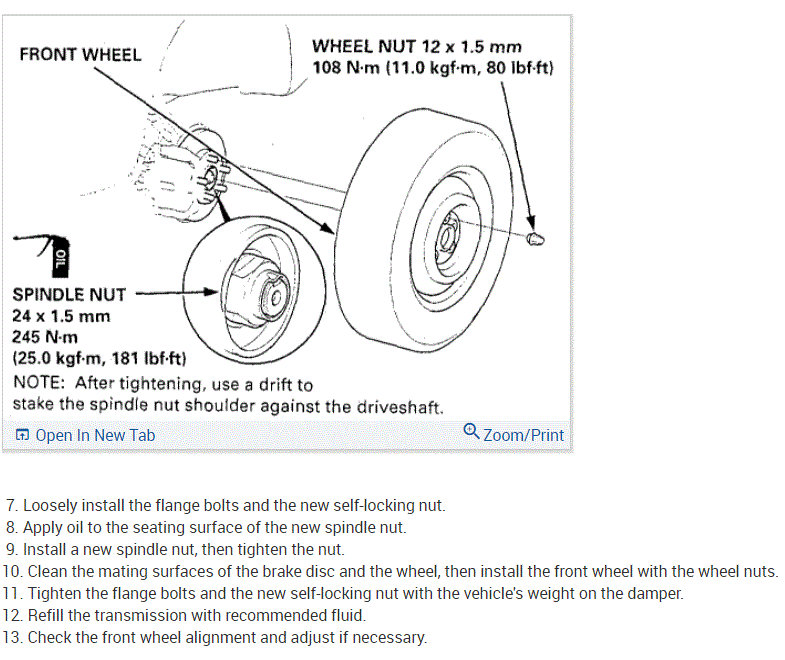

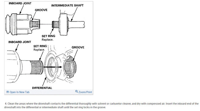

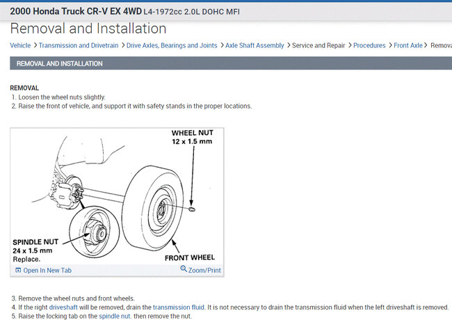

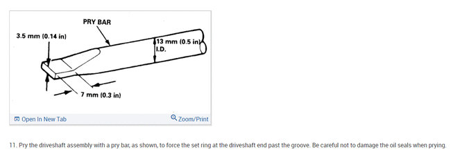

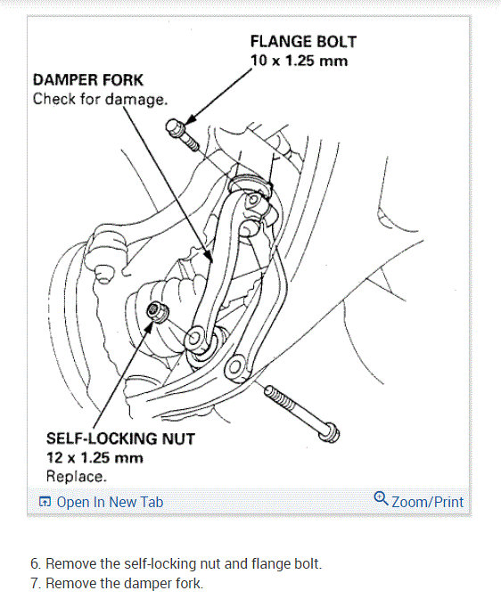

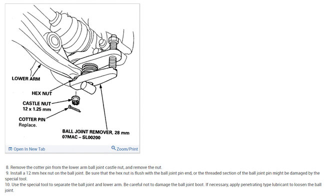

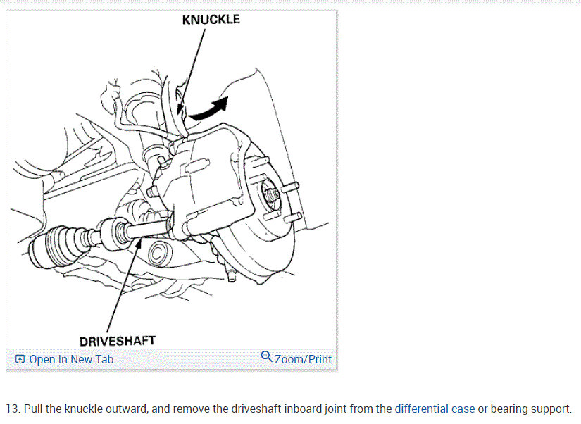

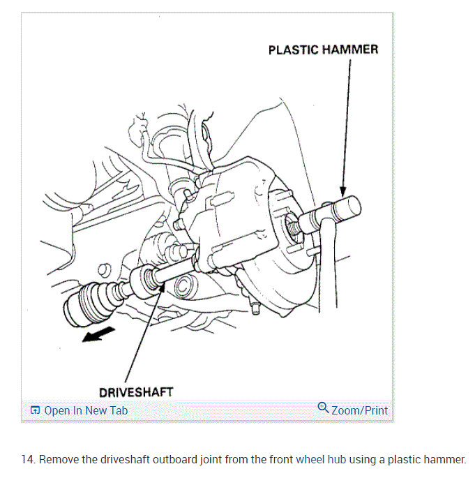

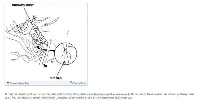

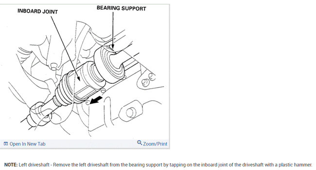

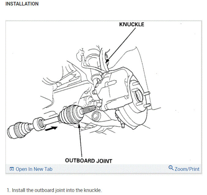

I watched the video. It really seems like you have a bad CV joint causing it to jump like that. I realize you replaced the left one, but have you inspected the right one? Also, are the splines on the axle fully seated?
That is what I would be checking. If you find the axle/CV joint is the issue, here is a link that shows in general how it is done:
https://www.2carpros.com/articles/replace-cv-axle
If you look at the attachments below, they include the directions and pics specific to your vehicle for replacement.

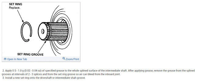

I can't find a replacement set ring for intermediate shaft. I am not sure what size or what else I can use.

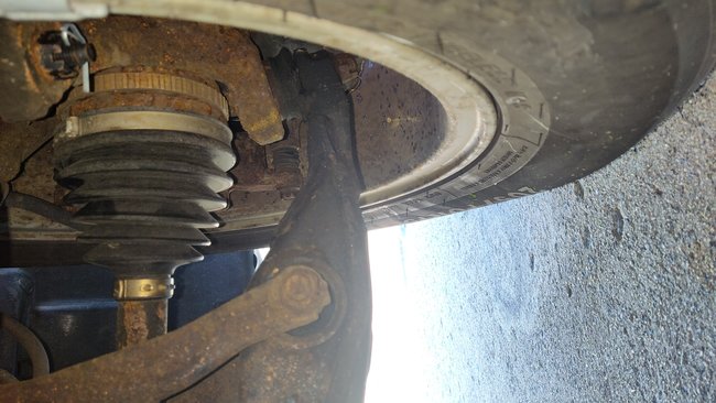

When I shift you will hear minor knock and see slight movement with engine. Right as I start to turn wheel you will see engine lift forward. Oil pan is in front of inner joint.

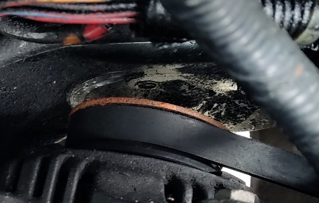

Alternator is hitting . The video I sent you see the engine lifting when turning wheel. I redid CV and it still clunks but not as loud or as much.

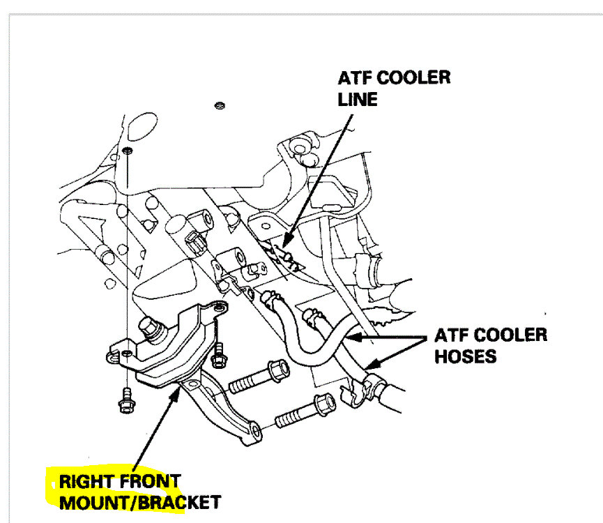

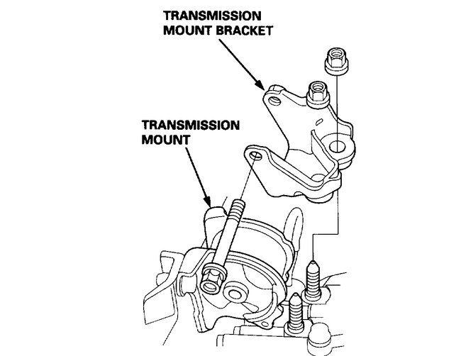

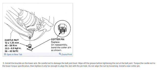

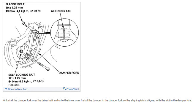

  • 110,248 POSTS

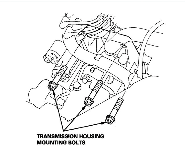

The entire engine/transmission has to be moving for the alt to hit and it looks like the axle is hitting or nearly hitting the control arm.
Take a look at the pics below. Check these things and let me know if you find anything broken, missing bolts, or loose.
As far as the set ring, that may be a hard find. Have you tried the dealership? Did you lose the original one?
Apr 16, 2021 at 12:54 PM

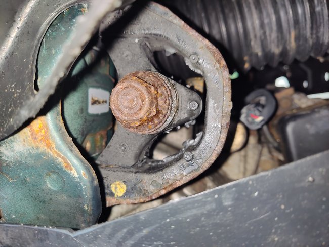

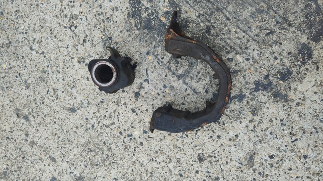

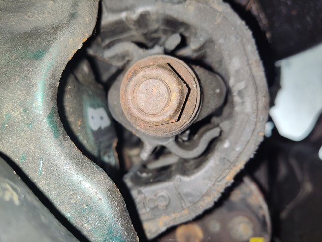

this motor mount is no good. This is how it came out. When I was taking this mount off I was able to move the engine back and forth With very very little force.
Apr 17, 2021 at 2:31 AM
GENESIS88
  • 140 POSTS
I forgot to mention I haven't look closely at the others. I do know the lower left engine side is gone. The lower right trans side is cracked through.
Apr 17, 2021 at 3:50 AM
GENESIS88
  • 140 POSTS
So I think it's fixed. I installed lower front engine mount. I also found upper mount wasn't fully tighten. I did timing belt couple months ago and forget to torque them to spec. I tested car in driveway to neighbor driveway going forward and reverse and turning wheel fully both way with no noise. Once I fix my alignment I can do a real test drive. So it looks like the lower front transmission mount cracked all the way, since the lower engine mount was gone engine dropped slightly and caused a lot of movement. In turn it caused cv to bind and make a lot of noise. The original CV axle was bad. The first 2 replacement where defective. So it looks to be a whole mess of things going wrong in a row. Also me making a mistake and not double checking my work. Now I don't know for sure, but this was the first time it make zero noise when testing in driveway to neighbor drive forward/ reverse and turning wheel both ways fully and stomping gas and then brakes.. I should know in a few days when I do a at home alignment if it's truly fixed. Also the rest of the motor mounts are in good condition. Only the 2 front lower where bad and the 2 nuts on top engine mount loose.
Apr 17, 2021 at 11:33 AM
  • 110,248 POSTS
I think you have found the problems. I don't think I've ever seen a mount as bad as the one you attached. The engine and transmission are moving all over the place.
As far as the one on the trans side, replace it and any other ones that are bad. Let me know if you need help with anything. If you have a chance, let me know the outcome.

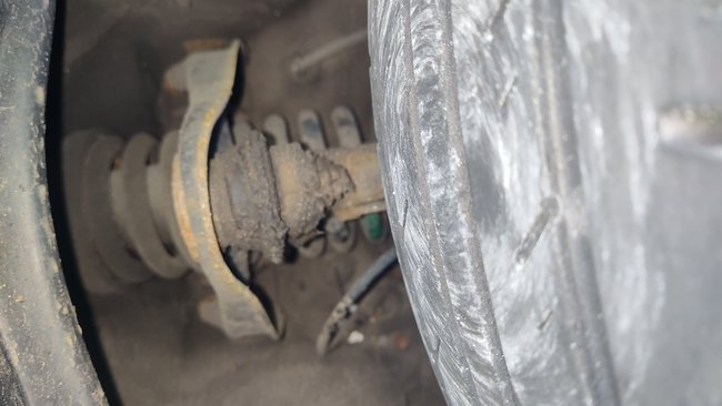

When I did the inner tie rods I never replaced the boots until I knew car was fixed. When I was jacking up right side I noticed half way up the inner tie rods was flexing/bending and tire seems to take longer to get off ground. Can a blown strut/mount cause these issues including CVto act up or seems like it's acting up?

If the inner tie rod is flexing, there has to be a good bit of downward pressure being placed on it. Are you sure the strut assembly is still attached specifically at the top mount?
Something sounds broken. If possible, can you take a video showing what you see and upload it for me?

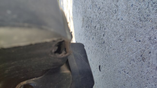

I checked the right side and there is no play. But when I dropped car and rolled back and forth in drive way the car rolled forward again. It's almost like it was bump steering. Just looking at at the ball joint and upper control you can tell there bad. Grease is coming out and boots are cracked. The strut assembly might be shot also . I'm just going to grab my old phone out it under car under each axle facing inward and outward and take 4 videos. That should help isolate where the issues are. I'm just not sure what do you think. Can a bad hub cause axle to bind and cause inner CV to jump and skip on intermediate shaft? Also one photo from past post you can see in front lower wheel well tire wore a groove into it. That is on the right side.

I did notice that. I didn't mention it because that can happen if the tire size was changed to a larger size.
The best thing to do at this point is to get a prybar and see what moves. Grab the axles and see if anything is moving when you apply a lot of pressure back and forth.

The suspension seems fine. There is no signs that it's blown or broken Tomorrow when I check everything again I'll take photos and videos of everything Important.

Let me know. I'm interested in knowing. If the tire size is original, something is either allowing the tire to reach the inner fender, or the inner fender is loose and making contact with the tire.
