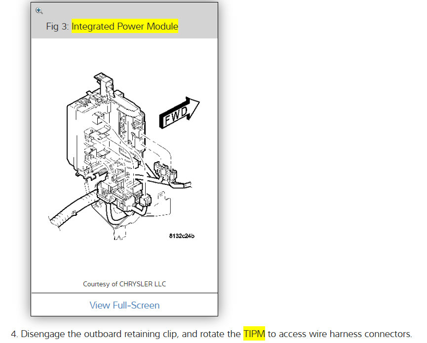

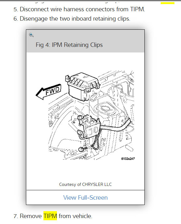

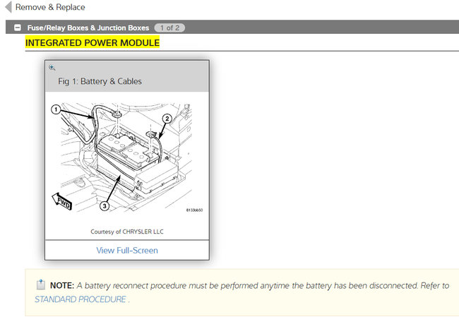

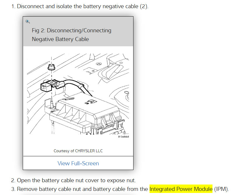

Drove in a puddle of water in my car and now car will not start.
Jun 5, 2021 at 5:33 AM (Merged)
HMAC300
  • 48,601 POSTS
check to see if your TPIM module under fuse box got wet that may be the problem. When you turn the key to the on position without cranking the engine over can you hear the fuel pump run in the tank for 5 seconds?
CIMMY
Okay, I am waiting to have it towed. when I try to start the car it just cranks over.
HMAC300
  • 48,601 POSTS
It sounds like the TIPM.
CIMMY
Okay thanks, I had a new TIPM installed it started right up.

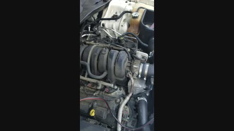

Well from the video it seems to be turning over fine, just not starting. That means it is either not getting spark or fuel. It looks like it has a crank signal as the tach seems to be moving up to around 150 rpm which would be about correct for cranking speed from the starter motor.
It did look like the fuel gauge read very low. While it isn't the most common thing you might try adding a few gallons to the tank and see if the gauge is correct. It wouldn't be the first time a sending unit was wrong.
It sounded like the fuel pump was operating but it's hard to tell for sure on modern cars.
Next would be to use a test light and check all the fuses in the front and rear power centers. This vehicle is in the range of the bad PDC units and those can cause a lot of strange failures.
To do much testing beyond that you need a factory level scan tool to be able to trigger items on/off and verify their operation.

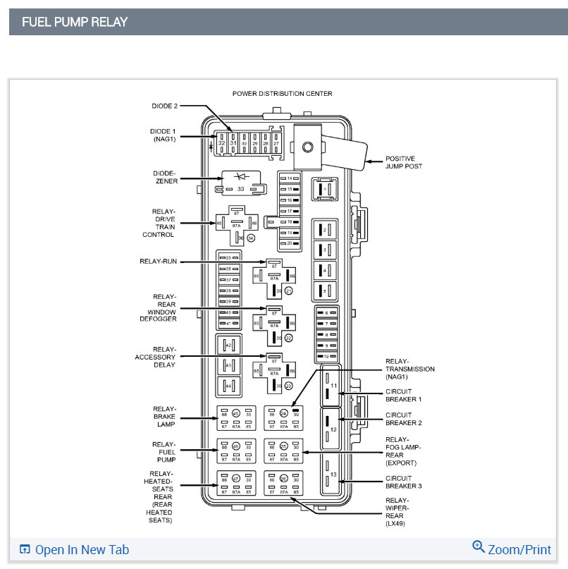

You should hear the fuel pump kick on if you turn the key to the opposition without racking the engine over. The fuel pump is in the tank. Also this guide can help if the security light is flashing to reset the security system.

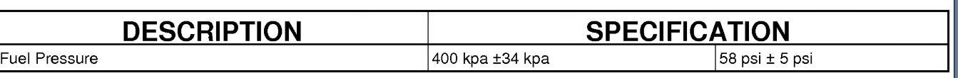

  • 110,244 POSTS
Did you try scanning the computer to see if there are trouble codes stored which may indicate the problem? Here is a quick video:
https://youtu.be/YV3TRZwer8k
Next, you should check to see if the engine is actually getting spark and fuel to the engine. Here are links that show how:
If you find you are getting spark and fuel, then try this. See if the engine will start for a couple seconds using starting fluid. If it does, then it is fuel related. If it does not start, then it is not getting spark or there is internal issues.
If it does start, follow this link to see if the injectors are getting power.
https://www.2carpros.com/articles/how-to-test-a-fuel-injector
____________________________
The attached picture shows the manufacturer's specs for fuel pressure.
Here is an additional link that discusses cranks but no start conditions:
See if there is anything there that helps.
Do these things and let me know what you find.

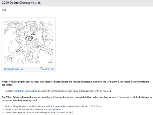

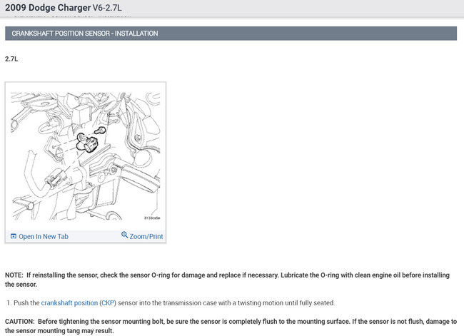

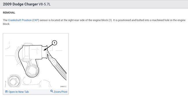

It sounds like you have a crankshaft angle sensor that has gone bad which will make the engine not run and it will not show any trouble codes. Here are two guides and will help and the location of the crankshaft position sensor for your car in the diagrams below. I would also check the fuel pump relay location below.
and
and
I do not know what engine you have so I gave all options below. Check out the diagrams (below). Please let us know what you find. We are interested to see what it is.

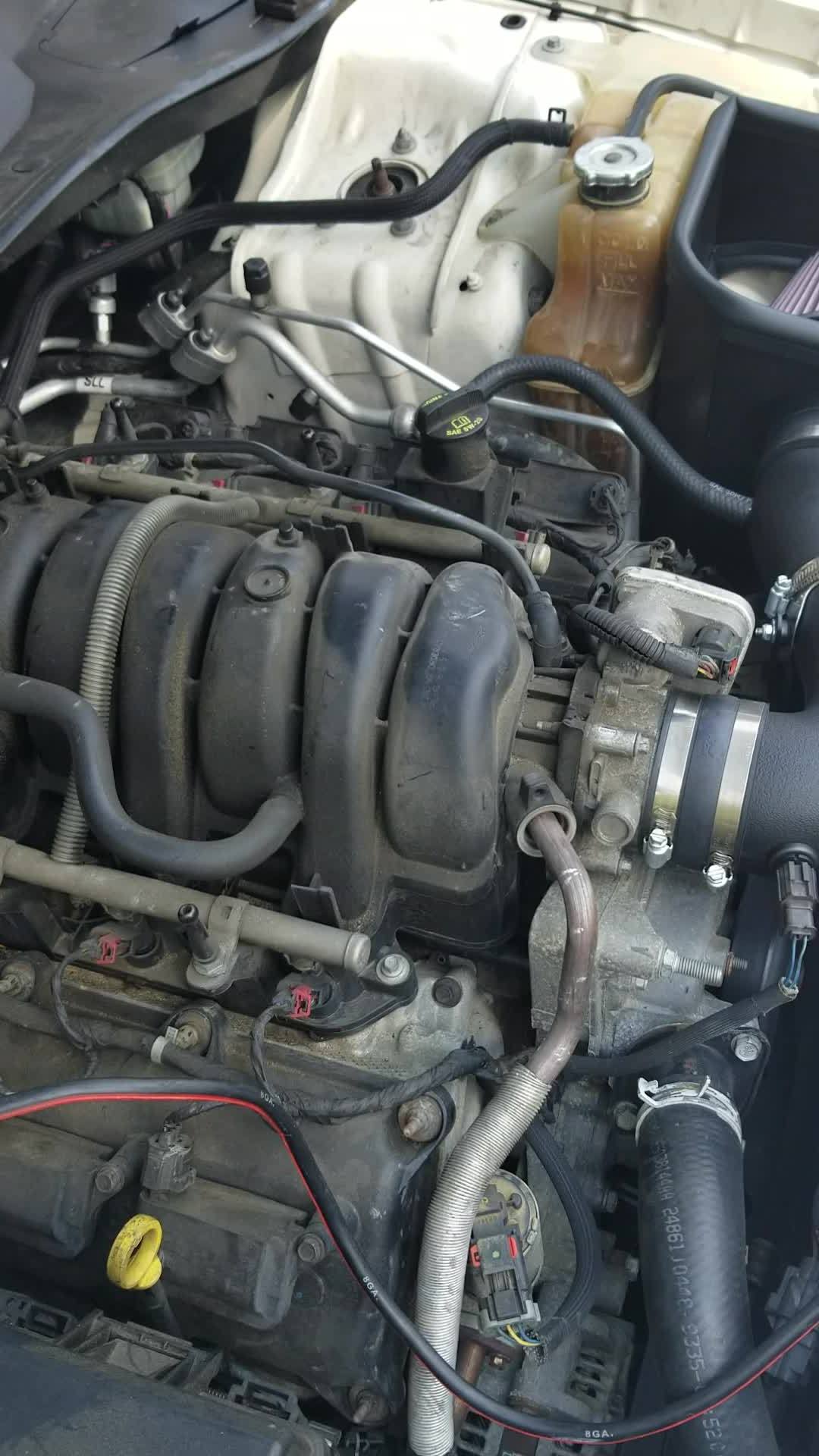

KRISKRAFT2020
I swapped out a 2007 3.5 liter motor from my charger, and installed a 3.5 from a 2005 Chrysler 300.the swap went well. my only problem now is getting injectors to work.fuel pump primes and runs while cranking.pulled a cam sensor code then soon after crank sensor code. tonight I replaced both sensors and finally got it want to start,but only starts with ether.i checked all ground straps wiring all looked good.i stayed with my original harness just switched out the sensors.i guess my next to do is invest in noid lights and or the adapter to check fuel pressure as I see no other way to check injectors pulse.any input I can appreciate.
Jun 5, 2021 at 5:52 AM (Merged)
DANNY L
  • 5,648 POSTS
Hello, I'm Danny.
Yep. You're on the right track. I would check with noid light to see if your getting injector pulse while cranking as well as fuel pressure. If you don't have access to those testers most auto parts store have a tool loaner program and can possibly rent you one.With you saying it starts with ether that is more towards the not getting fuel issue. Your fuel pressure should be at 53-63 p.s.i. Let me know if you have any other questions on this issue.Hope this helps and thanks for using 2CarPros
KRISKRAFT2020
Thank you 2CarPros.com for your speedy response in regards to my last post.I went ahead and replaced both cam and crank sensors (new ones).I'm getting fuel now ,and spark .Only it wants to start it seems in only one spot.Almost acts as if it's 180 degrees out on timing.distributor less is this possible?I figure I'm losing ref. Signal somewhere along the line,and then out of nowhere the # 15 fuse under hood starts to acting up intermittently blowing the fuse.Tracked that down to a little diode type looking part bolted on back of passenger side cylinder head.it has like one wire terminal and grounded?
So I decide to check compression while I had access, but then I couldn't find my gauge.I had no choice at time but go Old School and had my wife bring out Bounty paper towels.I admit and don't recommend this procedure to test compression but my choices were limited and the little lady with paper towels was not taking kindly to my after hours project so to speak.I can say compression was good enough to shoot out paper towel about eight feet or so high.If nothing else I would think it was enough to make it run?if timing belt was jumped it would affect compression ?I'm not too eager to pull front cover on this thing,but I see no other way of checking the timing on this 3.5 Dodge.If any body has any input on this feel free to respond thank you.
P.S. I'm new to this post my first actually,And I have to say that taking time out to listen to our car problems and help out with out charging an arm or leg Is Priceless to Professional or Shade Tree Mechanics alike ,we never stop learning and as we grow older we do forget some things. And this site is really a plus. As my wife reminds me everyday goes by that I should have just spent the $1,800.00 go figure.

DANNY L
  • 5,648 POSTS
Hello again.
The engine on your car uses a fixed ignition timing system. Basic ignition timing is not adjustable. All spark advance is determined by your cars PCM (power-train control module). Is there a chance you can use you cell phone to take a picture of this diode or wire you speak of and upload here? That might help me understand what you're speaking of.Hope this all helps and we'll figure this out.thanks again for using 2CarPros.
Danny-

It sounds like the TIPM is bad. When you turn the key to the on position without cranking the engine over can you hear the fuel pump run in the tank for 5 seconds? Here is how to change out the TIPM it is easy because it self initializes.
