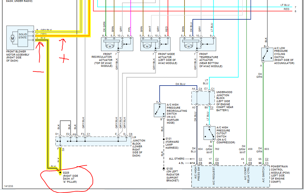

I have recently replaced my blower fan, and fan resistor twice
It all started when I bought the new climate control module and plugged it in but was immediately met with strong air coming from the car vents, even when turned off. So I unplugged and did some researching, and everyone said replace your blower fan resistor, so I did. But once I replace it, the fan wouldn't come back on, on the 1st speed level or 5th. So, I placed the fan thinking that was it, still nothing.
Just trying to see where do I go from here?

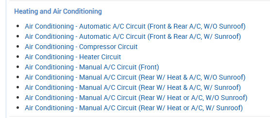

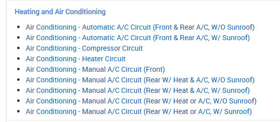

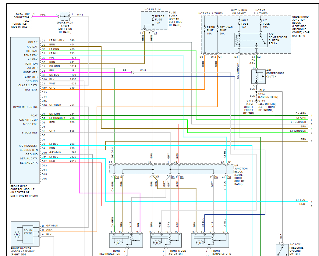

Does it even work on high now? Do me a favor. Read through the list I attached below and let me know which one you have. We need to start checking the wiring to see if there is a possible open circuit. I just need to make sure I am looking at the correct schematic.

Hey Joe,
I have the Air Conditioning - Automatic A/C Circuit (Front and Rear A/C, W/O Sunroof), the very first one.
It doesn't work on any setting at all.

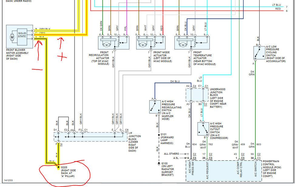

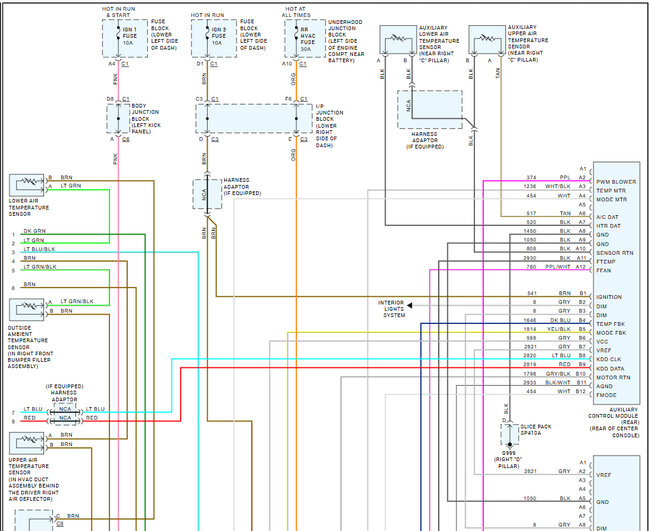

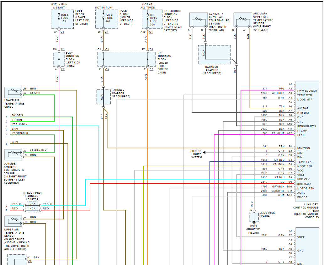

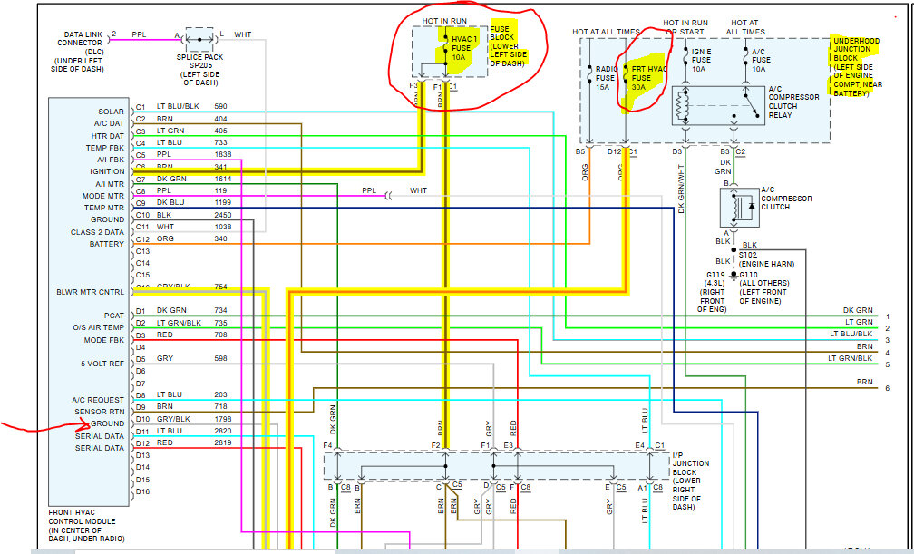

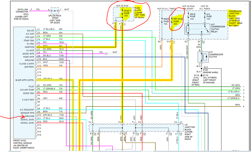

Okay, I attached the schematic for the front circuit below. We need to see where power is being lost. Start with the two fuses I highlighted and circled. Confirm there is power to and from them.
If they are good, go to the control module. Locate the brown wire and see if there is power with the key in the run position.
If there is power, go to the blower motor. Confirm continuity to ground on the black wire. Next, check the orange wire for battery voltage. It should be present regardless of the key's position.
See pics below. Note: That was from one page. I had to cut it in half to make it readable for you.

I notice that the dark green and grey wire was cut, most likely cause the blower motor was just running and the previous owner didn't know what was wrong, so he instead cut them to shut off the blower motor, I currently have them wired back up and that when I noticed the blower just blowing none stop.
I checked all voltage and ohms, everything reading right all the way down to the resistor but nothing from resistor to blower motor.

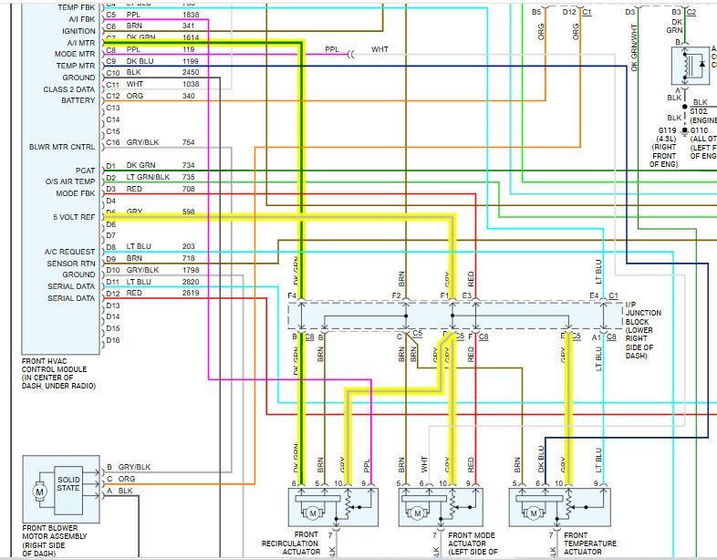

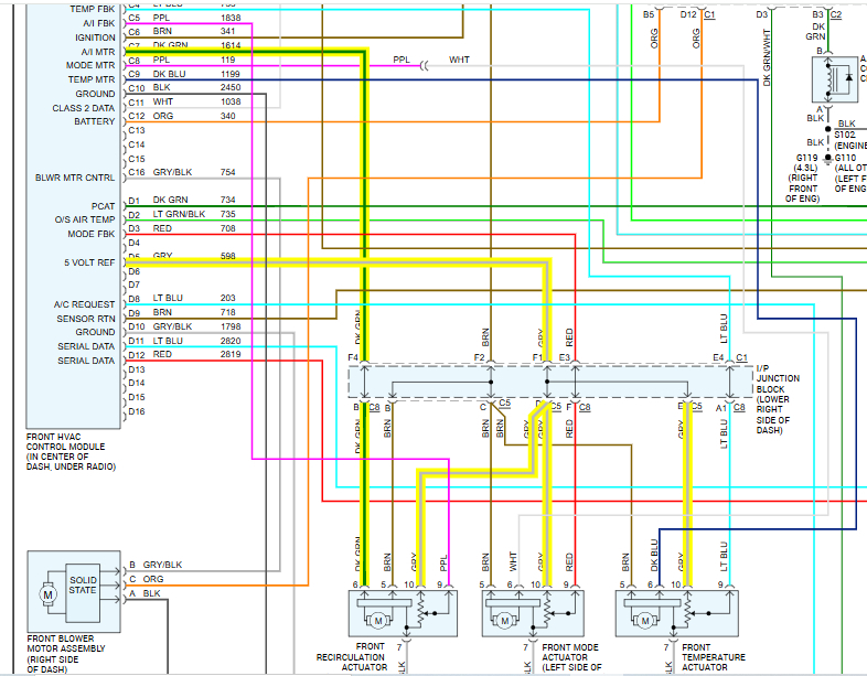

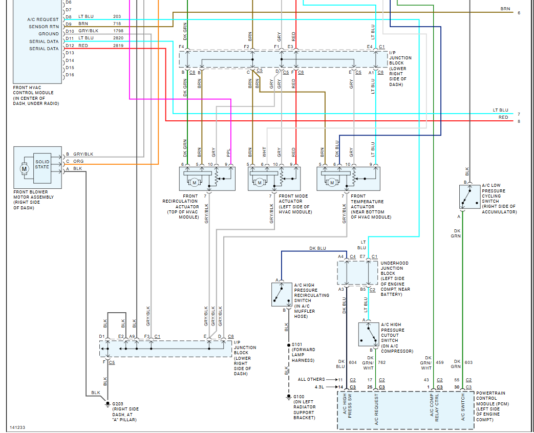

The gray and the dk gr and the gray wires are specific to the HVAC control modules. For example, the gray wire sends a 5v signal to the mode door, blend door, and recirculation door actuators. See pic below.
How many wires do you have on the resistor? Is there three or two? To check the motor, you simply need to run power and ground to the motor.
See pic below.

Three wires running to resistor, two come from resistor.
Wires to resistor read 14.2v, no read from resistor to fan when control panel is on.

It appears the gray wire with a black tracer is the power/control wire. Are you getting power from that wire? I'm starting to question if the new resistor is bad. If you have power to it and the black wire has a ground, you should be getting power to the motor. Also, just to confirm, was the engine running when you saw 14.2V?

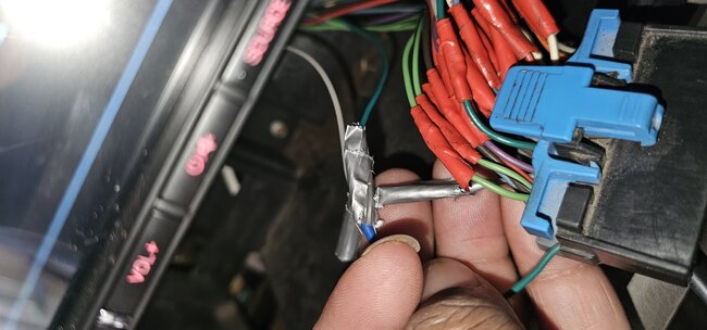

I see in the images the wiring to the HVAC controller seems to be repaired, this can be the problem, I would use this guide to check the continuity of each wire and make sure none are shorted to ground.
This guide can help:
Also check the ground and power to the HVAC controller. Check out the images (below). Let us know how it goes.

Okay, thanks for all the help. Found figured out the grey/black ground and Blower Motor controller was swapped, not allowing the blower motor to get a signal and the control module to get(D10).
Feb 4, 2025 at 3:13 AM
  • 55,224 POSTS
Yep, that will do it, nice find/repair. Use 2CarPros anytime, we are here to help. Please tell a friend.
