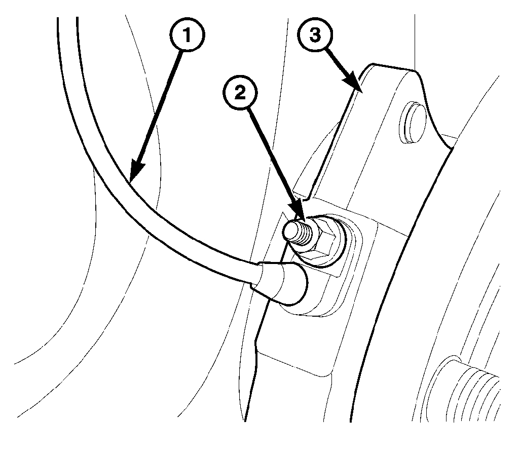

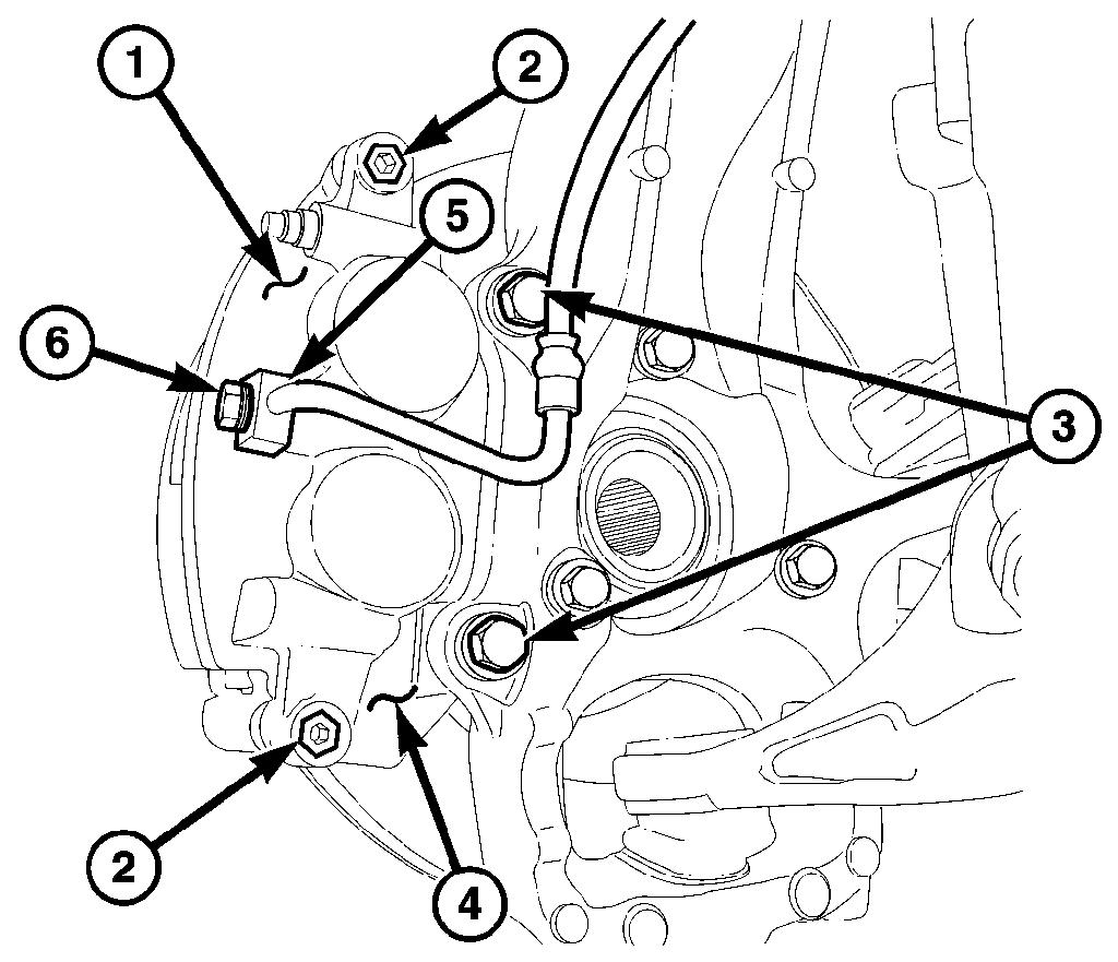

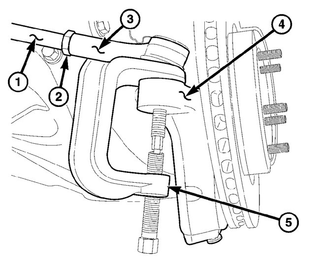

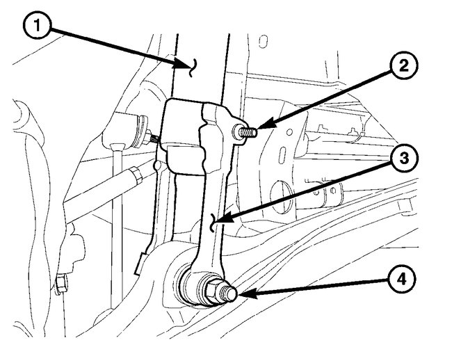

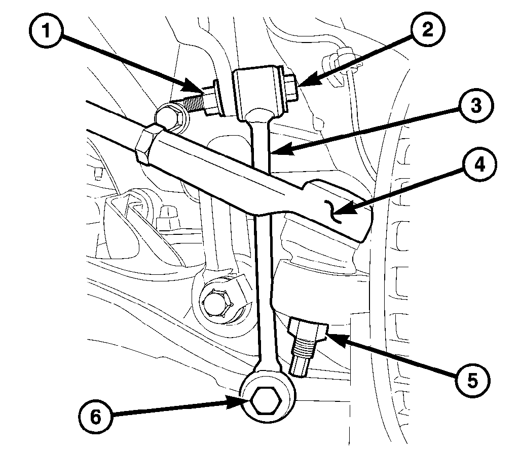

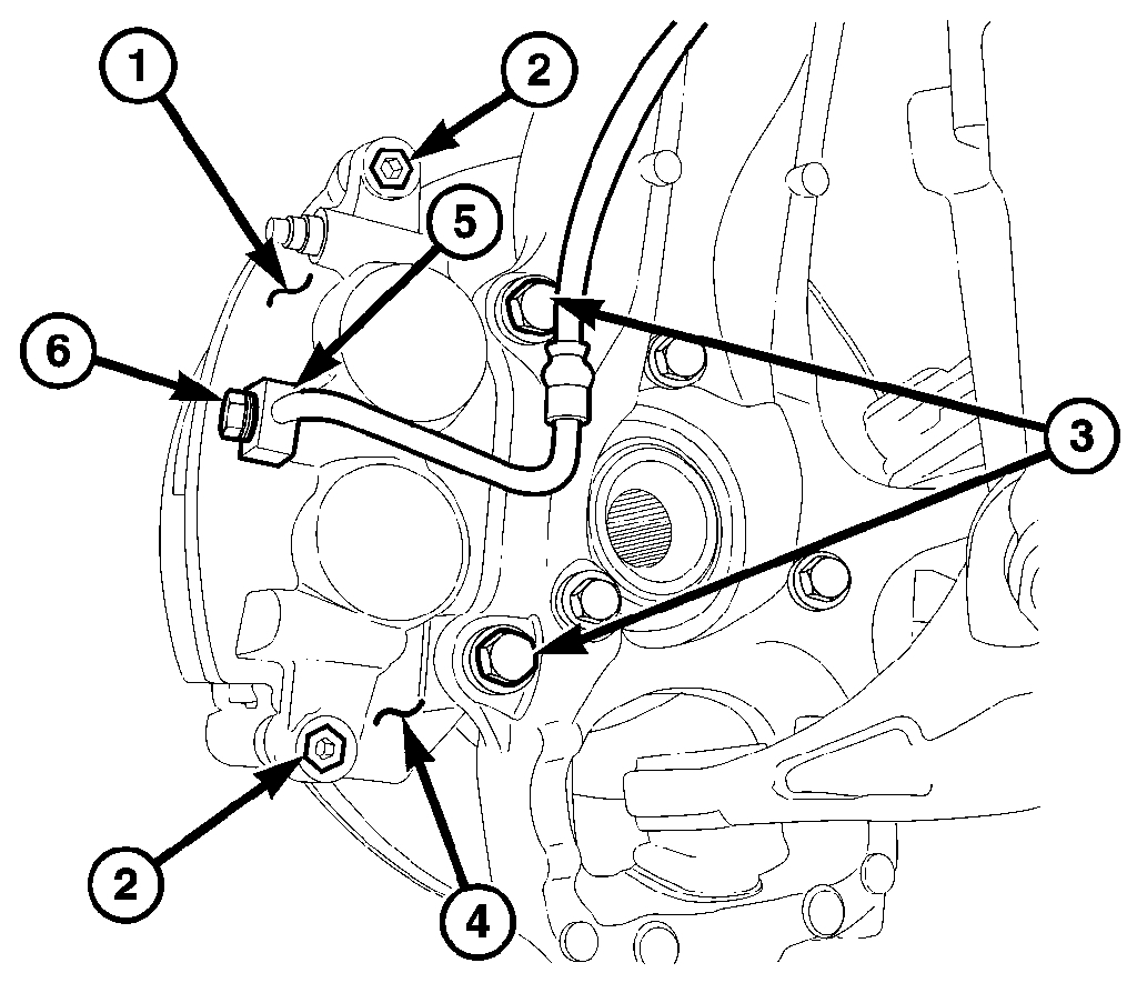

If you confirm that it is the problem, here are the directions specific to your vehicle for replacement. All attached pictures correlate with these directions.

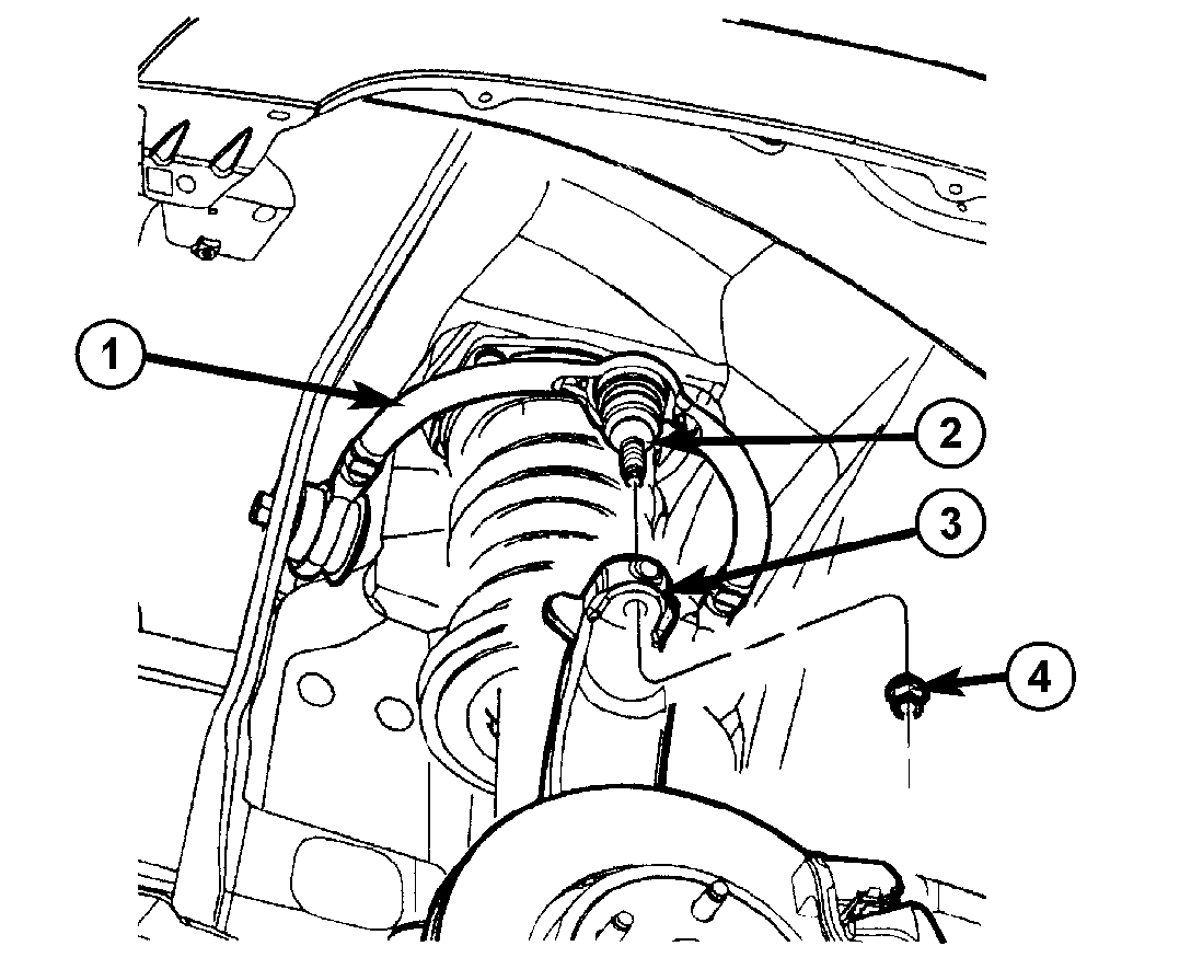

1. With vehicle in neutral, position vehicle on hoist.
2. Remove half shaft hub/bearing nut.

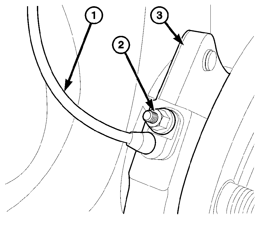

3. Remove wheel speed sensor (1) from hub/bearing (3).
4. Remove brake calipers bolts (2) and remove calipers (1) from caliper adapters (4).

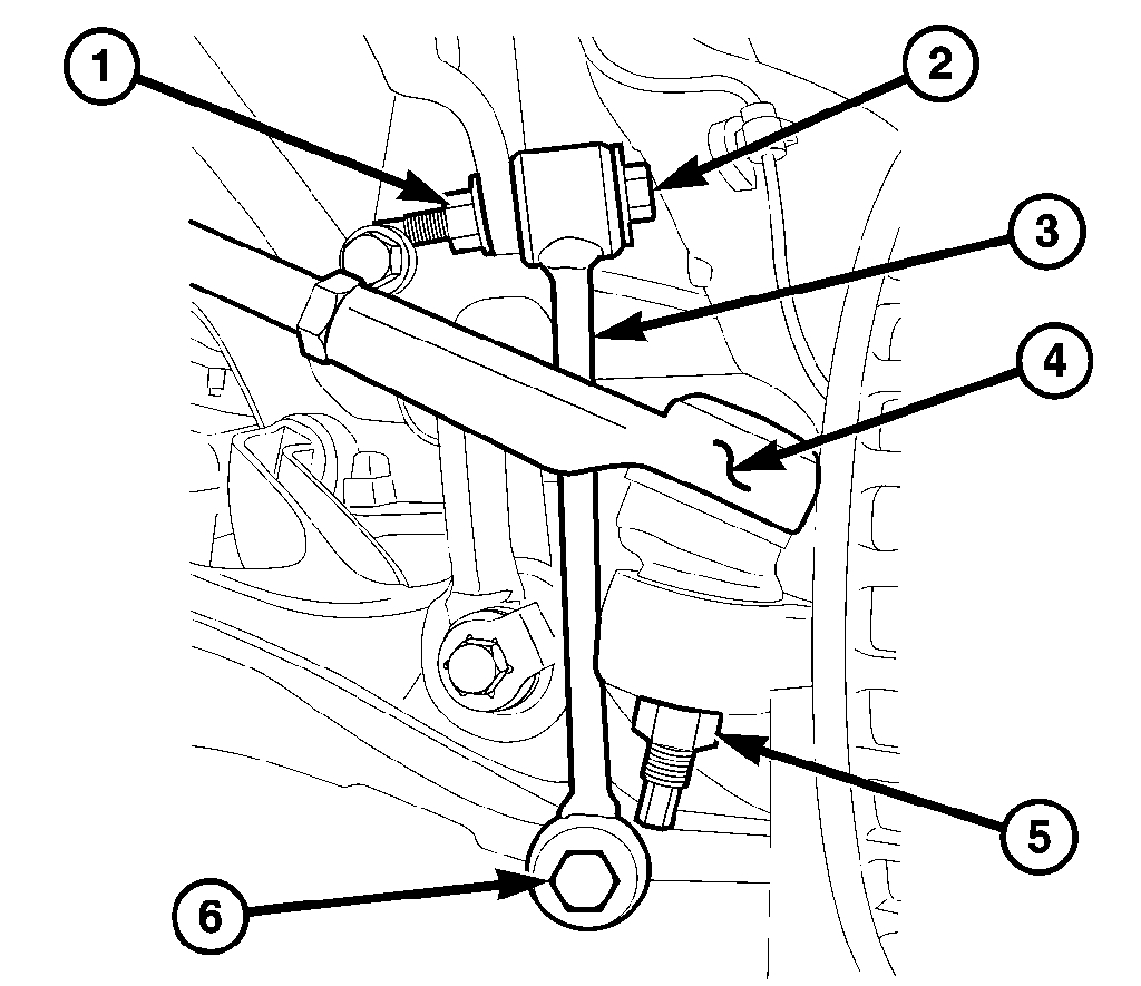

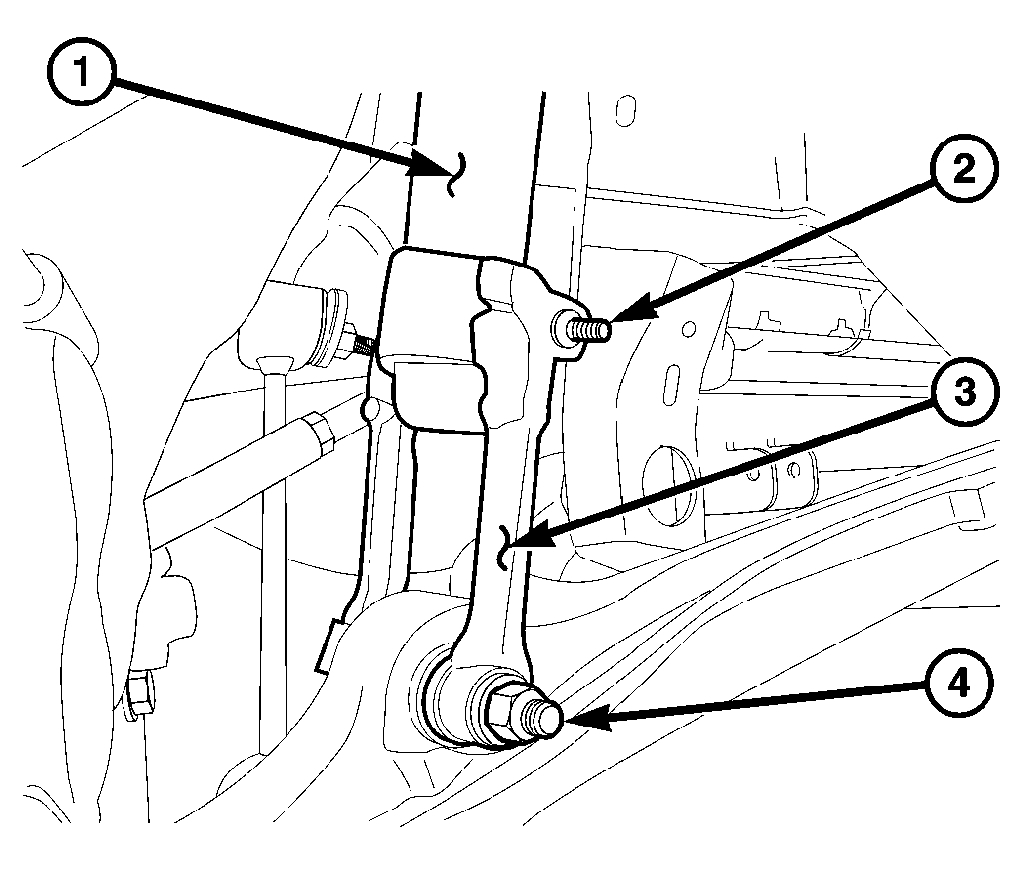

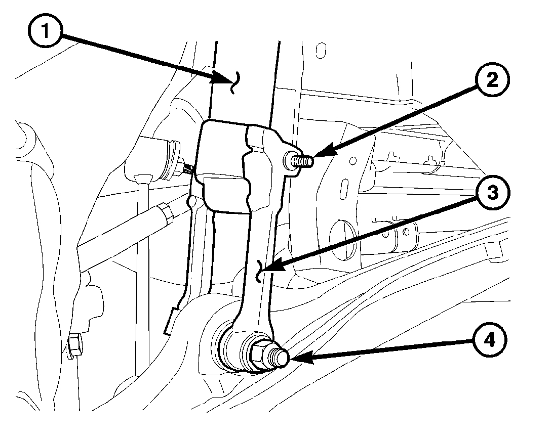

5. Remove lower stabilizer link (3) bolt (6) from control arm.
6. Remove outer tie rod end nuts and separate tie rods (3) from knuckles (4) with Remover 8677 (5).
7. Remove upper ball joint nuts (4) and separate ball joints (2) from knuckles (3) with Remover 8677.
8. Remove shock clevis (3) bolt and nut (4) from lower control arm
9. Lean the knuckle out and push half shaft out of the hub/bearing.
10. Pry half shafts from axle/axle tube with pry bar.

5. Install stabilizer link (3) on lower control arm and tighten to specifications.
6. Install caliper (1) on caliper adapter (3) and tighten to specifications.
7. Install wheel speed sensor (1) on the hub/bearing (3).
