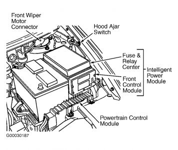

2001 Chrysler Town and Country Van, 132K miles, 3.6, Which fuse controls the rear wiper? The schematic on the fuse box by the battery does not list rear wiper.

Fuse 11 20 amps...Under the hood in the intelligent power module.
https://images.2carpros.com/forum/automotive_pictures/62217_TC_1.jpg
