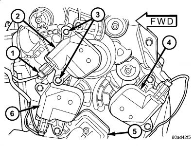

I Have a infrared 3 zone auto temp. Control heater that only blows air from panel vents even though it shows floor or windshield

Suspect a bad mode door actuator
Have to check HVAC for codes to conform
1 - WIRE HARNESS CONNECTOR
2 - MODE DOOR ACTUATOR
3 - SCREW (2)
4 - DRIVER BLEND DOOR ACTUATOR (DUAL-ZONE)
5 - HEATER CORE
6 - BLEND DOOR ACTUATOR (SINGLE ZONE) OR PASSENGER BLEND DOOR ACTUATOR (DUAL-ZONE

Select control switch may be bad! Greg
