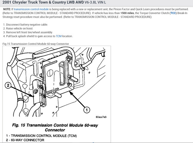

The TCM go out all the time in these becasue they place them near water I would remove the connector and clean it from corrosion which usually fixes it here is the location in the diagrams below. Check out the diagrams (Below). Please let us know what you find.

BMRFIXIT
  • 19,053 POSTS
Dtc p0700: internal trans controller
Note:for circuit, connector and terminal identification and/or component location, see connector identification and/or wiring diagrams .
Circuit description
Dtcs will set if an internal tcm malfunction occurs.
Possible cause
Internal tcm failure.
Diagnostic procedure
Note:ensure pre-diagnostic check has been performed before proceeding with following procedure.
Record all dtcs and one trip failures. Using scan tool, erase dtcs.
Turn ignition from off to on, then start engine.
Apply brakes. Slowly move gearshift lever through each gear position. Check if dtc p0604, p0605 and/or p0700 has reset. If dtc p0604, p0605 and/or p0700 is present, replace tcm.
perform shift quality quick-learn procedure and pinion factor procedure under programming.
If dtc p0604, p0605 and/or p0700 is not present, go to next step.
Inspect the following for pushed out terminals or faulty connections and repair as necessary:
Engine ground connections
Tcm grounds
Tcm battery feed
Tcm fused ignition switch output circuit
Power feed to transmission control relay
If procedure in previous step fails to diagnose problem, erase dtcs using scan tool. Perform ver-1a: verification test . If transaxle is still not functioning correctly, replace tcm. See transmission control module under removal & installation. Perform shift quality quick-learn procedure and pinion factor procedure under programming. If transaxle is functioning correctly, test is complete.

MARK CRANE
P0700 code: My 2005 Town and Country wouldn't shift in hot weather after driving a while, so I went into the fuse box and replaced the EATX Safety Shut Down Relay for $20.00. Problem solved! Thanks, Occam's razor!
Aug 15, 2020 at 1:09 AM
I am sure that will help others in the future. Please come back if you have other issues and need help. Thanks for visiting 2CarPros.
Aug 15, 2020 at 1:31 AM
