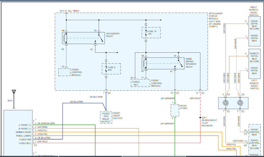

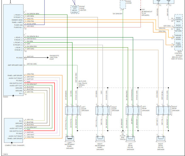

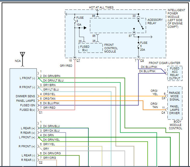

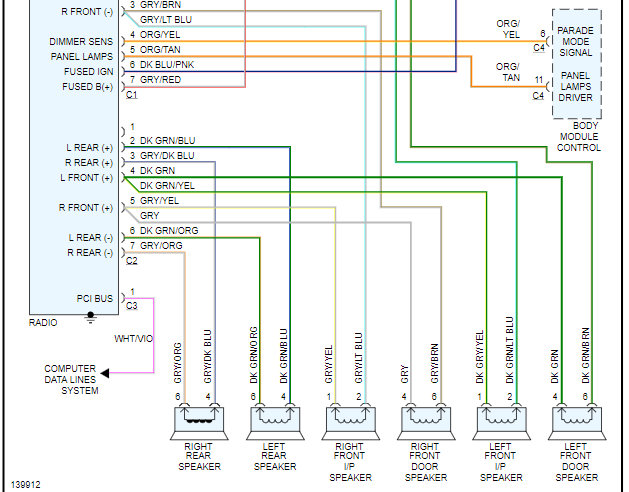

I've attached the audio system wiring diagrams below. Not sure which one of the 2 systems being either Base or Premium option are in your car so I've included both. I've cut the pictures in half so you can view larger. Hope this helps and thanks for using 2CarPros.
