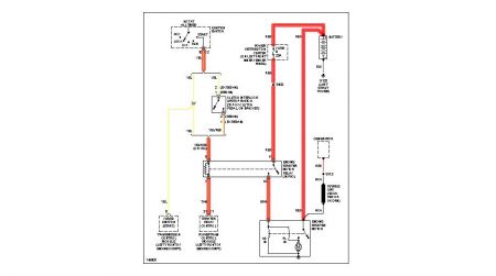

Car will make a clicking sound, but will not start. Also, where is the starter located?

Follow the battery positive cable it will take you there ( Starter )
Could be battery/connection, starter, starter relay, and ignition switch
Check fuse no. 8 20amp and clutch interlock switch
https://www.2carpros.com/forum/automotive_pictures/12900_starter_circuit_11.jpg
