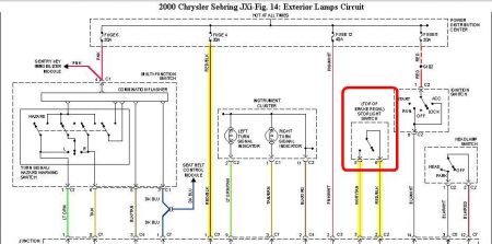

i just replaced the stop light fuse and tail light fuse because they were blown....i turned the lights on but the fuse burnt out right away....any ides why? i was thinking maybe replace the relay.....?....thanks for any help.....

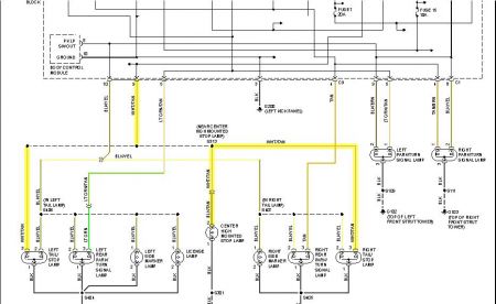

Most of the time, the frayed wiring happens by the taillights. Remove the carpeting to the taillights and inspect all the wires (both sides). You also want to check the light sockets for possible rust/corrosion or burned out wires.
Also tell me if you have the convertible or the coupe. Wiring diagrams are different between them.

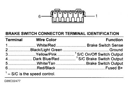

Before you check the the wiring by the taillight, just for the whirl of it, check your brake switch on top of your brake pedal. It may be defective. 1. Ensure ignition is off. Disconnect brake switch connector. Brake switch is located near top of brake pedal. 2. Turn ignition on with engine off. Using voltmeter, check voltage at terminal No. 1 (White/Red wire) on brake switch connector. If voltage is more than 9 volts, go to next step. If voltage is 9 volts or less, go to step 5 . 3. Ensure ignition is on with engine off. Connect jumper wire between terminals No. 1 (White/Red wire) and No. 2 (Black/Light Green wire) on brake switch connector while using scan tool to monitor brake switch status. If brake switch status does not change from PRESSED to RELEASED, go to next step. If brake switch status changes from PRESSED to RELEASED, replace or adjust brake switch. 4. Turn ignition off. Using ohmmeter, check resistance between ground and terminal No. 2 (Black/Light Green wire) on brake switch connector. If resistance is less than 5 ohms, replace PCM. PCM is located at driver's side front corner of engine compartment, just below air cleaner assembly. If resistance is 5 ohms or more, repair open ground circuit on Black/Light Green wire between brake switch and terminal No. 12 on Body Control Module (BCM) connector C1, as BCM controls ground circuit for brake switch. BCM connector C1 is a Black 14-pin connector. The BCM is located on rear of junction block at driver's side of instrument panel. See Fig. 49 .

Fig. 49: Locating BCM & Identifying Connectors
https://images.2carpros.com/forum/automotive_pictures/55316_00jxibrakeswitch_1.jpg
5. Ensure ignition is off and brake switch connector is still disconnected. Disconnect PCM connectors. PCM is located at driver's side front corner of engine compartment, just below air cleaner assembly. 6. Using ohmmeter, check resistance between terminal No. 1 (White/Red wire) on brake switch connector and terminal No. 62 (White/Red wire) on PCM connector C2. If resistance is less than 5 ohms, go to next step. If resistance is 5 ohms or more, repair open on White/Red wire between PCM and brake switch. 7. Ensure brake switch connector is still disconnected. Using ohmmeter, check resistance between ground and terminal No. 62 (White/Red wire) on PCM connector C2. If resistance is 5 ohms or more, go to next step. If resistance is less than 5 ohms, repair short to ground on White/Red wire between PCM and brake switch. 8. Inspect brake switch connector and PCM connectors for corroded, pushed out, miswired or damaged terminals. If terminals are not corroded, pushed out, miswired or damaged, replace PCM. If terminals are corroded, pushed out, miswired or damaged, repair connectors as necessary. If there is nothing wrong with the brake switch, then you need to find the electrical short in the circuit.
https://images.2carpros.com/forum/automotive_pictures/55316_00jxitail_2.jpg
https://images.2carpros.com/forum/automotive_pictures/55316_00jxitail_2_2.jpg

No. They are on two different circuits. If both fuses burned out as soon as you turn on the light, your electrical short will be near one of the taillight sockets. One of them must have a frayed contact point, connecting both circuit to ground.
Try this. Turn the light switch off. Remove all four bulbs out of the sockets. Replace the fuses. Install the bulbs one at a time. Once the first bulb is in, turn on the switch. Check current continuity. If bulb turns on and fuses are holding. Turn off and install the next bulb. Continue until you narrow down the problematic socket.
