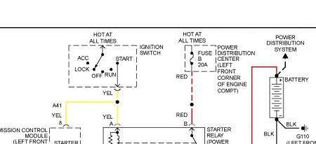

1994 Chrysler LHS 6 cyl Automatic
I am just getting a chance to restart as an entry level mechanic after being away from the profession for 15 years. I am starting with a shop that is new and very small and on a low budget. I was expecting them to have all of the repair manuals or preferably online access to the specs, etc... They don't and I'm hoping to get some advise on what might be the least expensive while offering important information/diagrams, etc...
Currently I am working on a 94 Chrysler LHS that won't turn over. I just barely touched this thing, but do hear a single click when turning the ignition to the start position. I am planning to check the starter first, but am probably not going to get such a lucky break. Fixing this car efficiently can make or break me for keeping this job.

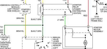

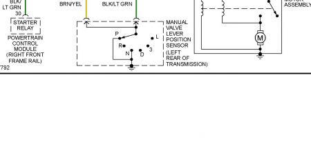

No crank at all/nothing/nada:
Could be the starter, starter relay, clutch switch/park and neutral switch and ignition switch assuming the battery and connections are good.

Good Luck and TY for using 2carpros
https://images.2carpros.com/forum/automotive_pictures/12900_s1_59.jpg
https://images.2carpros.com/forum/automotive_pictures/12900_s2_53.jpg
https://images.2carpros.com/forum/automotive_pictures/12900_s3_11.jpg
