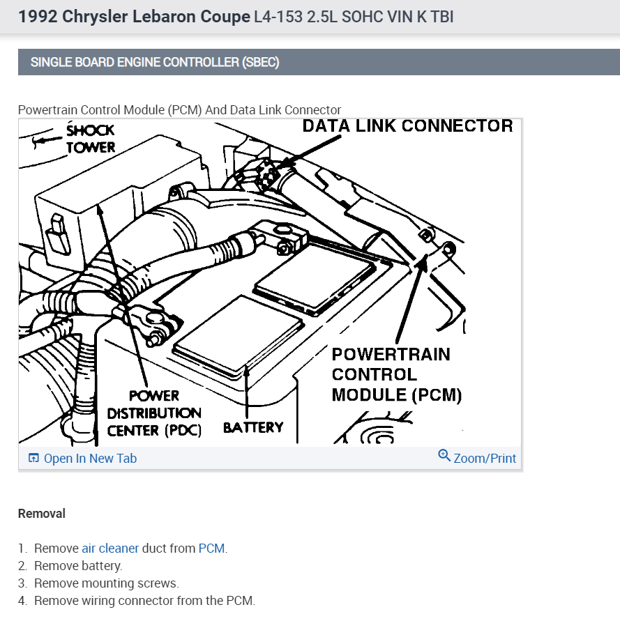

I recently bought a Lebaron and the battery won't charge. It has a new battery and a new alternator. we haven't gotten the alternator tested yet but plan on doing it soon. If the alternator isn't the problem, what else should we check?

Hi:
Have the alt checked and let me know what you find. If I recall correctly, the voltage regulator is not part of the alt but rather the computer. There could be a problem there.
let me know what you find out.

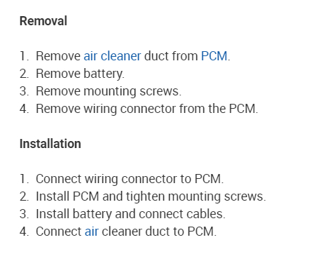

I believe the PCM replacement fixed it, which was a big problem with this car, you can get a rebuilt unit by searching Google or Ebay. Here is the location in the images below.
