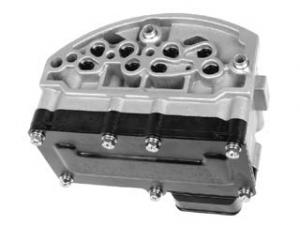

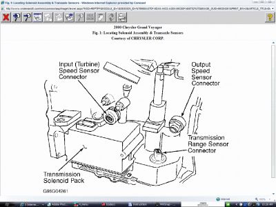

I have just found a Transmission leak coming from between the "I think is called" the control box that sets on top of the transmission the Trans houseing.
My questions is this repairable with a casket or changing the casket. With the fuild full the transmission sihts fine. If is repairable what type or price should I expect, or can I repair it.
Thanks.
Dec 1, 2007 at 1:22 PM
MERLIN2021
  • 17,250 POSTS
Is this the part that leaks? Solinoid Pack?
https://images.2carpros.com/forum/automotive_pictures/62217_SolPack_1.jpg
Could be cracked, but try parts store for a gasket.
https://images.2carpros.com/forum/automotive_pictures/62217_getimage_2.jpg
http://www.rockauto.com/catalog/raframecatalog.php Price 117.00
