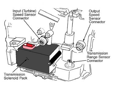

Do you have a check engine light on
check for codes
most common is the solenoid pack on the side of the engine or input output sensors
https://www.2carpros.com/forum/automotive_pictures/99387_caravan_tranny_3.jpg
