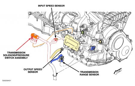

hi my 99 grand voyager speedo needle flicking back and fourth and not always changing up into high gear....read through variouos sites get hint that speed sensor could be to blame.....not sure though , if so how to replace please....

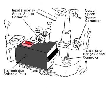

Take the speed sonsor out and make sure the little red cog is ok, sometime they wear on one side. The sensor is located in the gear box were the drivers drive shaft goes into the box.
Aug 22, 2008 at 8:40 AM
BMRFIXIT
  • 19,053 POSTS
Similar to this replace the two sensors input and out put
https://images.2carpros.com/forum/automotive_pictures/99387_caravan_tranny_15.jpg
https://images.2carpros.com/forum/automotive_pictures/99387_caravan_tranny_05_6.jpg

how hard is it to remove and replace? cheers
