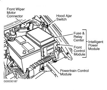

DOCFIXIT
  • 18,828 POSTS
https://images.2carpros.com/forum/automotive_pictures/198357_Graphic_221.jpg
well it copied to small on bottom left second up in verticle position
Oct 28, 2009 at 6:36 AM
JASONJ70
  • 13 POSTS
where is this fuses box located there are 2 of them. I could not see the diagram well enough too small.
is there somewhere we can see a bigger diagram?

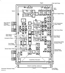

DOCFIXIT
  • 18,828 POSTS
https://images.2carpros.com/forum/automotive_pictures/198357_Graphic_222.jpg

JASONJ70
  • 13 POSTS
all the fuses in the fuse box are good. tested them with a test lite. could it be a relay?
