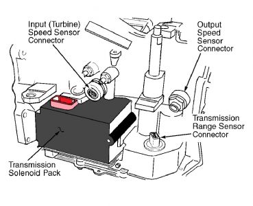

hi, brought grand voyager 99, seems ok except speedo needle seems to flick back and fourth randomley sometimes. Can u help please
Friday, August 22nd, 2008 AT 7:47 AM
BMRFIXIT
MECHANIC
19,053 POSTS
Try new speed sensor
I would replace them both input and output
