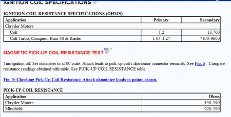

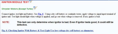

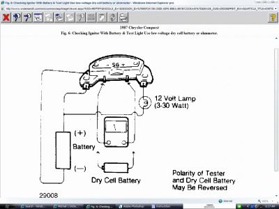

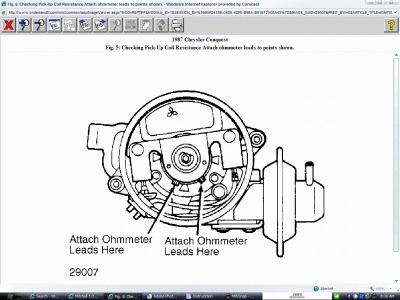

i have an 87 chrysler conquest and i cant get it to start, im getting fuel to the plugs but there is no spark, i have new plugs, new wires, new distributer cap and rotor button, new coil and battery. and all my fueses are good. what could be my problem. please help. ty

After replacing all those parts, only one thing left! Ignition module...Is there battery voltage at the coil?
