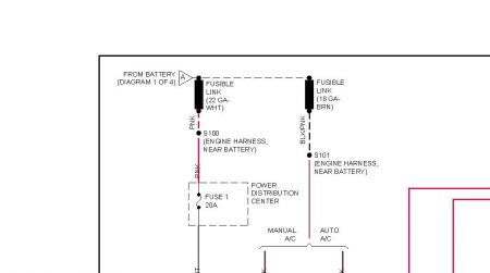

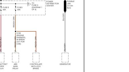

You have 2 fusible links coming from the battery a white 22ga. and a brown 18ga. also a black 12ga between the battery and alternator
https://images.2carpros.com/forum/automotive_pictures/12900_fuse_links_1.jpg
https://images.2carpros.com/forum/automotive_pictures/12900_fl_1.jpg

where at exactly are these fuseanle links. i followed the wire from the battery to the alternator and it goes into the ecm (i think its right beside the battery and has one plug wit pins plugged into a box) that also has no power to. could it be under the car? Or does it go into something?

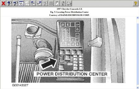

Check for power at fuse B 20amp in the power distribution center-do you have it ?

is that where all the relays are? what is the fuse for?
Dec 15, 2008 at 9:46 AM
  • 75,992 POSTS
Check the fuse B 20 amp in the power distribution center -this fuse if it doesn't have power it means a blown fusible link-Refer to the wiring diagram I gave you earlier-You have 3 fusible links the location is right there in the diagram

how far from the battery is the distribution center and what does it look like.

there is power going to the link thats about a foot from the battery. i had to take the battery out to get to it, so i ran mini cables from the terminal to the posi wires (where the white says fusible link on the wire) put the test light on the ground wire and it didn't light. however when i used the neg terminal for the test light i got a light. so is there a link for the neg?

Power distribution center
https://images.2carpros.com/forum/automotive_pictures/12900_pdc_2.jpg
so i ran mini cables from the terminal to the posi wires (where the white says fusible link on the wire) put the test light on the ground wire and it didn't light. however when i used the neg terminal for the test light i got a light. so is there a link for the neg? I'm getting confuse here is to what you doing-negative side don't have a fusible link

i got the picture of the power distribution center. i tried all those fuses and there is no power any where in there except the hazard

You need to find all the fusible links test it before and after it-You should have power before and after iif no power after the link -the link is open-

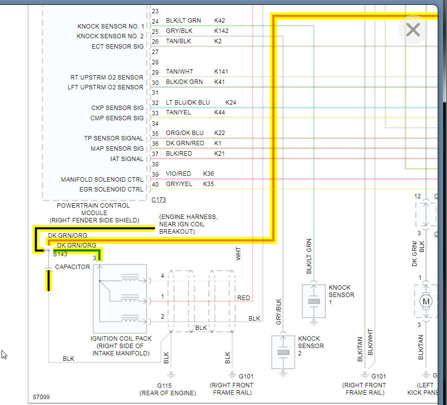

This does not appear to be a fusible link, it is just a splice. A fusible link is basically a fuse made out of wire. Normally it is used on larger gauge wiring where they put a small section (about 2 inches) of thinner wire with thicker insulation. So when there is too much current going through the circuit it will burn up this thin wire and create an open rather then carry that too much current and burn up the component they are attached too.
If you have more questions, I would suggest getting a new post started and we will work through it.
